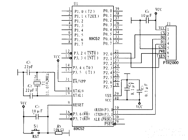

Clock circuit and reset circuit of the microcontroller: In the design of the clock circuit of the microcontroller, the crystal oscillator frequency is selected to be 11.059 2 MHz, the communication rate between the PC and the microcontroller is agreed to be 9 600 b/s, and the corresponding capacitor is selected to be connected to the clock pin of the microcontroller to form a clock loop. . In the reset circuit design, the reset pin and the corresponding capacitor and resistor are used to form the reset circuit. The principle circuit of the interface between the microcontroller and PTR2000 is shown in the figure.
MCU and PTR2000 interface circuit: AT89C52 MCU mainly completes data collection and processing, sends data to the PTR2000 module, and receives data transmitted by the PC through PTR2000. The PTR2000 module connected to the microcontroller mainly modulates the data to be transmitted by the microcontroller into a radio frequency signal, and then sends it to the PTR2000 module on the PC side. At the same time, it receives the radio frequency signal transmitted by the PTR2000 module on the PC side, and modulates it into a TTL signal that the microcontroller can recognize and sends it to Microcontroller. The RXD and TXD pins of the microcontroller are connected to the DO and DI pins of the PTR2000 respectively to realize serial data transmission; the three pins TXEN, CS, and PWR, which determine the working mode of the PTR2000 module, are respectively connected to P2 of the I/O control port of the microcontroller. 0~P2.2 are connected. When PTR2000 is working, its working mode is controlled in real time by the operation control program in the microcontroller.

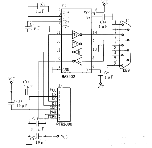

The interface circuit design first requires level conversion. The serial port of the PC supports the RS-232 standard, while the PTR2000 module supports the TTL level. The MAX232 device is selected for level conversion between the two. The interface circuit is shown in Figure 3. The PTR2000 module performs serial input and output, and the pins DI and DO are connected to the PC serial port through level conversion devices; the PTR2000's low-power control pins. PWR is connected to high level VCC, that is, PTR2000 is fixed to work in the normal working state; channel selection pin CS is connected to GND low level, that is, fixed communication channel 1 is used, fixed to work at 433.92 MHz; the RTS signal of the PC serial port controls the TXEN pin , to determine when the PTR2000 module is in the receiving and transmitting state. The transmission rate of the PC and serial port is set to 9 600 b/s, which is consistent with the microcontroller.
