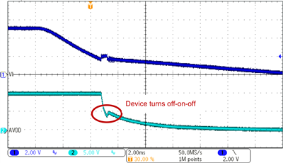

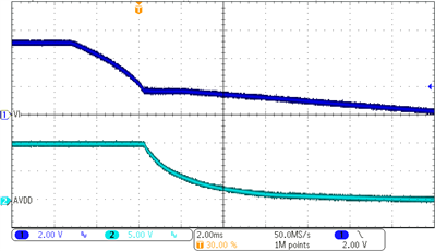

Note that the rising and falling UVLO thresholds are different. This is because a well-designed UVLO function incorporates hysteresis. Why? Well, not only do comparator circuits typically benefit from hysteresis, but power devices, by their very nature, tend to draw significant current from the upstream power supply. Because there's always some resistance between the power supply and the device it's powering, the voltage seen by the UVLO comparator is always slightly lower than the voltage of the upstream supply (see Figure 2). When the voltage reaches the UVLO threshold, the device turns off, and the current flowing into it instantly drops to almost zero, causing the voltage seen by the UVLO comparator to immediately increase (because the voltage drop across the input resistance suddenly disappears when the input current decreases).
Figure 2: Equivalent circuit of a typical power device with UVLO function
If the hysteresis voltage is less than I × R, under certain conditions, the power management IC (PMIC) can turn on and off multiple times before finally shutting down permanently. At best, this can look unsightly. At worst, it can cause system-level problems. Figures 3 and 4 are scope diagrams illustrating this phenomenon.
Figure 3: Low input resistance results in normal power-off behavior
Figure 4: High input resistance causes irregular power-off behavior

· Remember that the input current multiplied by the input resistance should be less than the UVLO hysteresis to achieve clean power-up and power-down behavior.
