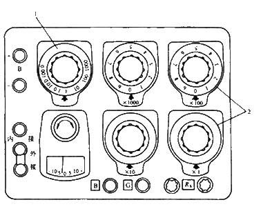

The single-arm bridge is also called the Wheatstone bridge. When the mid-value resistance needs to be accurately measured, the single-arm bridge is often used for measurement. Its principle is shown in Figure 1. In the figure, Rx is the measured resistance, G is the galvanometer, and Rl, R2, and R3 are adjustable resistors. When the relationship R1 R3 = R2 Rx is satisfied, the circuit reaches equilibrium. At this time, the current passing through the galvanometer is zero (the pointer does not move). We call R1/R2 the proportional arm and R3 the comparison arm. Figure 2 is a panel diagram of the QJ23 DC single-arm bridge. When measuring, you can select the appropriate comparison arm value multiplied by the multiple of the proportional arm based on a rough estimate of the measured resistance.

5) After the bridge circuit is connected, if the galvanometer pointer deflects in the "+" direction, the resistance of the comparison arm should be increased; conversely, if the pointer deflects in the "-" direction, the resistance of the comparison arm should be reduced. Repeatedly adjust the comparison arm resistance until the pointer points to zero. Read the resistance value on the dial and multiply it by the magnification to get the measured resistance value.
Figure 2 DC single-arm bridge panel Figure
1 - magnification knob 2 - scale arm reading plate
6) After the bridge is used, the lock of the galvanometer should be locked immediately to avoid damaging the suspension wire during the moving process. 7) Low battery voltage will affect the sensitivity of the bridge, so if the battery voltage is found to be low, it should be replaced in time. When using an external power supply, you must pay attention to the polarity and do not let the voltage exceed the specified value, otherwise the bridge arm resistor may be burned out.
