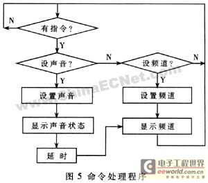

3.3 Broadcast Terminal Software
After the broadcast terminal is powered on and reset, it enters a state of waiting to receive control commands. The command processing program flowchart is shown in Figure 5.
