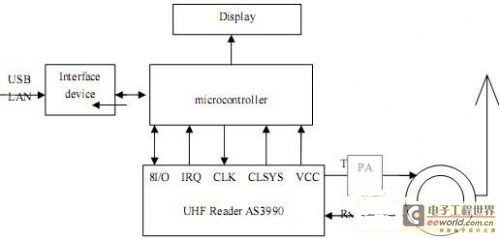

3.2.1 RF module design: The RF module uses AS3990HUF as the core chip, and an external power amplifier is used to ensure that its power meets the necessary conditions for long-distance reading and writing transmission. The RF part is the front end of the reader/writer. When the control circuit sends a transceiver instruction, the RF circuit will complete the carrier modulation of the instruction and send the carrier to the RF tag, as well as demodulate the returned received signal and transmit the processed baseband signal to the control circuit.
3.2.2 Digital module design: The digital part is designed with the MSP430 series microcontroller as the core chip. The main functions of the digital part include realizing the waveform encoding of the command sent to the tag, decoding of the return signal, read and write command flow control, error control, sending control commands and receiving data, realizing the interface protocol between the host computer application, collecting and processing input and output signals, realizing the relevant algorithms of the reader function, controlling the working mode of the RF circuit, etc. (including the control of output power, tag reading mode, carrier frequency, etc.)

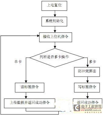

The hardware driver software is written in C language, mainly using modular programming ideas. The system main program is a complete RFID reader system, which is used to control the working status and working mode of each module of the hardware circuit and coordinate the work of the entire reader reading and writing process. The main program of this reader hardware driver can be mainly divided into the following parts: serial communication program, tag reading and writing program, anti-collision program, data processing program, etc. Figure 2 is the main program flow chart for reading and writing electronic tags:
pictext"> Figure 2 Flowchart of the main program for reading and writing electronic tags
