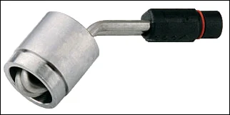

Winter can be very cold in Nordic countries; it is fairly normal to have temperatures below -20°C. Not everyone has a warm garage for their vehicles, so many people use an engine preheater, like the one shown in Figure 1.
The engine preheater is mounted into the vehicle (Figure 2) and typically heats the water inside the engine.
