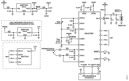

Figure 1. ADuC7060/ADuC7061 with thermocouple interface used as temperature monitor controller (schematic diagram, all connections not shown)

Used in this application: The following features of the ADuC7060 / ADuC7061 :
  • 24-bit Σ-Δ main ADC with built-in PGA. The gain of the PGA is set to 32 in the software of this application. The main ADC continuously switches between thermocouple signal sampling and RTD voltage signal sampling.
  • If an RTD is used to measure the cold junction temperature, a programmable excitation current source drives a controlled current through the RTD. The dual-channel current source is configurable in 200µA steps from 0µA to 2µA. This example uses a 200µA setting to minimize errors caused by RTD self-heating effects.
  • If the ADT7311 is used to measure the cold junction temperature, the SPI interface will be used in master mode to connect the ADT7311 slave.
  • Built-in 1.2 V reference for the ADC in the ADuC7060/ADuC7061. The internal reference voltage source is highly accurate and suitable for measuring thermocouple voltages.
  • External voltage reference source for the ADC in the ADuC7060/ADuC7061. To measure RTD resistance, we use a ratiometric setup with an external reference resistor (RREF) connected to the external VREF+ and VREF− pins.
  • The AD8628  single-supply op amp is used to buffer RREF to the high-impedance reference voltage of the ADC.
  • The OP193 is an alternative model to replace the AD8628.
  • DAC used to set the thermocouple common-mode voltage to 850 mV above ground.
  • ARM7TDMI® core. The powerful 16/32-bit ARM7 core integrates 32 kB of flash and SRAM memory to run user code, configure and control the ADC, handle ADC conversions through the RTD, and control communications over the SPI interface.
  • Timer 1 and the digital output pin are used to generate the SENT output signal.
  • Optional PESDLIN protection diode for suppression of ESD, electrical fast transients (EFT) and surge transients (up to 23kV).
  • An EMC filter is provided at the SENT output as recommended in section 6.3.1 of the SAE J2716 standard (SENT protocol).
  • Two external switches are used to force the device into flash boot mode. By holding S1 low while toggling S2, the ADuC7060/ADuC7061 will enter boot mode instead of normal user mode. In boot mode, the internal flash memory can be reprogrammed via the UART interface.
Thermocouples and RTDs produce very small signals, so a PGA is required to amplify these signals. The auxiliary ADC of the ADuC7060/ADuC7061 does not contain a PGA, so both are connected to the main ADC, and switching between the two is done through software.
The thermocouple used in this application is a T-type (copperconstantan) with a temperature range of −200°C to +350°C and a sensitivity of approximately 40 μV/°C, which means that the ADC operates in bipolar mode and 32x PGA gain setting can cover the entire temperature range of the thermocouple.
RTD is used for cold junction compensation. This circuit uses a 100Ω platinum RTD model number Enercorp PCS 1.1503.1. It comes in a 0805 surface mount package and has a temperature change rate of 0.385Ω/°C.
Note that the reference resistor RREF should be a precision 5.6 kΩ (±0.1%) resistor.

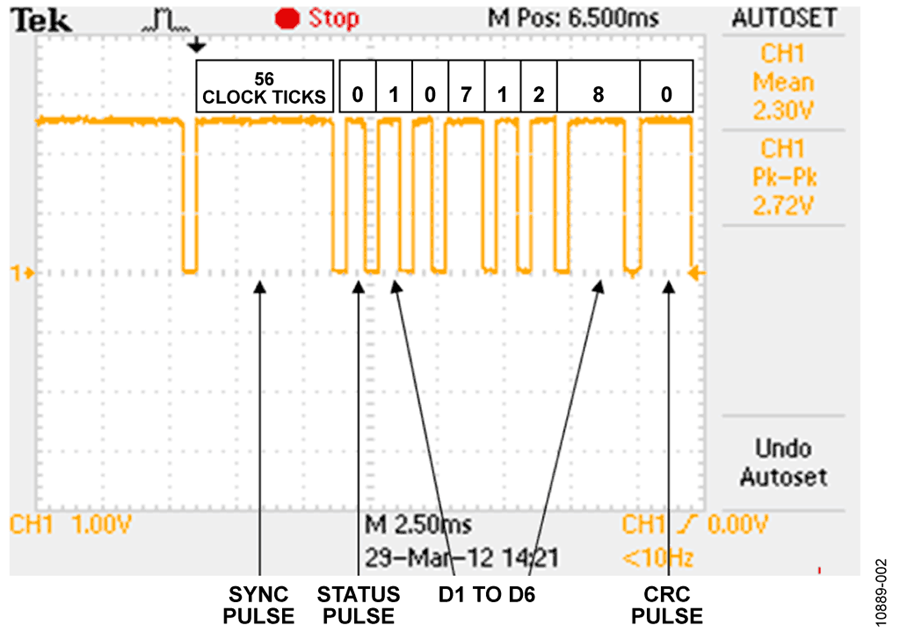

Figure 2 shows an example of a data packet.
Figure 2. Example SENT packet measured at P0.4 pin
The circuit must be built on a multilayer printed circuit board (PCB) with a large area ground plane. For optimal performance, proper layout, grounding, and decoupling techniques must be used (see Tutorial MT-031 "Grounding Data Converters and Solving the Mysteries of AGND and DGND" , Tutorial MT-101 "Decoupling Techniques" and ADuC7060/ADuC7061 evaluation board layout).
Code description
Timer 1 is used to control the SENT output pin P0.4. After the temperature result is calculated based on the ADC result of the thermocouple and the cold junction temperature, the SENT packet structure SENT_PACKET will be updated and timer 1 will be started. The domains of this structure will be output one by one on the P0.4 pin, as shown in Figure 2. The first level of the data packet is the synchronization sequence. The host determines the clock period based on this pulse and uses it to determine subsequent nibble values.

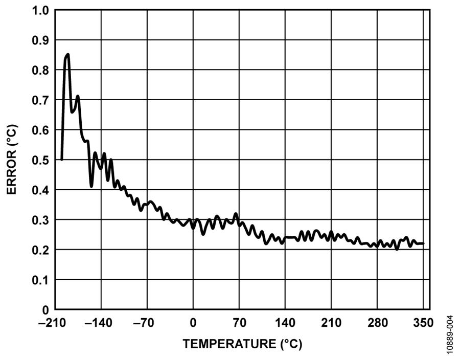

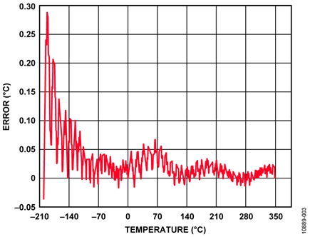

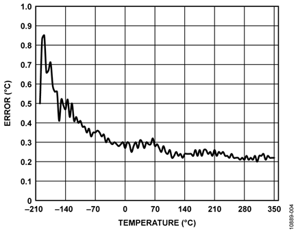

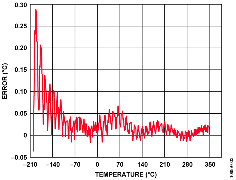

Finally, a piecewise linear scheme is used to calculate the final temperature value. The corresponding temperatures for a fixed number of voltages are stored in an array, and the values ​​between them are calculated using linear interpolation of adjacent points. Figure 3 shows the algorithm error when using ideal thermocouple voltages. Figure 4 shows the error obtained when measuring 52 thermocouple voltages over the entire thermocouple operating range using the ADC0 pin on the ADuC7060/ADuC7061. The worst-case total error is less than 1°C.
Figure 3. Error calculated using piecewise linear approximation using 52 calibration points and ideal measurements.
Figure 4. Error calculated using piecewise linear approximation using 52 calibration points measured at the ADC0 pin of the ADuC7060/ADuC7061
