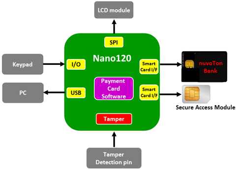

The Nano120 series used in this solution has passed EMV 2000 and China PBOC3.0 of Level 1 contact certification. It is used in USB transfer payment card readers and has ISO7816-3x3 smart card interface, anti-tamper detection pins, and anti-theft copy lock code bit functions. , 96-bit UID chip unique code, 128-bit UCID customer unique code, strong anti-interference ability (8kV ESD, EFT 4kV) and other features. The Nano120 series provides high-performance, low-cost, ultra-low power consumption 32-bit ARM® Cortex™-M0 core, running speed up to 42 MHz, built-in 32-bit hardware multiplier, low operating voltage 1.8V ~ 3.6V, ultra-low power operation mode (<200uA/MHz), power-down mode (real-time clock, memory data storage <2.5uA), deep power-down mode (memory data storage <1uA), flash memory up to 128kB and memory memory up to 16kB, highly integrated RTC, The 12-bit ADC conversion rate is up to 2Msps, built-in 12MHz RC oscillator, and USB2.0 to reduce system BOM cost. Rich peripheral interfaces I²Cx2, SPIx3, UARTx5, ISO7816-3x3 smart card interface, anti-tamper detection pin, anti-theft copy lock code bit function, 96-bit UID chip unique code, 128-bit UCID customer unique code, strong anti-interference ability (8kV ESD, EFT 4kV).
Blockdiagram
