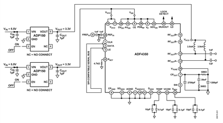

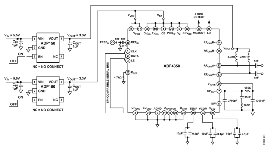

The circuit shown in Figure 1 uses a fully integrated fractional-N PLL and VCO ADF4350 , which can generate frequencies in the range of 137.5 MHz to 4400 MHz. The ADF4350 uses an ultra-low noise 3.3 V The ADP150 regulator is powered for optimal LO phase noise performance.
Figure 1. Regulator ADP150 connected to ADF4350 (schematic diagram, all connections and decoupling not shown)

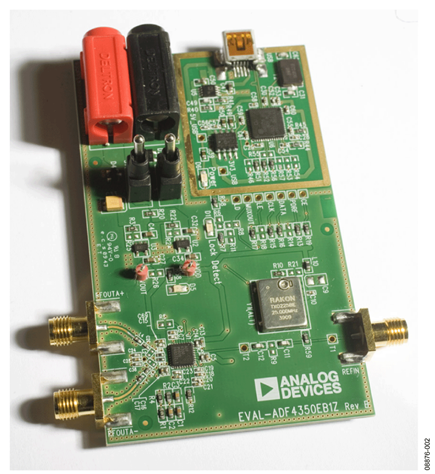

Figure 2 is a photo of the evaluation board, which utilizes the ADP150 LDO to power the ADF4350. The ADP150 represents the industry's lowest noise, smallest package, and lowest cost LDO, available in a 4-pin, 0.8 mm x 0.8 mm, 0.4 mm pitch WLCSP package or a convenient 5-pin TSOT package. Therefore, adding the ADP150 to the design has minimal impact on system cost and board area, but can significantly improve phase noise performance.
Figure 2. Evaluation board EVAL-ADF4350EB1Z version B using low-noise regulator ADP150

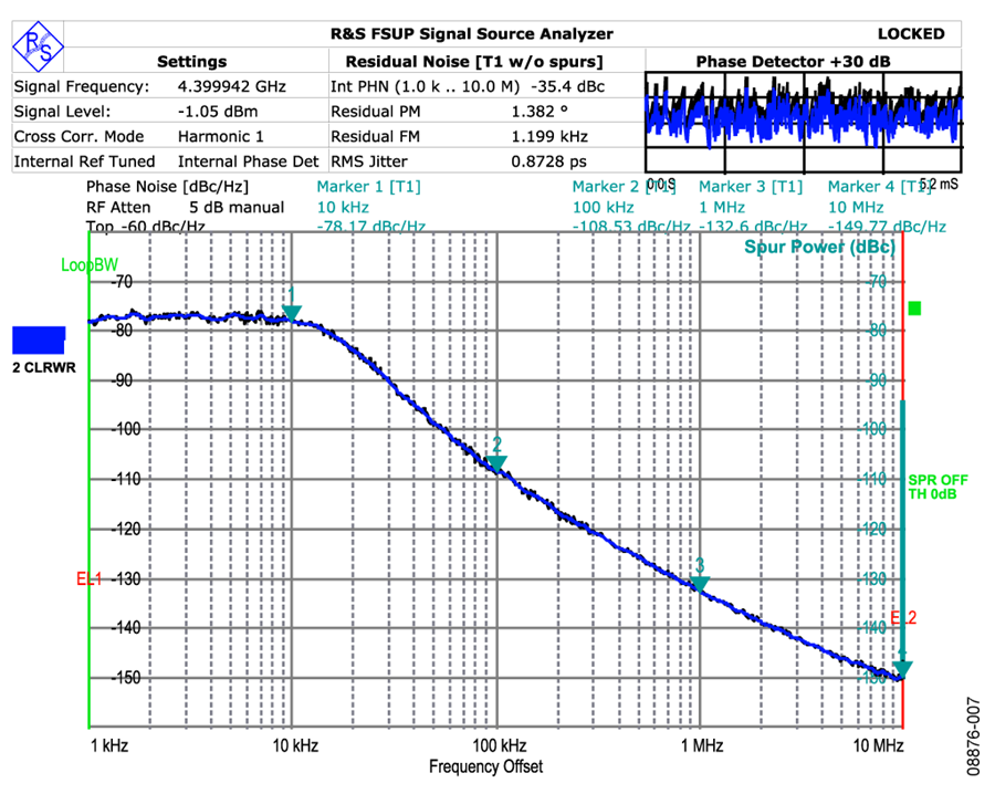

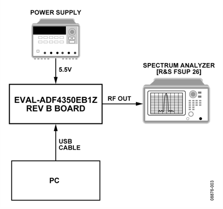

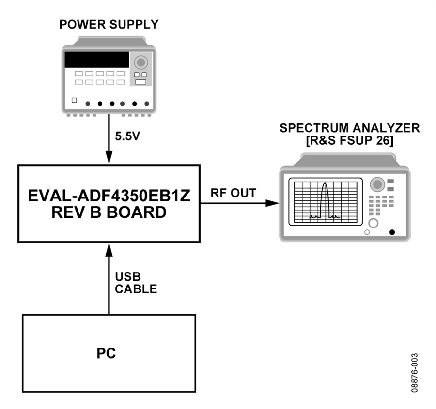

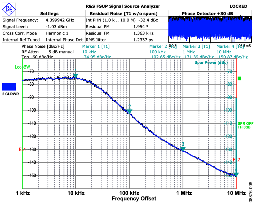

Experiments have shown that pushing reaches a maximum at the VCO output frequency of 4.4 GHz, so we compared VCO performance using different regulators at this frequency. The ADF4350 version A evaluation board uses the ADP3334 LDO regulator. The integrated rms noise of this regulator is 27 μV (integrated from 10 Hz to 100 kHz). In comparison, the ADP150 used in EVAL-ADF4350EB1Z version B only has 9 μV. To measure the impact of power supply noise, a more in-depth look at the VCO phase noise was performed using a narrow PLL loop bandwidth (10 kHz). Figure 3 is a schematic diagram of this setup.
Figure 3. ADF4350 measurement setup

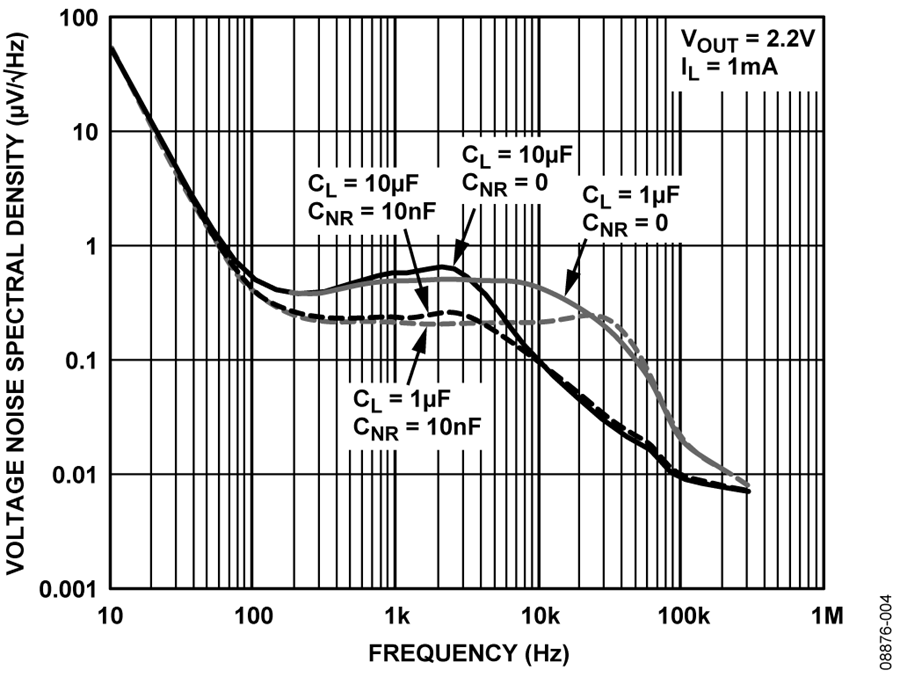

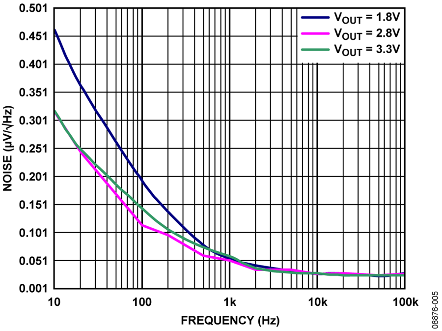

Figure 4 shows that the noise spectral density of the ADP3334 regulator is 25 nV/√Hz at 100 kHz offset. The ADP150 is 100 nV/√Hz (Figure 5).
Figure 4. ADP3334 output noise spectrum

Figure 5. ADP150 output noise spectrum

VCO noise measurements at 100 kHz offset
(dBc/Hz)
-102.6 -108.5
Figure 6. Phase noise of ADF4350 at 4.4 GHz with ADP3334 regulator.
Figure 7. ADF4350 phase noise at 4.4 GHz with ADP150 regulator
Integrated phase noise also improved from 1.95°rms to 1.4°rms. The measured results correlate very well with the calculated results and clearly demonstrate the benefits of using the ADP150 with the ADF4350.
