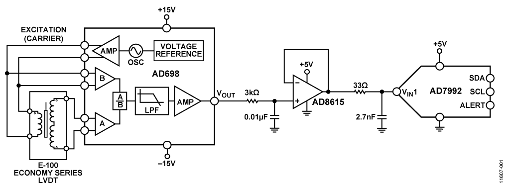

Figure 1. Universal LVDT signal conditioning circuit (schematic diagram: all connections and decoupling not shown)

For this circuit, Measurement Specialties™, Inc.'s E-100 economical LVDT sensor series is used in conjunction with the AD698. The E-Series has a linearity of ±0.5% over the entire range, making it suitable for most applications at moderate operating temperatures.
AD698 is a complete LVDT signal conditioning subsystem. It converts LVDT sensor mechanical position into unipolar DC voltage with high accuracy and repeatability. All circuit functions are integrated on-chip. By simply adding a few external passive components to set the frequency and gain, the AD698 can convert the raw LVDT secondary output into a proportional DC signal.
AD698 has a built-in low-distortion sine wave oscillator to drive the LVDT primary side. The sine wave frequency is determined by a single capacitor, with a frequency range of 20 Hz to 20 kHz and an amplitude range of 2 V RMS to 24 V RMS.
The LVDT secondary output consists of two sine waves and is used to directly drive the AD698. The AD698 decodes an LVDT by simultaneously demodulating the amplitude modulated input (secondary, A) and a fixed input reference voltage (primary, summed secondary, or fixed input, B). A common problem with previous solutions is that any drift in the amplitude of the driving oscillator leads directly to a gain error in the output. The AD698 calculates the ratio of the LVDT output to its input excitation, canceling out the effects of any drift, thus eliminating these errors. This device differs from the AD598 LVDT signal conditioner in that it has a different circuit transfer function and does not require the LVDT secondary summation (A + B) to be consistent with the stroke length.

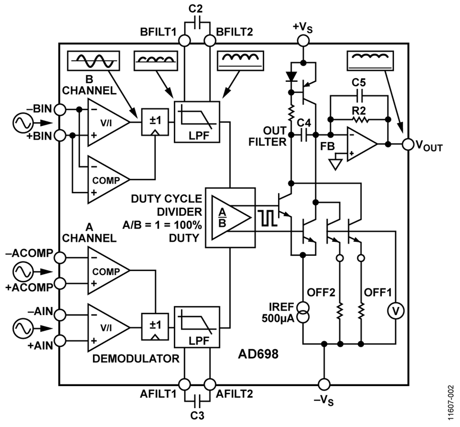

The block diagram of AD698 is shown in Figure 2. The input consists of two independent simultaneous demodulation channels. The B channel monitors the LVDT drive excitation. C2 filters the full-wave rectified output and then sends it to the arithmetic circuit. Channel A performance is identical except that the comparator pin is provided externally. Since the A channel may reach a 0 V output when the LVDT is empty, the primary side voltage (B channel) is typically used to trigger the A channel's demodulator. Additionally, a phase compensation network may be required to add phase lead or lag to the A channel to compensate for the LVDT primary-to-secondary phase shift. For a half-bridge circuit, the phase shift is not important and the A-channel voltage is sufficient to trigger the demodulator.
Figure 2. AD698 block diagram
After both channels have been demodulated and filtered, a voltage divider circuit equipped with a duty cycle multiplier is used to calculate the A/B ratio. The output of the voltage divider is the duty cycle. If A/B equals 1, the duty cycle is 100%. (This signal can be used if pulse width modulation output is required). The duty cycle driver circuit modulates and filters the reference current proportional to the duty cycle. The output amplifier regulates the 500 μA reference current and converts it to a voltage. The output transfer function is:

Following the design procedure for dual-supply operation (±15 V) in the AD698 data sheet, set the excitation frequency to 2.5 kHz, the system bandwidth to 250 Hz, and the output voltage range to 0 V to 5 V.
The AD698's internal oscillator typically produces a small amount of ripple that is passed to the output. Use a passive low-pass filter to reduce this ripple to the required level.
There are certain trade-offs when choosing capacitor values ​​to set the system bandwidth. Choosing a smaller capacitor value will give the system a higher bandwidth but will increase the output voltage ripple. This ripple can be suppressed by increasing the value of the parallel capacitance across the feedback resistor (which sets the output voltage level), but doing so increases the phase lag.
The AD8615 op amp buffers the output of the AD698, which ensures that the AD7992 ADC is driven from a low-impedance source (high-impedance sources will greatly reduce the AC performance of the ADC).
The low-pass filter is located between the output of the AD698 and the input of the AD8615 and serves two purposes:
  • Limit the input current of the AD8615.
  • Filter output voltage ripple.
The AD8615's internal protection circuitry allows the input to withstand input voltages higher than the supply voltage. This is important because the AD698's output voltage is capable of swinging ±11 V from ±15 V supplies. Higher voltages can be applied to the input as long as the input current is limited to 5 mA. This is mainly because the AD8615 (1 pA) has very low input bias current, allowing the use of larger resistors. Using these resistors increases thermal noise, causing the amplifier's overall output voltage noise to increase.
The AD8615 is an ideal amplifier for buffering and driving the input of the AD7992 12-bit SAR ADC because of its input overvoltage protection and the ability to swing rail-to-rail on both the input and output.

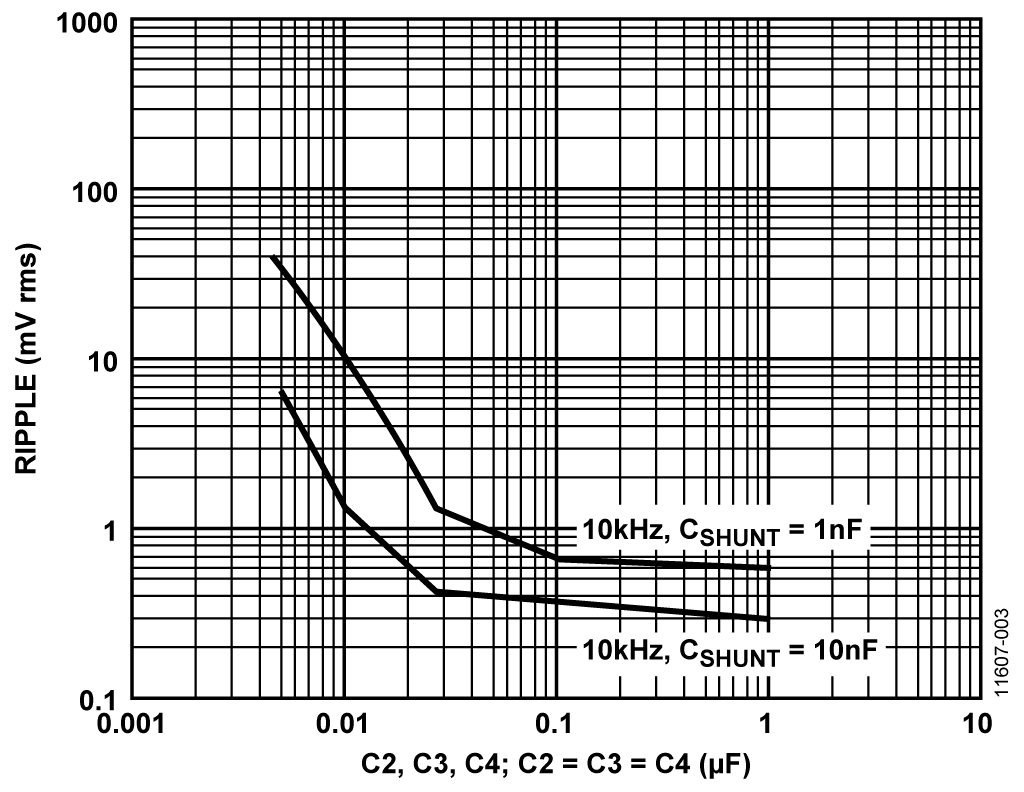

For LVDT signal conditioning circuits, the main source of output noise is the output ripple of the AD698. In comparison, the other noise sources (resistor noise, input voltage noise, and output voltage noise of the AD8615) are much smaller.
When the capacitor value is 0.39 μF and the parallel capacitance across the feedback resistor is 10 nF (as shown in Figure 3), the output voltage ripple of the AD698 is 0.4 mV rms. Note that the simplified schematic in Figure 1 does not show these devices and their associated pin connections; however, details can be found in the AD698 data sheet.
Figure 3. Output voltage ripple versus filter capacitance

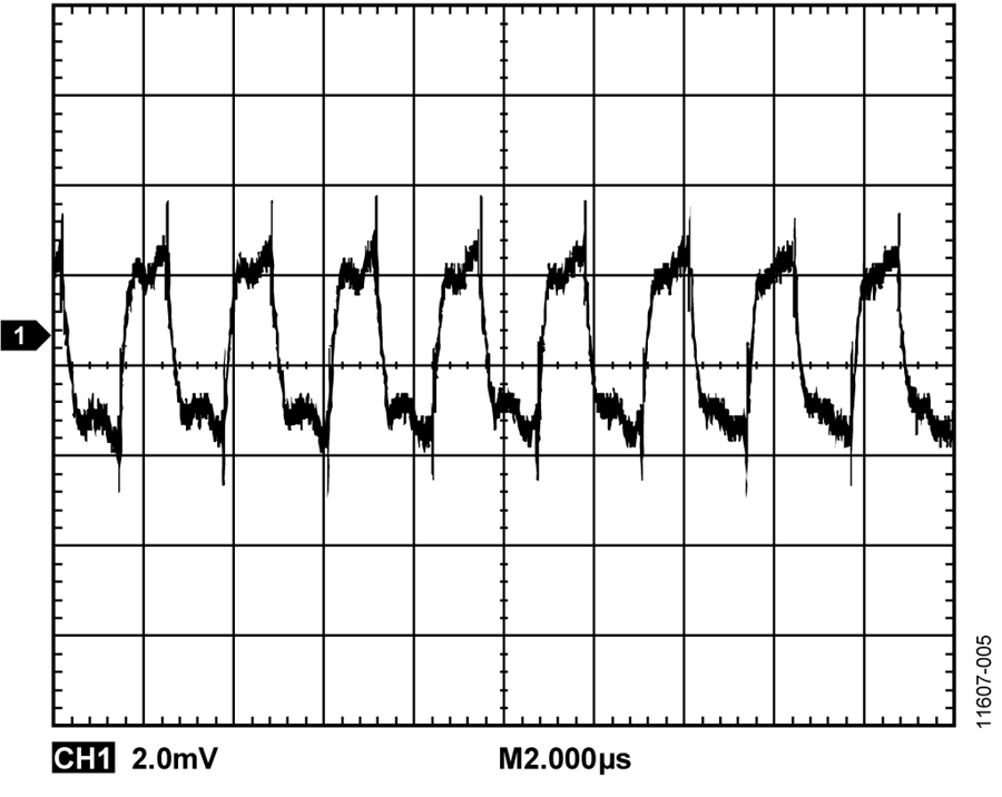

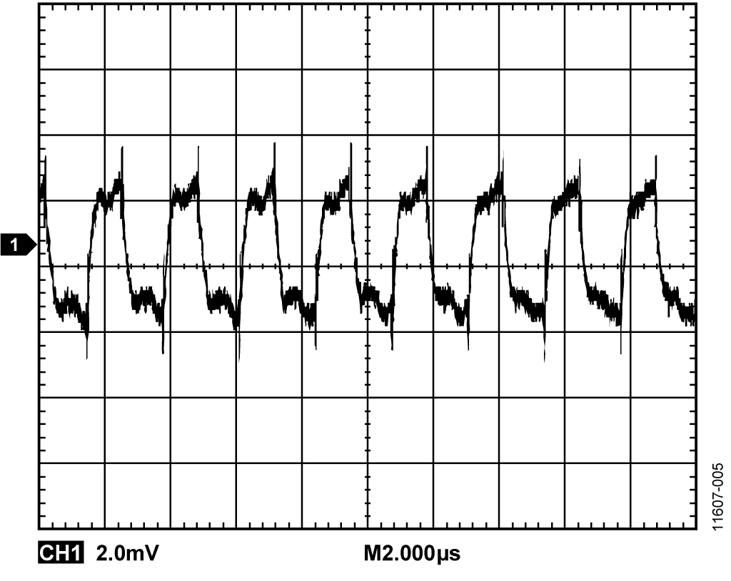

Using a Measurement Specialties, Inc. E-100 Economy LVDT connected to J3 and monitoring the output of the AD698 J6 on the EVAL-CN0301-SDPZ evaluation board with a digital oscilloscope, the actual output ripple is 6.6 mV pp, as shown in Figure 5.
Figure 5. Output voltage ripple before low-pass filter processing
The low-pass filter (3 kΩ, 0.01 μF) between the AD698 output and AD8615 input has a −3 dB bandwidth of 5.3 kHz and reduces ripple to 2 mV pp.

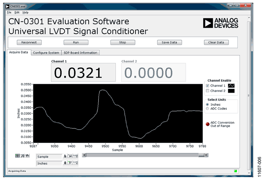

Since the low-pass filter is located between the AD698 output stage and the AD8615 input stage, data can be collected from the EVAL-CN0301-SDPZ evaluation board, as shown in Figure 6.
Figure 6. CN-0301 evaluation software screenshot
The AD698 's ripple is attenuated to 2 mV pp, and the system achieves 11 bits of noise-free code resolution.
