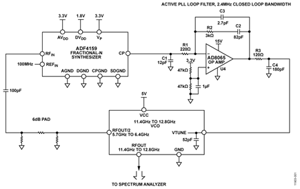

The PLL circuit shown in Figure 1 uses a 13 GHz fractional-N frequency synthesizer, a wideband active loop filter and a VCO. The 200 MHz frequency hopping phase within 5° has a phase establishment time of less than 5 μs.
This performance is achieved using an active loop filter with a bandwidth of 2.4 MHz. This wide-bandwidth loop filter performance is achieved because the ADF4159 phase frequency detector (PFD) has a maximum frequency of 110 MHz and the AD8065 op amp has a high gain-bandwidth product of 145 MHz.
The AD8065 op amp used in the active filter is capable of operating from a 24 V supply voltage, allowing control of most wideband VCOs with tuning voltages from 0 V to 18 V.
Figure 1. Functional block diagram of the ADF4159, AD8065 active loop filter, and 11.4 GHz to 12.8 GHz VCO (schematic: all connections and decoupling not shown)

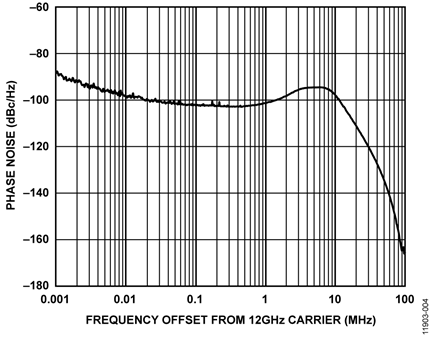

In a fractional-N PLL, the noise from the sigma-delta modulator (SDM) peaks at half the PFD frequency (f PFD ). For example, if the PFD frequency of a fractional-N PLL is 32 MHz, the unfiltered SDM noise peaks at 16 MHz. SDM noise destabilizes the loop, causing the PLL to fail to lock. Figure 2 shows the simulated phase noise curve under this condition.
Figure 2. Phase noise curve at 12 GHz output (f PFD = 32 MHz, LBW = 2.4 MHz)

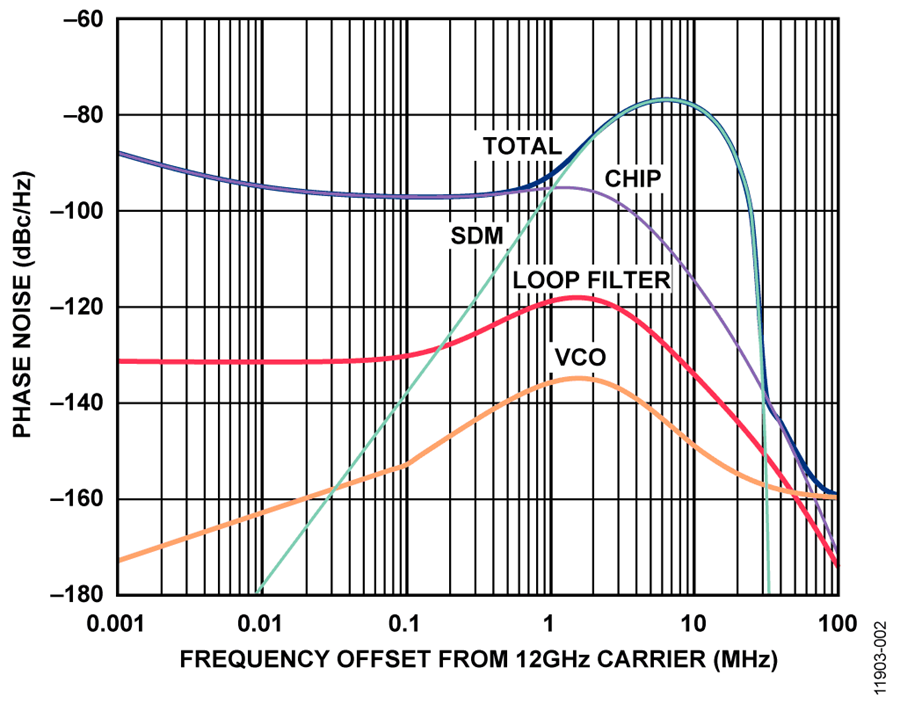

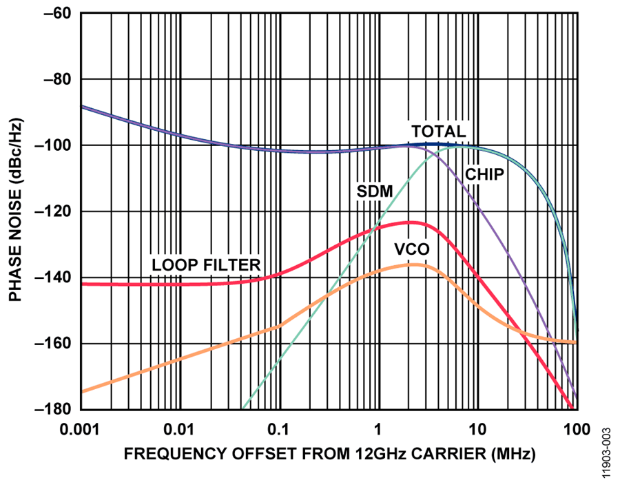

The maximum PFD frequency of the ADF4159 is 110 MHz. This means that unfiltered SDM noise will peak at 55 MHz. Figure 3 shows the phase noise curve at a PFD frequency of 110 MHz. SDM noise occurs at large offsets from the carrier, so a loop filter can be used to filter it out.
Figure 3. Phase noise curve at 12 GHz output (f PFD = 110 MHz, LBW = 2.4 MHz)
The higher maximum PFD frequency of the ADF4159 is also important, as it is recommended to keep the LBW below 1/10 of the PFD frequency to ensure stability.

The supply voltage for the ADF4159's internal charge pump is 3.3 V. However, many wideband VCOs require tuning voltages up to 18 V. To meet this requirement, an active loop filter is used. The active filter multiplies the ADF4159's output tuning range by the op amp's gain. See the AD8065 section of this circuit note for more details.
The ADF4159 supports programmable charge pump current characteristics. This feature allows the user to easily modify the dynamic characteristics of the loop filter without changing the physical components. At this circuit's 2.5 mA charge pump current, the LBW is designed to be 2.4 MHz. The charge pump current can be reduced, thereby reducing the LBW without making physical changes to the loop filter components.

Active filter using AD8065
The AD8065 op amp has a supply voltage range of 24 V, a gain-bandwidth product (GBP) of approximately 145 MHz, and low noise (7 nV/√Hz). This property makes it ideal for active filters.
For most PLL applications, a phase margin of 45° to 55° is recommended to maintain a stable loop and minimize settling time. In an active loop filter (such as an op amp in the loop filter), additional poles will be generated at the op amp's unity gain frequency (or gain-bandwidth product). This extra pole introduces more phase lag, so loop instability may occur at different pole frequencies.

The op amp in the active filter is configured in inverting mode, so the ADF4159 is programmed with the negative polarity of the phase detector. The inverting configuration is easier to implement because the op amp positive input can be biased at a fixed voltage that does not change as the op amp output changes, whereas in the non-inverting configuration the op amp output changes.
The AD8065 can also be used as a buffer to reduce the input capacitance of the VCO. For a 2.4 MHz LBW passive filter, the combined capacitance of the VCO input and the last capacitor of the filter must be approximately 1.5 pF. However, the VCO's measured input capacitance alone is 52 pF.
For loop filter capacitors, it is recommended to use C0G/NP0 ceramic capacitors (which have faster discharge times than standard capacitors) to minimize phase settling time.
This circuit requires excellent layout, grounding, and decoupling techniques as described in tutorials MT-031 and MT-101 . Complete schematics, layout files, and bill of materials can be found in the CN-0302 Design Support Package ( www.analog.com/CN0302-DesignSupport ).

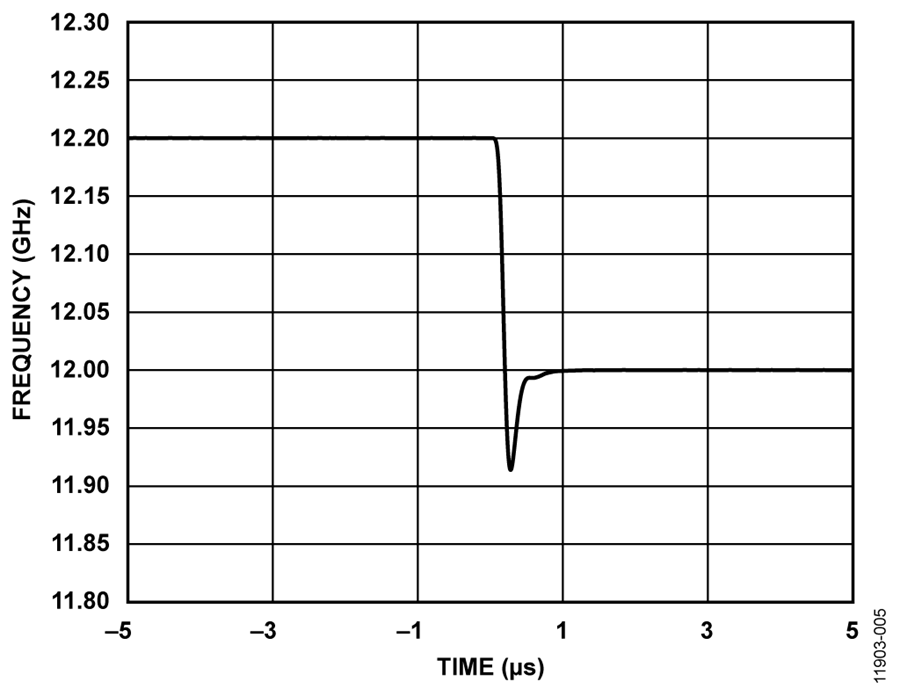

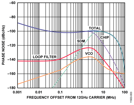

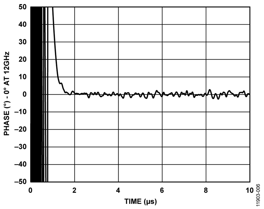

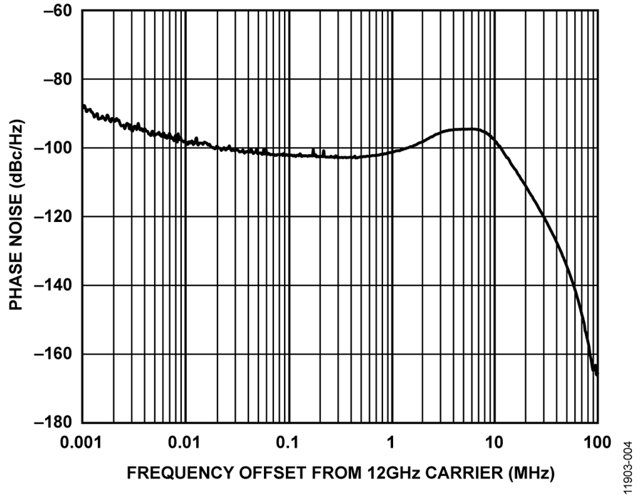

The measured phase noise of the circuit is shown in Figure 4. The frequency and phase settling time of 200 MHz frequency hopping are shown in Figure 5 and Figure 6 respectively.
Figure 4. Phase noise at 12.002 GHz (LBW = 2.4 MHz)
Figure 5. 200 MHz Frequency Hopping Settling Time (12.2 GHz to 12.0 GHz)
Figure 6. 200 MHz phase settling time (12.2 GHz to 12.0 GHz)
