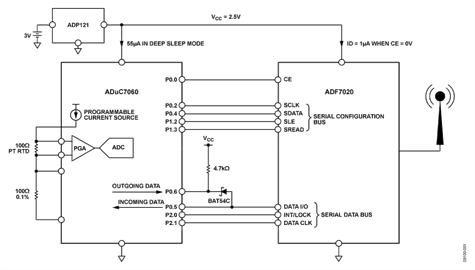

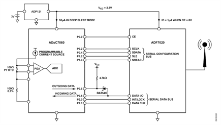

Ideally, wireless measurement nodes have low power consumption, long range, and are easy to interface with different sensors. By using ADI's three devices together, it is possible to achieve an intelligent measurement node with an average current consumption of <70 μA, a distance of nearly 1 km (without obstacles), and a data rate of one transmission per minute, while maintaining 16-bit ADC performance (see Figure 1 ), making the circuit suitable for battery-powered and automation, remote detection and other applications.
The low-power temperature measurement node included in the system wakes up once every minute, measures the temperature and sends the results to the base node at 10 kbps, then returns to sleep. The base node continuously receives data packets from the measurement node and sends the information to the PC via UART for display within the "HyperTerminal".

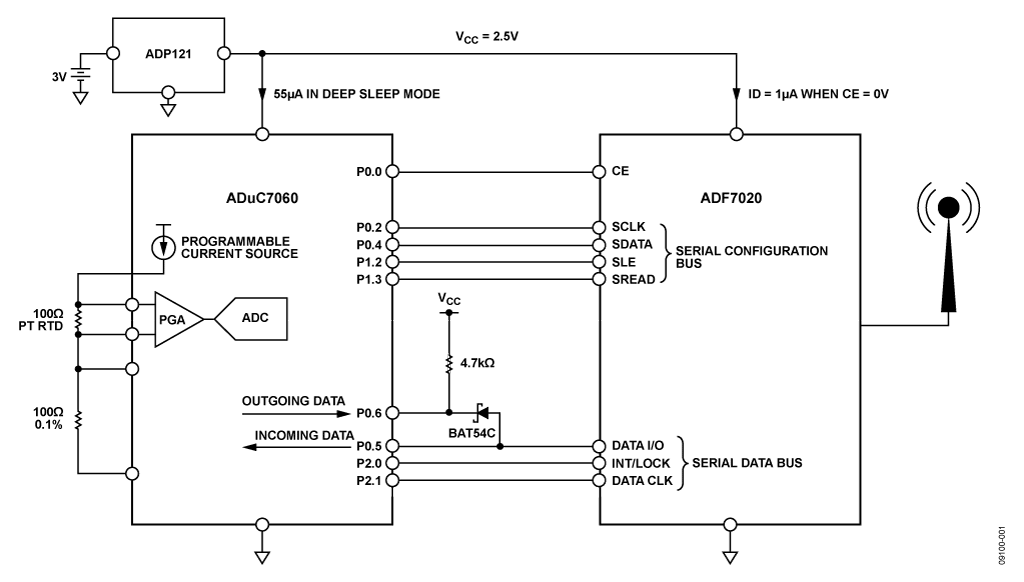

The ADUC7060 precision analog microcontroller uses a low-power ARM7 core and has a variety of precision analog functions. Thanks to the built-in on-chip multiplexer, digital programmable gain amplifier (PGA), voltage reference, programmable current source, and 24-bit Σ-Δ ADC, the device can interface directly with virtually any temperature and bridge sensor. In this example, a 4-wire Pt100 (100 Ω platinum RTD) temperature sensor was selected. For details on the measurement circuit, see Application Note Application Note AN-0970.  The wireless frequency band selected for this application is the license-exempt ISM (Industrial, Scientific and Medical) band below 1GHz. The ADF7021 transceiver supports frequency bands ranging from 431 MHz to 478 MHz and 862 MHz to 956 MHz, making it a natural choice. This low-power transceiver requires minimal external components and easily interfaces with the ADuC7060 precision analog microcontroller for excellent performance.
The ADP121 voltage regulator provides a 2.5 V supply voltage from two 1.5 V batteries. The regulator's extremely low quiescent current (11 μA at no load) is critical to maximizing battery life.
Figure 1. Low-power remote ISM wireless measurement node (simplified schematic: decoupling and all connections not shown)
Circuit description
Connecting the ADF7020 ISM transceiver and the ADuC7060 precision microcontroller are two buses. Both are serial bidirectional buses: one bus is responsible for configuring the transceiver and requires four microprocessor ports; the other bus is a data bus used to transfer data between the controller and the transceiver, which requires at least three microprocessor port. In this application, two ports are used instead of a single bidirectional port with two interrupts. This simplifies the software, but requires the use of additional diodes and resistors to separate the input and output data streams. The parallel combination of two Schottky diodes ensures a logic low level below 200 mV. The BAT54C has two diodes in the same package (connect pin 1 and pin 2 to get a parallel configuration). All digital ports on the ADuC7060 have programmable pull-up resistors; however, external pull-up resistors are also required. For 10 kbps data rates, a 4.7 kΩ resistor works well.

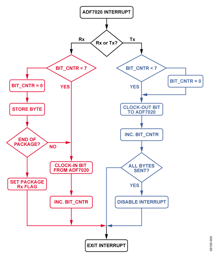

Shown in Figure 2 is the flow chart of the main loop of the measuring node and the basic receiving node.
Figure 2. Main loop flow chart of measuring and receiving nodes

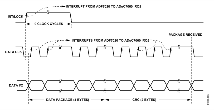

The ADF7020 supports multiple modulation schemes. In this example, GFSK (Gaussian Frequency Shift Keying) is used. The advantage of this solution is excellent spectral efficiency. In this mode, the ADF7020 generates data clocks both when transmitting and when receiving. The rising edge of the clock (DATA CLK) generates an interrupt, causing the ADuC7060 to place data bit by bit on the output port as shown in Figure 3. After all data is output, chip selection is released and the ADuC7060 re-enters deep sleep mode.
On the receiving side, the ADF7020 generates an interrupt (the INT/LOCK port remains high for nine clock cycles) after receiving a matching sync word.
This signal tells the ADuC7060 processor to prepare to receive data packets. Each bit received from the packet generates an interrupt within the ADuC7060. In the interrupt service routine (ISR), the bit stream is read and stored in the buffer. After all bytes within the packet have been received, a flag is set indicating that a new packet has been received. The main loop can now confirm the validity of the packet via checksum. Correct and complete packets are then processed. In this example, the above information is sent to the PC through UART for display. As shown in Figure 4, the same ISR can both receive data from and send data to the ADF7020 transceiver.
Figure 3. Data I/O timing
