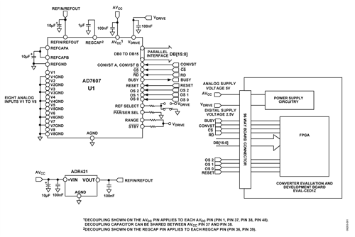

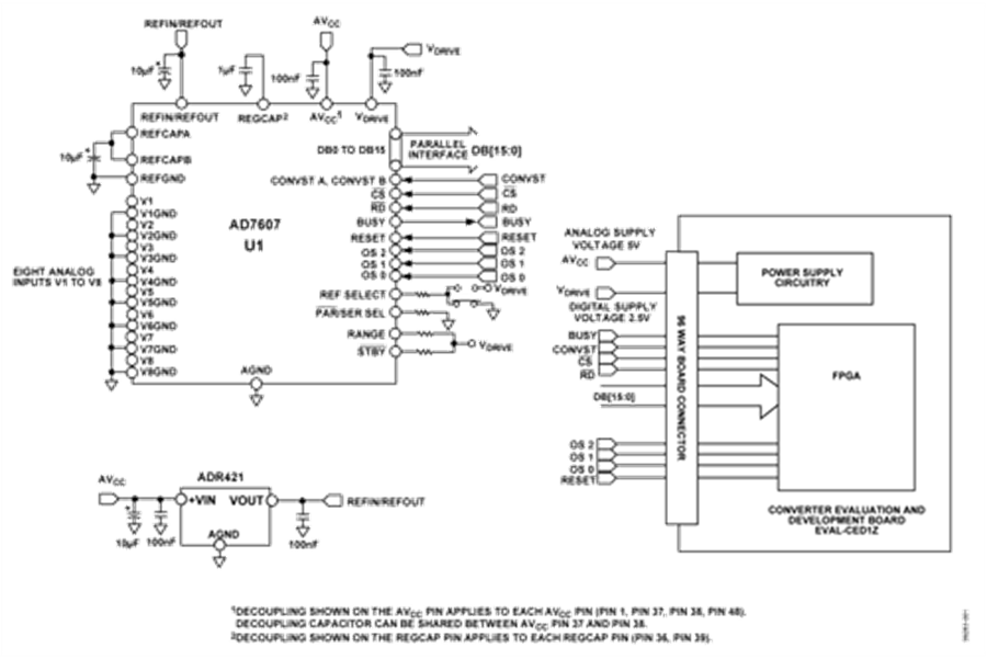

The AD7607 is an 8-channel DAS integrating a 14-bit, bipolar input, simultaneous sampling SAR ADC with an 84 dB signal-to-noise ratio (SNR) to meet the requirements of this type of low-voltage protection and measurement system. The circuit shown in Figure 1 also uses an external precision, low-temperature drift, low-noise voltage reference, the ADR421 , to support high-channel-count applications that require absolute accuracy performance.

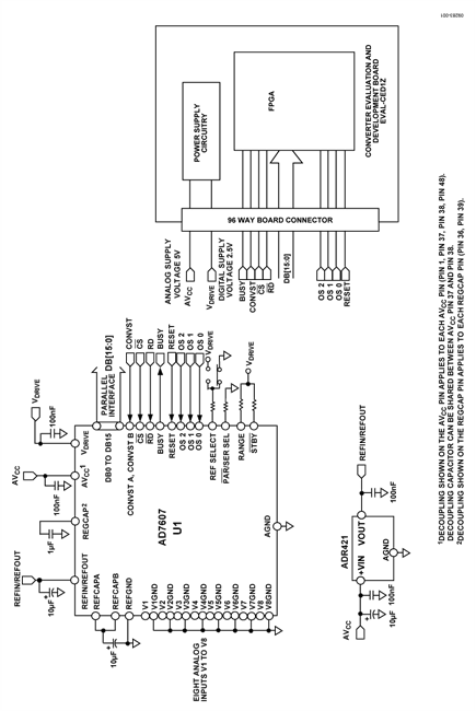

Figure 1. Low-cost, 8-channel, simultaneous sampling data acquisition system (simplified electrical schematic: decoupling and all connections not shown)
Circuit description
The AD7607 is an integrated data acquisition system that integrates an input amplifier, overvoltage protection circuit, analog anti-aliasing filter, 14-bit SAR ADC and digital filter on-chip. This circuit consists of AD7607 and 2.5 V reference voltage source ADR421. To achieve good channel-to-channel matching, a symmetrical layout around the analog input channels and device decoupling is important.

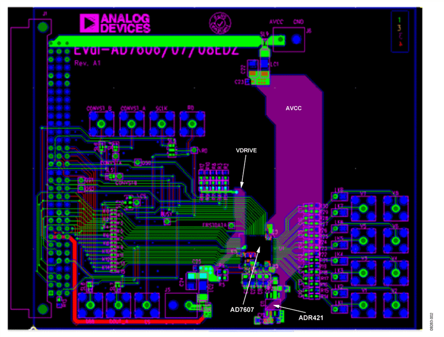

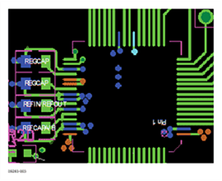

To ensure good channel-to-channel matching, it is important to have a symmetrical layout of the analog input channels. In a system containing multiple AD7607 devices, the devices must be laid out symmetrically to ensure good performance matching between the devices.
Figure 2 shows the optimal board layout for the AD7607 and ADR421. The AVCC voltage plane is routed along the right side of the AD7607, and the VDRIVE power trace is routed along the left side of the AD7607. The reference voltage source ADR421 is located south of the AD7607. A solid ground plane is used here.
Figure 2. PCB layout showing the AD7607 DAS and ADR421 voltage reference.
These symmetrical layout principles also apply to systems containing multiple AD7607 devices. The AD7607 devices should be placed in a north-south direction with the reference voltage in the middle of the devices and the reference voltage traces routed in a north-south direction, similar to Figure 2. For system details using multiple AD7606 (16-bit 8-channel DAS), see Circuit Note CN-0148 .
Good decoupling is also important in order to lower the supply impedance of the AD7607 and reduce the amplitude of the supply spikes. Decoupling capacitors should be placed as close as possible to the DUT power pins and their corresponding ground pins. The decoupling capacitors of the REFIN/REFOUT pin and the REFCAPA and REFCAPB pins are also important decoupling capacitors related to performance and should be as close as possible to the corresponding AD7607 pins. If possible, these capacitors should be placed on the same side of the board as the AD7607 device. Figure 3 shows the recommended decoupling layout for the top layer of the AD7607 circuit board.
Figure 3. Top-level decoupling

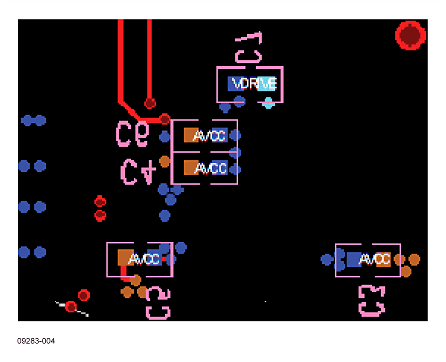

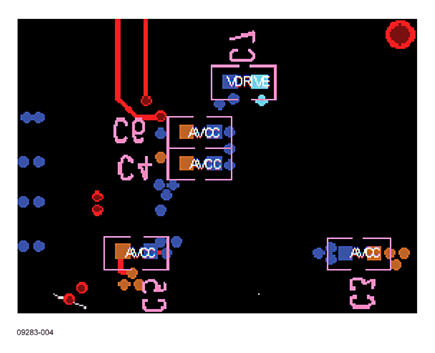

The four ceramic capacitors on the top layer of the board are decoupling capacitors for the REFIN/REFOUT pin, REFCAPA pin, and REFCAPB pin. These capacitors are placed in a north-south direction so as to be as close as possible to the corresponding pins. Figure 4 shows the low-level decoupling layout used for decoupling the four AV CC pins and the V DRIVE pin. Multiple vias are used here to connect the pins to their corresponding decoupling capacitors. The symmetrical layout of decoupling capacitors around the AD7607 device facilitates performance matching between devices. Multiple vias are used to connect capacitor pads and pin pads to ground and to voltage planes and reference voltage traces.
Figure 4. Low-level decoupling

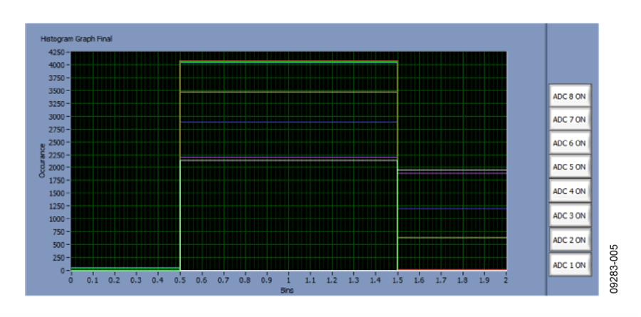

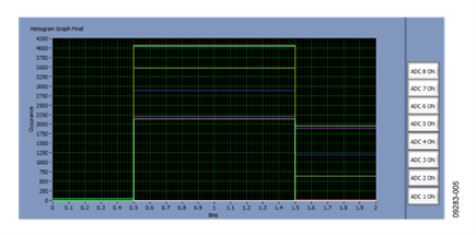

In high-channel-count systems, good channel-to-channel and device-to-device performance matching can greatly simplify the calibration procedure. The symmetrical layout of the AD7607 device, analog input channels, and decoupling capacitors helps match performance between multiple devices. Using a common system reference voltage can further enhance the matching performance of the system. Figure 5 shows the measured matching performance of eight channels on the board with all inputs tied to ground. The distribution histograms of up to three codes are shown here. The center of each channel histogram is code 1.
Figure 5. Histogram of 8 channels with input grounded

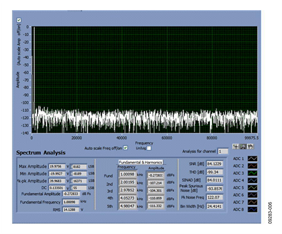

In this circuit, the AD7607 is configured to operate in external reference mode. The ADR421 provides the 2.5 V reference voltage to the REFIN/REFOUT pin of the AD7607. Apply a 1 kHz signal to channel 1 of the AD7607. The input range of the AD7607 is configured to ±5 V. The AD7607 achieves an SNR of 84.12 dB when sampling at 200 kSPS on all eight channels. This performance is equivalent to approximately 13.7 effective number of bits (ENOB), where ENOB = (SNR − 1.76 dB)/6.02.
Figure 6. FFT shows SNR of 84.12 dB (input = 1 kHz, fs = 200 kSPS)

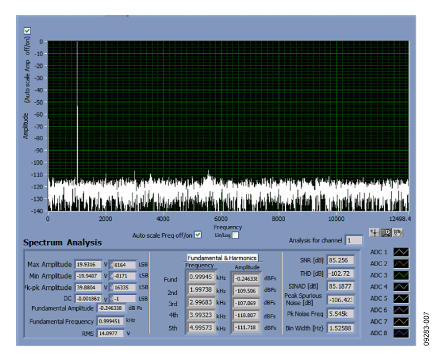

To further improve SNR performance and the ENOB of the system, the AD7607 can be configured to operate in 8x oversampling mode. In this mode, the SNR is increased to 85.25 dB, thus the effective number of bits is increased to 13.9 bits. When the AD7607 is used in 8x oversampling mode, the throughput rate drops to 25 kSPS per channel.
Figure 7. FFT shows SNR of 85.26 dB (8x oversampling, fs = 25 kSPS)
