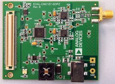

Crest factor, peak and rms RF power measurement circuit optimized for high speed, low power and single 3.3 V supply
Circuit functions and advantages
The circuit shown in Figure 1 measures peak and rms power at any RF frequency from 450 MHz to 6 GHz with a dynamic range of approximately 45 dB. The measurements are converted to a differential signal to eliminate noise and form a digital code at the output of the 12-bit SAR ADC via a serial interface and an integrated voltage reference. Perform a simple two-point calibration in the digital domain.

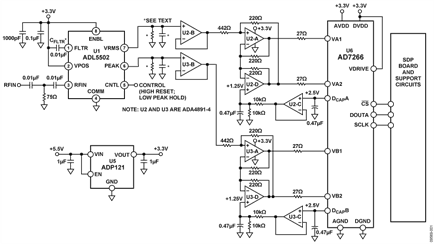

Figure 1. High-speed, low-power, crest factor, peak, and power measurement system (simplified schematic: decoupling and all connections not shown)
Circuit description
The measured RF signal is applied to the ADL5502, and the 75 Ω termination resistor at the RF input is connected in parallel with the input impedance of the ADL5502 to provide 50 Ω broadband matching. More precise resistive or reactive matching is available for narrowband applications (see the "RF Input Interface" section of the ADL5502 data sheet).
The ADL5502's internal filter capacitor provides an average in the squared domain but retains a residual AC signal at the output. Peak-to-average ratio signals (such as W-CDMA or CDMA2000) can produce AC residual levels at the ADL5502 VRMS dc output. To reduce the impact of these low-frequency components on waveform formation, some additional filtering is required. The ADL5502's internal square-domain filter capacitor can be enhanced by connecting the CFLTR capacitor from Pin 1 (FLTR) to Pin 2 (VPOS). The AC residual level is further reduced by adding capacitance to the VRMS output. The internal 100 Ω output resistor, together with the added output capacitance, forms a low-pass filter, reducing output ripple at the VRMS output (see "Selecting a Squared Domain Filter" and "Output Low-Pass Filter" in the ADL5502 data sheet for more information part).
To measure the waveform peak, the control line (CNTL) must be temporarily set to logic high (reset mode >1 μs) and then returned to logic low (peak hold mode). This initializes the ADL5502 to a known state. When setting the device to measure peaks, peak hold mode should be toggled during which the input rms power and crest factor (CF) do not change.
If the ADL5502 is in peak hold mode and CF changes from high to low, or the input power changes from high to low, an erroneous peak measurement will be reported. The ADL5502 only reports the highest peak that occurs when peak hold mode is enabled and input power or CF is high. The PEAK output does not reflect the latest peak within the signal unless CNTL is reset.
The ADL5502 is capable of delivering approximately 3 mA of VRMS output current. The output current is supplied through the on-chip 100 Ω series resistor; therefore, any load resistance forms a voltage divider with this on-chip resistor. It is recommended to drive a highly resistive load with the ADL5502 VRMS output to maintain output swing. A snubber circuit is required if the application requires driving low-resistance loads (and where increased nominal conversion gain is required).
The PEAK output is designed to drive a 2 pF load. It is recommended to drive low capacitive loads with the ADL5502 PEAK output to achieve full output response time. The effect of larger capacitive loads is especially noticeable when tracking the envelope during falling transitions. When the envelope is in a falling transition, the load capacitance is discharged through the 1.9 kΩ on-chip load resistor. If a larger capacitive load cannot be avoided, the additional capacitance can be offset by connecting a shunt resistor at the PEAK output to ground, allowing for rapid discharge. This shunt resistor allows higher currents to flow through the ADL5502 and should not be lower than 500 Ω.

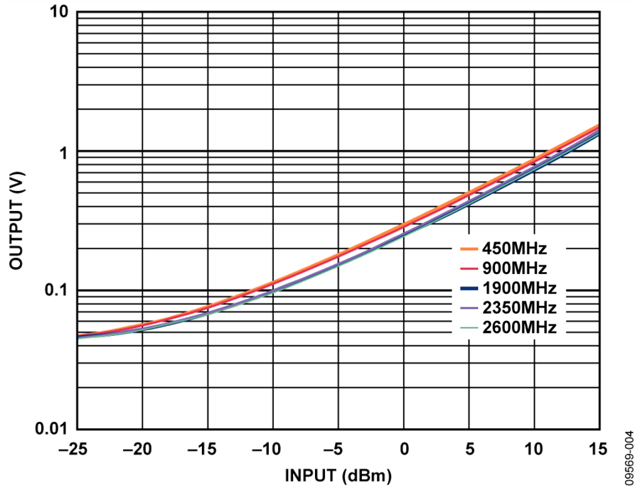

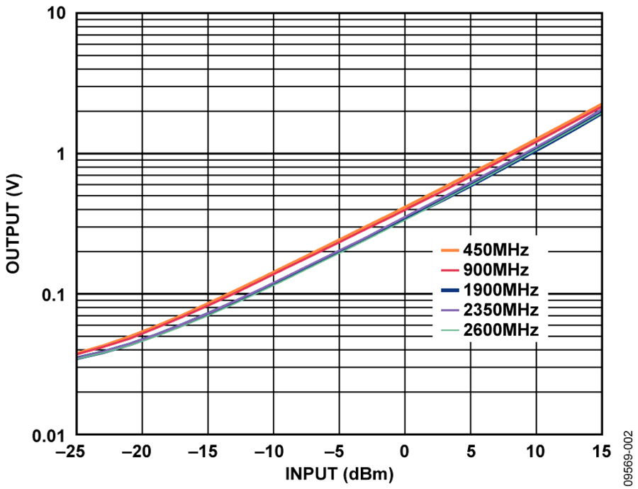

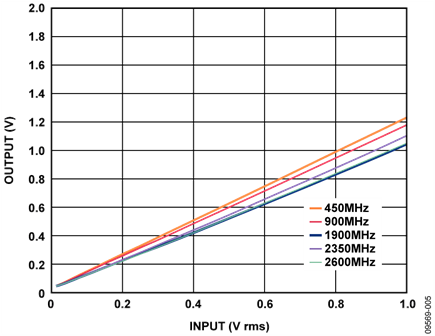

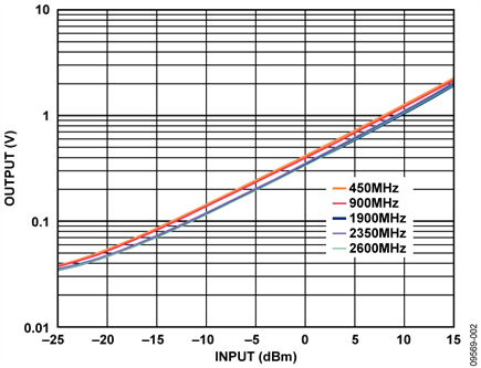

Typical measured performance characteristics of this circuit are shown in Figures 2 through 5.

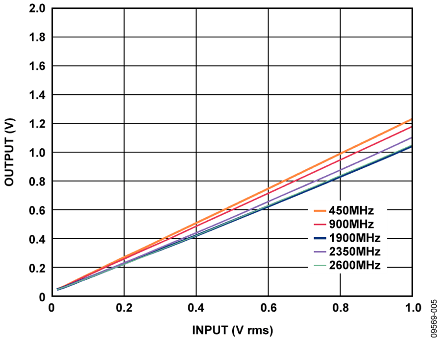

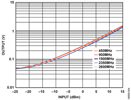

Figure 2. Measured VRMS output versus input level (log scale), 450 MHz, 900 MHz, 1900 MHz, 2350 MHz, 2600 MHz, +3.3 V supply

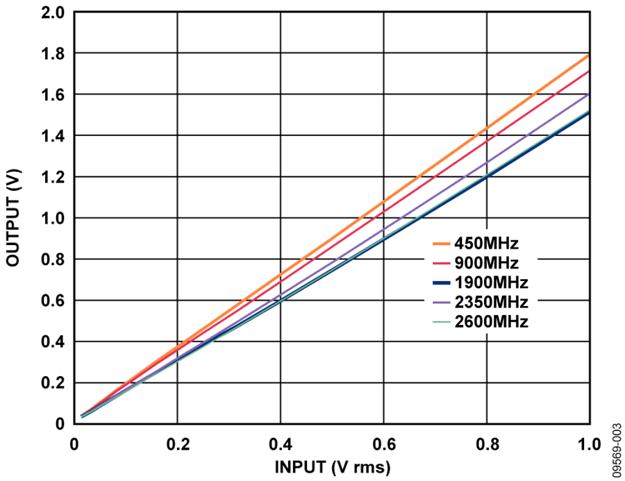

Figure 3. Measured VRMS output versus input level (linear scaling), 450 MHz, 900 MHz, 1900 MHz, 2350 MHz, 2600 MHz, +3.3 V supply

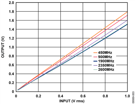

Figure 4. Measured PEAK output versus input level (log scale), 450 MHz, 900 MHz, 1900 MHz, 2350 MHz, 2600 MHz, +3.3 V supply
Figure 5. Measured PEAK output versus input level (linear scaling), 450 MHz, 900 MHz, 1900 MHz, 2350 MHz, 2600 MHz, +3.3 V supply

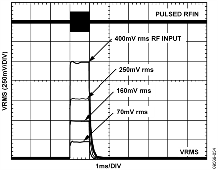

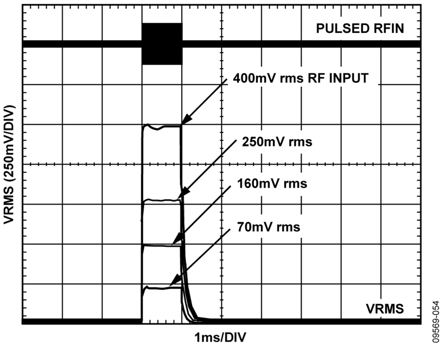

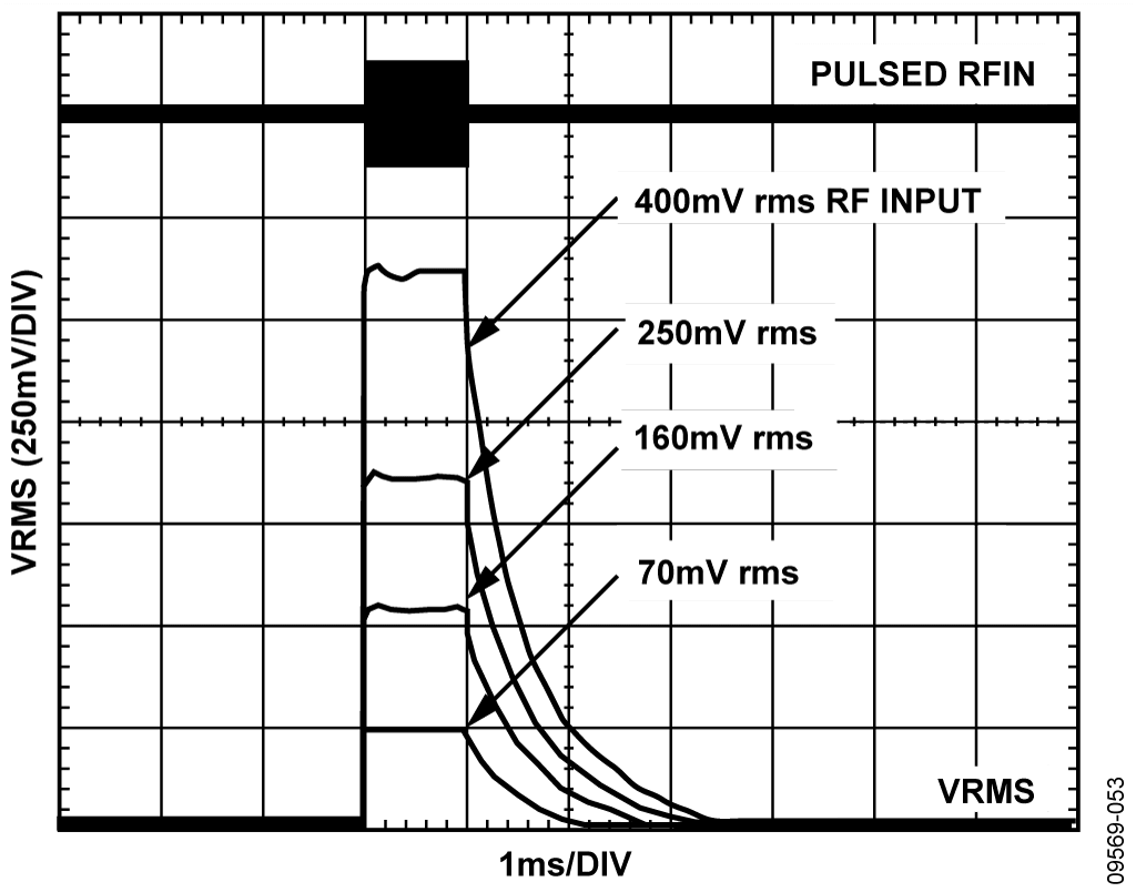

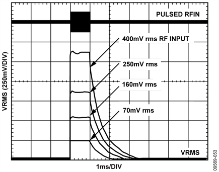

The turn-on time and impulse response are significantly affected by the square-domain filter size ( FLTR ) and the output shunt capacitance connected to the VRMS output. Figure 6 (from the ADL5502 data sheet) shows a plot of the output response versus an RF pulse on the RFIN pin with a 0.1 μF output filter capacitor and no squared domain filter capacitor (C FLTR ). The falling edge is clearly related to the output shunt capacitance. .
Figure 6. Output response versus various RF input pulse levels, 3 V supply, 900 MHz frequency, square domain filter on, 0.1 μF output filter

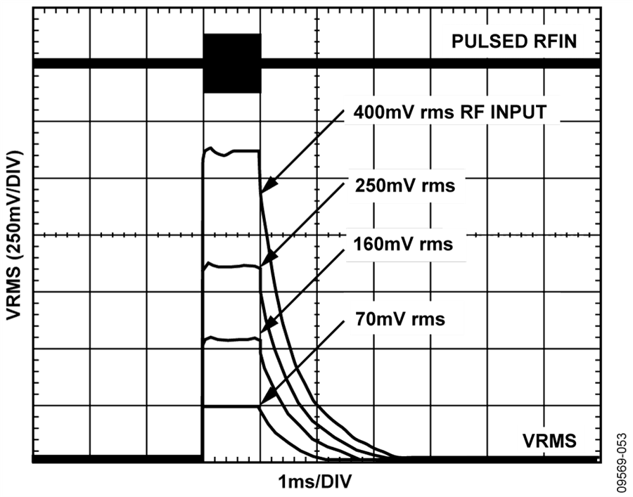

To improve the enable and pulse response on the falling edges, place a resistor in parallel with the output shunt capacitor. The added resistor helps discharge the output filter capacitor. Although this method shortens the off-time, the added load resistor also attenuates the output (see the "Output Drive Capability" and "Buffering" sections of the ADL5502 data sheet). Figure 7 (from the ADL5502 data sheet) shows the improvement achieved by adding a 1 kΩ parallel resistor.
Figure 7. Output response versus various RF input pulse levels, 3 V supply, 900 MHz frequency, square domain filter on, 0.1 μF output filter and 1 kΩ shunt resistor
The RMS and PEAK outputs of the ADL5502 pass through a unity-gain buffer, which drives a cross-coupled stage that converts the single-ended output to a differential signal. The AD7266's +2.5 V internal reference (connected via the D CAP A and D CAP B pins) is routed through another unity gain buffer and voltage divider, which sets the network common mode voltage to +1.25 V. .
The AD7266 enables simultaneous sampling of the RMS and PEAK outputs and transmits data within a 1 μs response time. Data is provided over a single serial data line. Because slope and intercept vary from device to device, board-level calibration must be performed to achieve high accuracy. Generally speaking, calibration is performed by applying two input power levels to the ADL5502 and measuring the corresponding output voltages. The selected calibration point should generally be within the linear operating range of the device, and the best-fit line is characterized by calculating the conversion gain (or slope) and intercept as follows:

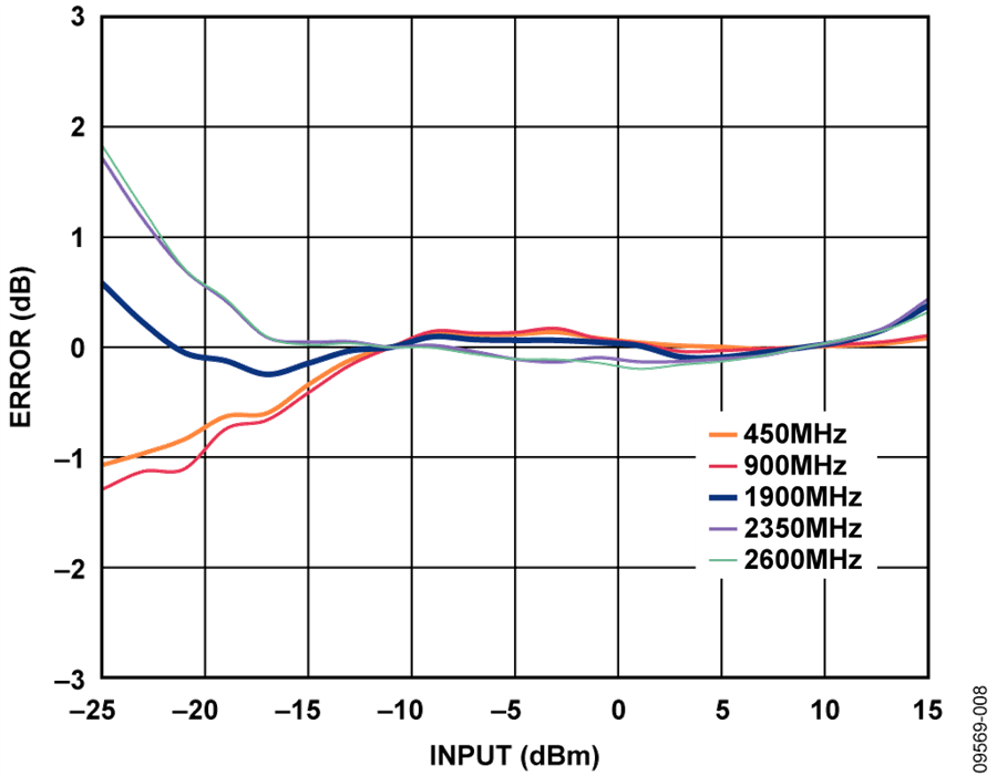

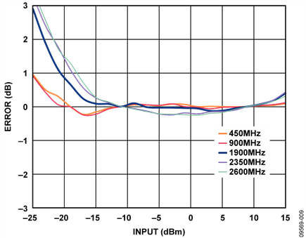

Figures 8 and 9 show plots of VRMS versus PEAK error at 25°C, which is the temperature at which the ADL5502 was calibrated. Note that this error is not zero because the ADL5502 does not fully comply with the ideal linear formula even within its operating region. However, with appropriate adjustments, the error at the calibration point can be made equal to zero.
Figure 8. Measured VRMS linearity error versus input level, 450 MHz, 900 MHz, 1900 MHz, 2350 MHz, 2600 MHz, +3.3 V supply

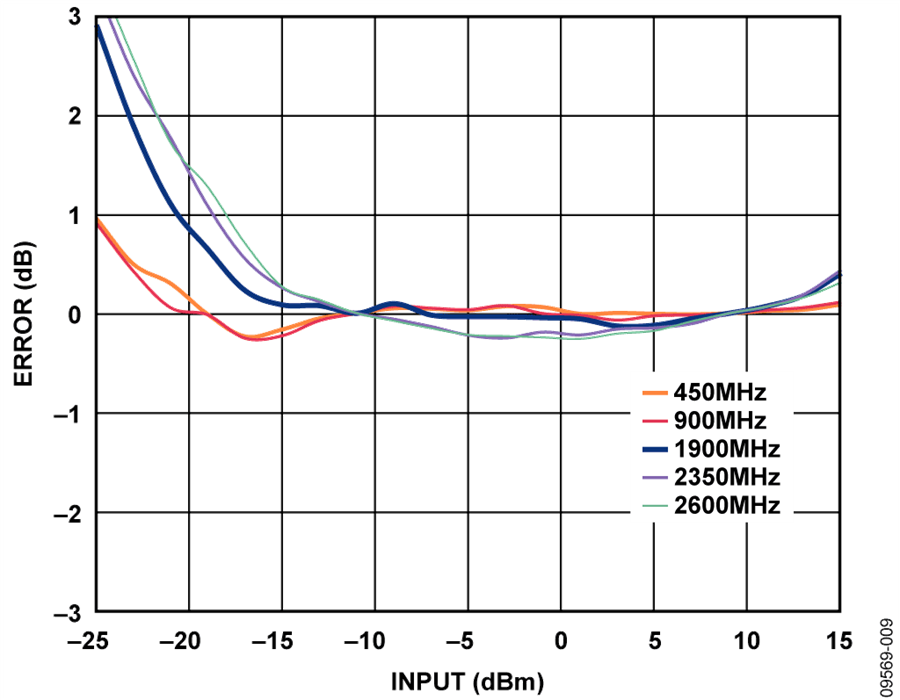

Figure 9. Measured PEAK linearity error versus input level, 450 MHz, 900 MHz, 1900 MHz, 2350 MHz, 2600 MHz, +3.3 V supply

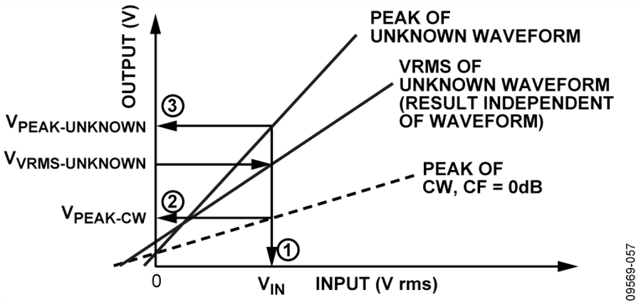

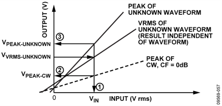

Calibration of the CF calculation can be accomplished when the VRMS and PEAK output characteristics (slope and intercept) are known. Measuring and calculating the crest factor of any waveform must employ a three-level process. First, an unknown signal must be applied to the RF input and the corresponding VRMS level measured. This level is represented in Figure 10 as V VRMS-UNKNOWN RF input input, V IN is calculated using V VRMS-UNKNOWN and Equation 3.
Figure 10. Crest factor calculation program
Next, use V IN to calculate the CW reference level of PEAK, VPEAK-CW (that is, the output voltage seen when the input waveform is a CW signal).
cn0187_equation4
Finally, measure the actual levels of PEAK and V PEAK-UNKNOWN , and CF can be calculated as >/p>
cn0187_equation5

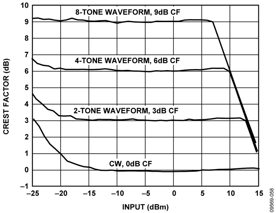

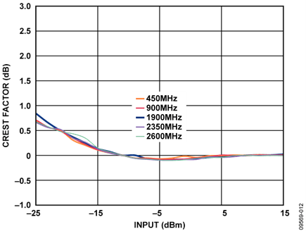

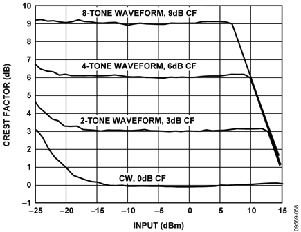

Among them, V PEAK-CW is used as the reference point for comparing V PEAK-UNKNOWN . If both V PEAK values ​​are equal, then CF is 0 dB, as shown for the CW signal in Figure 11 (from the ADL5502 data sheet). The calculated CF fluctuates around the 0 dB line throughout the dynamic range. Likewise, for complex waveforms of 3 dB, 6 dB, and 9 dB CF, the calculated results fluctuate precisely around the CF level.
Figure 11. Reported crest factors for various waveforms

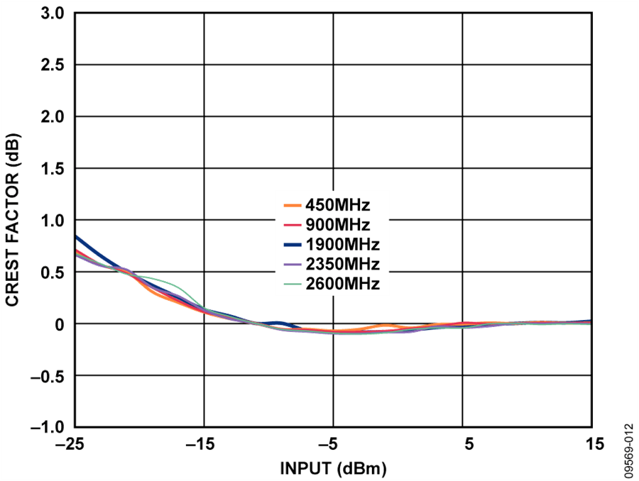

Figure 12. Measured crest factor of CW signal versus input level, 450 MHz, 900 MHz, 1900 MHz, 2350 MHz, 2600 MHz, +3.3 V supply
