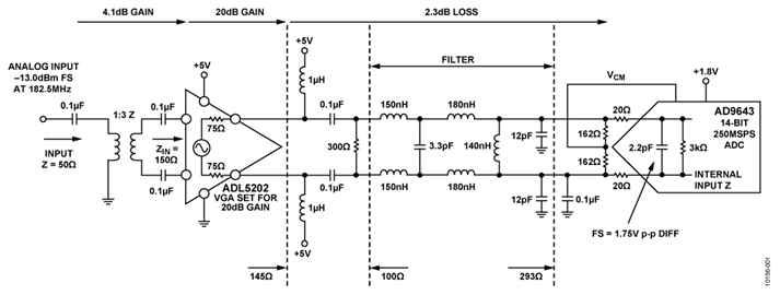

The circuit shown in Figure 1 is a 75 MHz wideband receiver front end based on the ADL5202 wide dynamic range, high speed, digitally controlled variable gain amplifier (VGA) and the 14-bit, 250 MSPS AD9643 digital converter (ADC).
The fifth-order Butterworth anti-aliasing filter is optimized based on the performance and interface requirements of the amplifier and ADC. The total insertion loss caused by the filter network and other resistive components is approximately 2.3dB. The overall circuit (integrated bandpass filter) has a 1dB bandwidth of 75 MHz (145 MHz to 220 MHz) and a 3dB bandwidth of 110 MHz (120 MHz to 230 MHz). Passband flatness is 1 dB.
This circuit is optimized for processing 75 MHz bandwidth IF signals centered at 182.5 MHz (second Nyquist frequency region) and sampled at 245.76 MSPS. Using a 182.5 MHz analog input in the 75 MHz band, the measured signal-to-noise ratio (SNR) and spurious-free dynamic range (SFDR) were 68.4 dBFS and 80.7 dBc, respectively.
Figure 1. Single channel (schematic diagram: all connections and decoupling not shown) gain, loss and signal level of a four-channel IF receiver front end measured at 10MHz
Circuit description
The circuit shown in Figure 1 accepts a single-ended input and converts it to a differential input signal using a wide-bandwidth (5 MHz to 300 MHz) M/A-COM TC3-1T+ 1:3 (Z) transformer. The ADL5202 6.0 GHz differential amplifier has a 150Ω differential input impedance and supports three different gain settings: 0 dB, 10 dB, and 20 dB.
The ADL5202 is an ideal driver for the AD9643 , which enables a fully differential architecture in the ADC via bandpass filters, providing good high-frequency common-mode rejection while minimizing second-order distortion products. The ADL5202 has a programmable gain range from −11.5 dB to 20 dB in 0.5 dB steps. Three gain settings are used in this circuit to illustrate the high performance of the ADL5202 and AD9643.
The filter network has an insertion loss of approximately 2.3 dB; the amplifier gain can be used to compensate for this loss when programming the ADL5202 to provide positive gain values ​​above 2.3 dB. Gain also helps minimize the noise effects of the amplifier. .
The antialiasing filter is a fifth-order Butterworth bandpass filter designed using a standard filter design program (in this case, the Advanced Design System [ADS] from Agilent). The Butterworth filter was chosen because of its flat response. Other filter design programs are available from Nuhertz Technologies or QuiteUniversal Circuit Simulator (Qucs) Simulation.
For best performance, the ADL5202 should be loaded with a net differential load of 150Ω. The 1μH inductor biases the output stage of the ADL5202, and the series capacitor isolates the filter and ADC from this bias voltage at the amplifier output. The output of the ADL5202 has an impedance load of about 145Ω. This impedance comes from the termination resistors at the filter input and output, as well as the ADC resistor and the series damping resistor at the ADC input.
A 20Ω resistor in series with the ADC input isolates internal switching transients from the filter and amplifier. Two 162Ω resistors are placed in parallel with the ADC to lower the input impedance of the ADC, making performance more predictable.

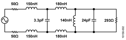

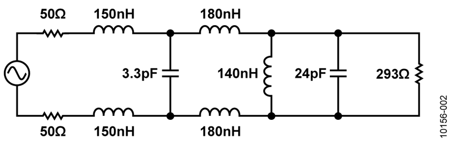

The fifth-order Butterworth filter is designed with a source impedance of 100Ω, a load impedance of 293Ω, a 1dB bandwidth of 75MHz, and a 3dB bandwidth of 110MHz. The final circuit values ​​of the filter are shown in Figure 2. The values ​​chosen for the filter passive components are the closest standard values ​​to the program-generated values. The ADC's internal 2.2pF capacitor is used as part of the final shunt capacitor in the filter design. This shunt capacitance at the ADC input helps reduce kickback charge current in the ADC input sampling network and optimizes filter performance.
Figure 2. Final design values ​​for fifth-order differential Butterworth filter, Z S = 100 Ω, Z L = 293 Ω, f C = 182.5 MHz

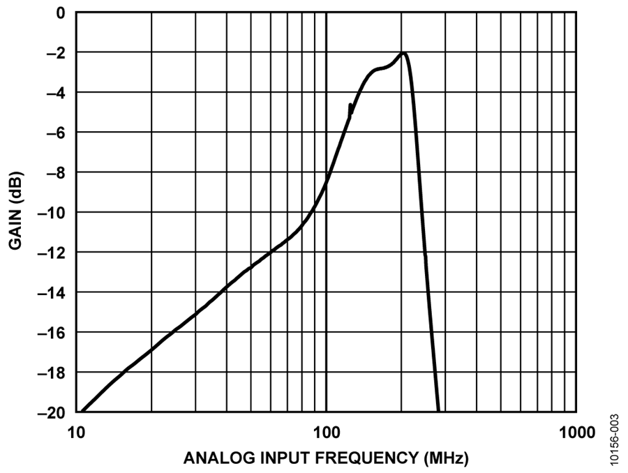

Figure 3 shows the bandwidth response of the final filter circuit, and Figures 4 and 5 show the SNR and SFDR performance.
Figure 3. Passband Flatness Performance vs. Analog Input Frequency

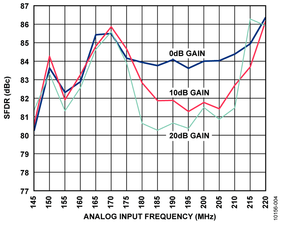

Figure 4. SFDR performance versus analog input frequency (0 dB gain, 10 dB gain, and 20 dB gain)

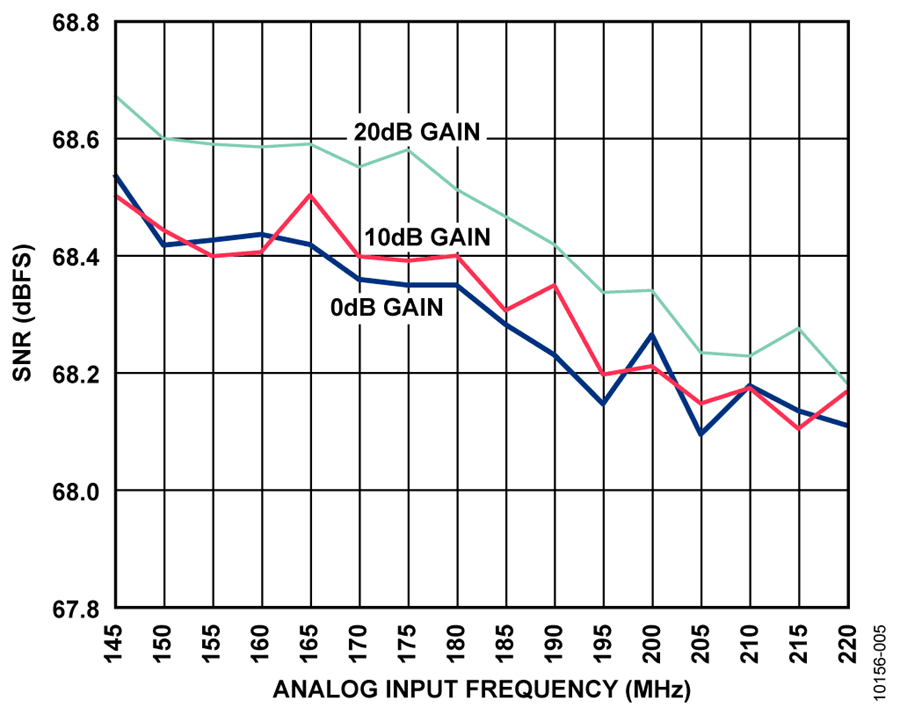

Figure 5. SNR performance versus analog input frequency (0 dB gain, 10 dB gain, and 20 dB gain)

The SFDR performance of this design depends on two factors: amplifier and ADC interface component values, as shown in Figure 1. The final SFDR performance numbers shown in Table 1 and Figure 4 are obtained after optimizing the filter design, taking into account the board parasitic capacitance and non-ideal components used in the filter design.
Another factor that can be weighed in this particular design is the ADC full-scale range setting. For the data obtained with this design, the full-scale ADC differential input voltage was set to 1.75 V pp, which optimizes SFDR. Changing the full-scale input range to 2.0 V pp slightly improves SNR, but the SFDR performance is slightly degraded. Changing the full-scale input range in the opposite direction to 1.5 V pp slightly improves SFDR, but SNR performance is slightly degraded.
