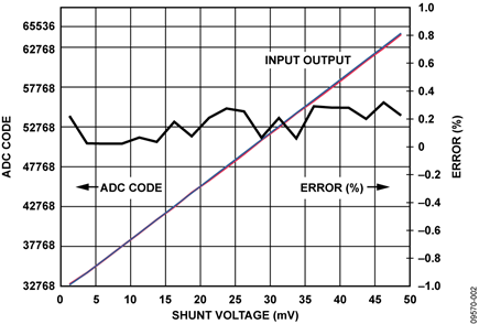

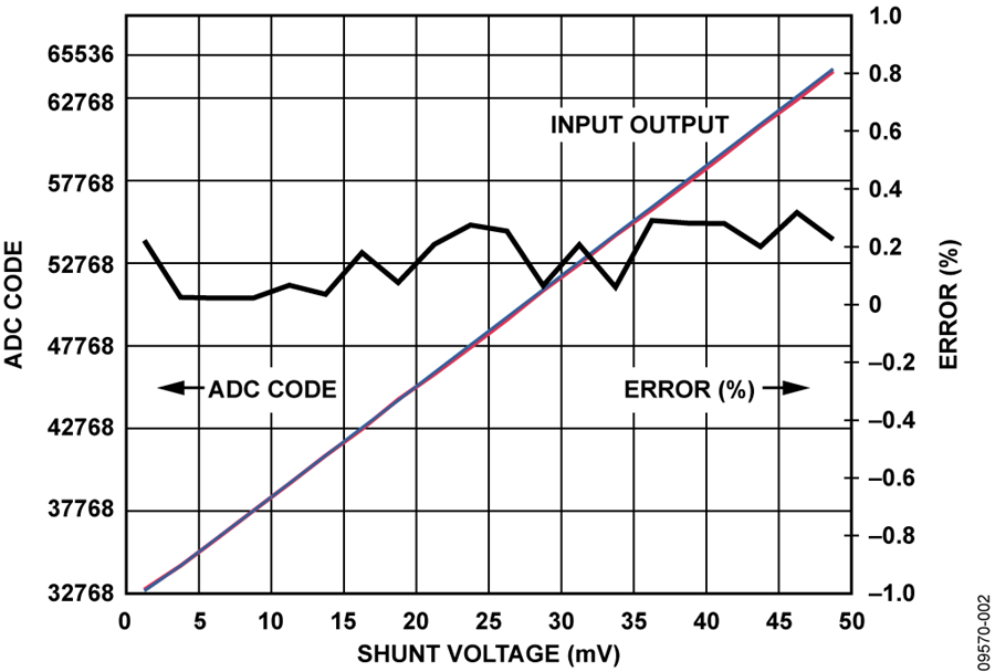

Figure 2. Output Sum Error vs. Shunt Voltage

The graph in Figure 2 shows that the circuit under test achieved an error of 0.3% over the entire input voltage range (0 mV to 50 mV). In addition, the ADC output code recorded by LabVIEW was compared with the ideal code calculated based on the ideal system.
In order to calculate this ideal code, several assumptions must be made regarding system performance. First, the op amp stage must amplify the input signal exactly 49.7 times. This value varies by 2% in the worst case, depending on the resistor tolerance (1%). Second, assume that the current sink resistor (R5) is exactly the same as the ADC input resistor (R7). In this circuit, the tolerance of these resistors is 1%. Since they have the same value, the matching accuracy is probably better than 1%. It is also possible to use lower tolerance resistors, which will increase the accuracy and cost of the circuit.
