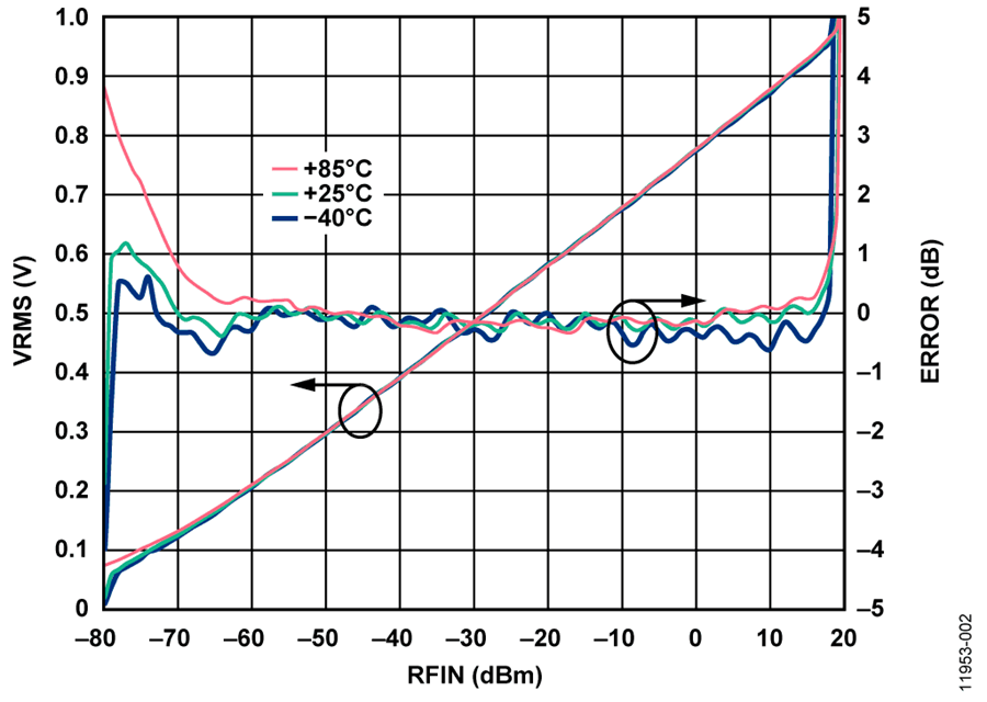

Figure 2 shows the transfer function obtained when the input power is swept at 167 MHz. The best linearity is obtained using a 4-point calibration method, with the calibration points being: +15 dBm, −15 dBm, −55 dB and −70 dBm. The 2-point calibration method can also be used, but the linearity will decrease within the input power range.

Figure 2. 95 dB RMS response RF detector transfer function (measured at 167 MHz)

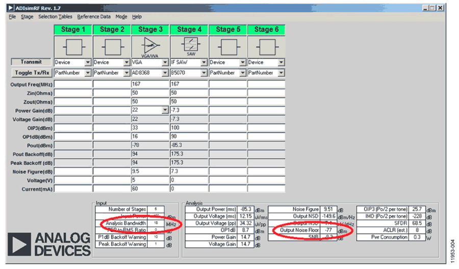

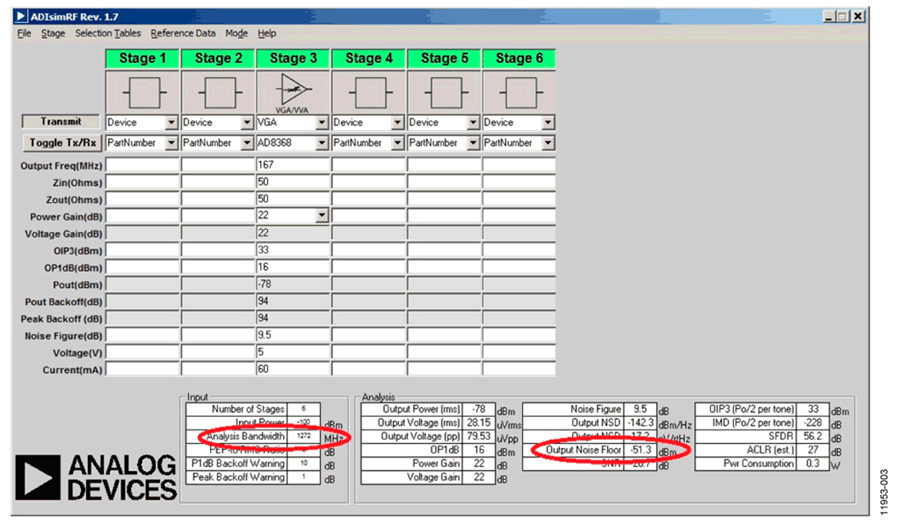

To obtain the excellent sensitivity in Figure 2, a narrowband filter must be placed between the VGA and detector, as shown in Figure 1. Without the filter, the wideband output noise of the AD8368 would overwhelm the low-end sensitivity characteristics of the ADL5902. Figure 3 shows a screenshot of the AD8368 output noise calculation using ADIsimRF . The AD8368VGA has maximum gain when there is a minimum input signal. If the 3 dB bandwidth is 800 MHz and assuming first-order roll-off, then use the 1272 MHz equivalent noise bandwidth (i.e., 800 MHz times 1.57) to calculate the VGA's output noise power. This results in an output noise power level of approximately −51 dBm, which is approximately 10 dB above the nominal input sensitivity of the ADL5902. Therefore, in order to achieve maximum low-end sensitivity, some degree of filtering is necessary.
Figure 4 shows the same noise calculation after adding an EPCOS B5070 SAW filter with a center frequency of 167 MHz to the circuit. In this calculation, the analysis bandwidth is reduced to the same as the SAW filter bandwidth (18 MHz).
Because the noise bandwidth is significantly reduced and the filter insertion loss is 7.3 dB, the integrated output noise of the VGA/SAW combination drops significantly to −77 dBm, which is much lower than the input sensitivity of the ADL5902RMS detector. This ensures that circuit performance is not limited by noise when the VGA gain is maximum.
Figure 3. Calculation of AD8368VGA output noise using ADIsimRF (gain at maximum)
Figure 4. Calculation of AD8368VGA output noise using ADIsimRF (using a 167 MHz SAW filter with an 18 MHz bandwidth)
