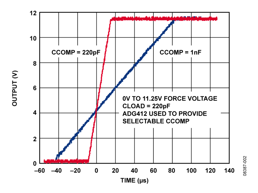

Some applications require the PMU to be able to drive various sizes of DUT capacitors, especially in applications where the PMU is connected to a power supply pin, or where the PMU is used as a device power supply and the DUT's decoupling/bypass capacitance is present. In this case, connecting an external switch to the CCOMP pin instead of a fixed capacitor allows the additional CCOMP capacitor to be turned on or off, optimizing settling time and stability under various capacitive load conditions. The switch selected for this circuit is the four-channel SPST switch ADG412, whose on-resistance is less than 50 Ω. Since most multiplexers only allow one of multiple channels to be on at a time, a four-channel SPST switch was chosen instead of a multiplexer. With a four-channel switch, the drains can be connected together and the sources can be connected to compensation capacitors, providing 24 − 1 possible CCOMP combinations.
Likewise, this circuit uses the ADG1209 differential multiplexer to accommodate a wider range of feedforward capacitances connected to the CFFx pins, allowing the AD5522 to drive a wider range of DUT capacitances. Use a multiplexer with series resistance such that 1/(2π × R ON × C DUT ) > 100 kHz. In this example, the ADG1209 is used to switch the two channels of the AD5522.
The switch and capacitor will experience a voltage offset within the same voltage range as the AD5522 FOH pin. Therefore, the voltage ratings of switches and capacitors should take this into account. CFF capacitors can have tolerances of 10% or less, and this additional variable directly affects settling time, especially in current mode when measuring low currents. The selected CCOMP capacitor tolerance should be no greater than 5%. Table 1 lists the recommended nominal values ​​of the compensation capacitors CCOMP and CFF for different load capacitances.

Figure 2: Output voltage step response for different CCOMP values ​​(forced voltage step to 11.25 V, load 220 pF, using ADG412 SPST switch)

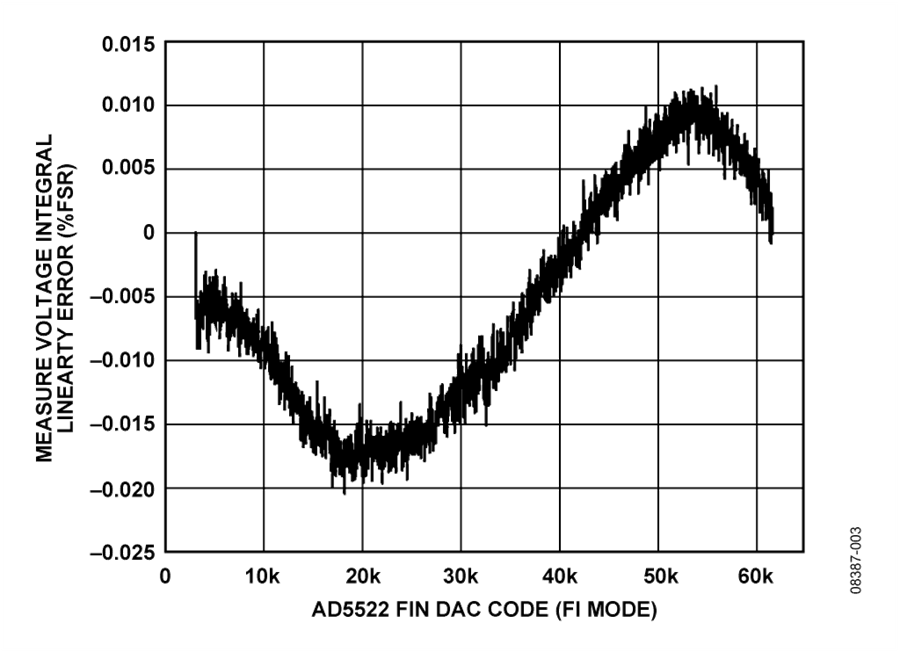

Figure 3: Integral linearity performance (FIMV error measured using AD7685, FI range = ±2 mA, measured output gain = 0.2)

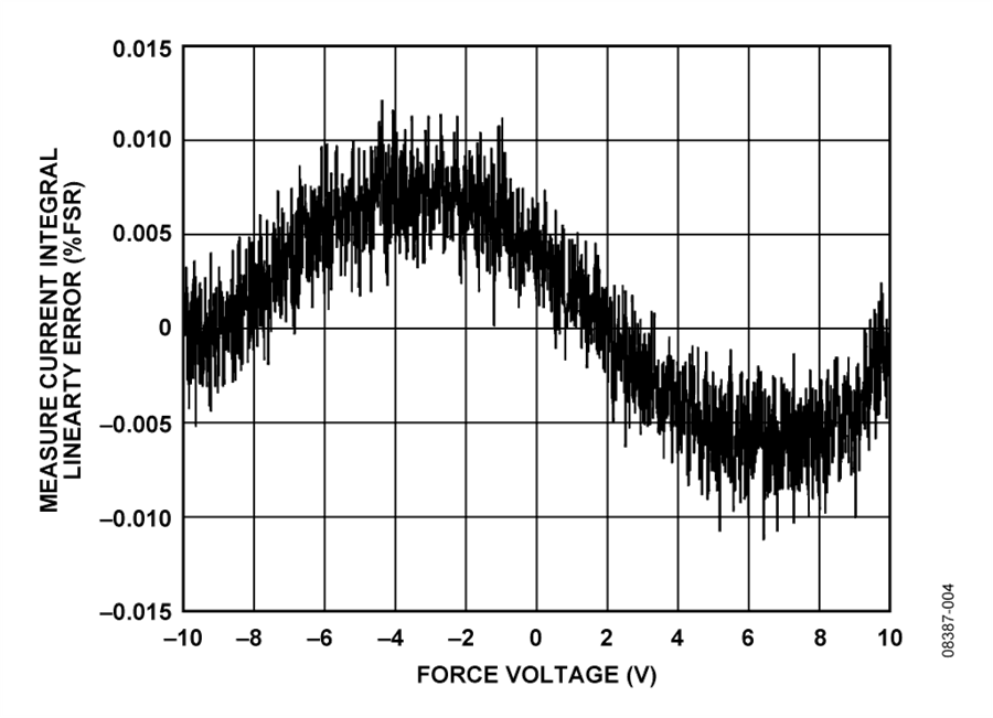

Figure 4: Integral linearity performance (FVMI error measured using AD7685, FV range = ±10 V, 2 mA range, 5.6 kΩ load)

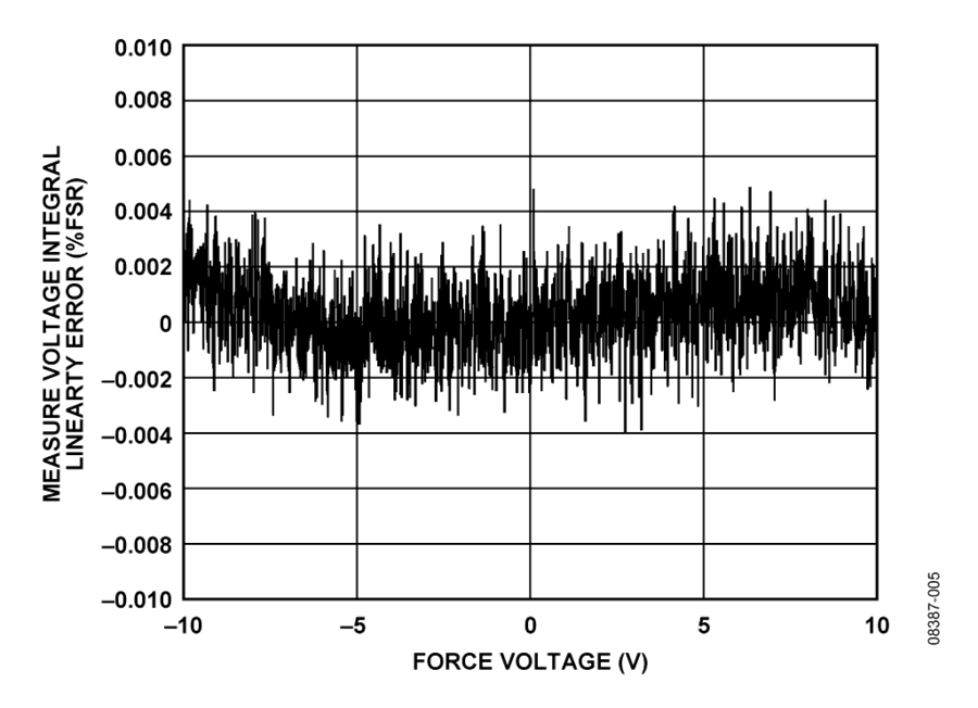

Figure 5: Integral linearity performance (FVMV error measured using AD7685, FV range = ±10 V, measured output gain = 0.2)

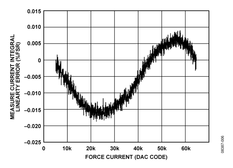

Figure 6: Integral linearity performance (FIMI error measured using AD7685, FI range = ±2 mA, measured output gain = 0.2)
