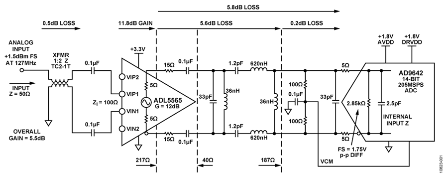

This circuit accepts a single-ended input and converts it to a differential signal using a wide bandwidth (3 GHz) Mini-Circuits TC2-1T 1:2 transformer. The 6 GHz differential amplifier ADL5565 has a differential input impedance of 200 Ω when operating at 6 dB gain and 100 Ω when operating at 12 dB gain. It also offers a 15.5 dB gain option.
The ADL5565 is an ideal driver for the AD9642, enabling a fully differential architecture in the ADC via bandpass filters, providing good high-frequency common-mode rejection while minimizing second-order distortion products. Depending on the input connection, the ADL5565 provides 6dB or 12dB of gain. This circuit uses a gain of 12dB to compensate for the insertion loss of the filter network and transformer (approximately 5.8dB), resulting in a total signal gain of 5.5dB.
Figure 1. 14-bit, 250 MSPS wideband receiver front-end (schematic: all connections and decoupling not shown) Gain, loss, and signal level measured at 127 MHz input frequency
An input signal of 1.5 dBm produces a 1.75 V pp full-scale differential signal at the ADC input.
The anti-aliasing filter is a third-order Butterworth filter designed using standard filter design procedures. The Butterworth filter was chosen for its passband flatness. The AC noise generated by the third-order filter has a bandwidth-to-noise ratio of 1.05 and can be designed with the help of a variety of free filter programs, such as Nuhertz Technologies Filter Free or Quite Universal Circuit Simulator (Qucs) Free Simulation.
For best performance, the ADL5565 should be loaded with a net differential load of 200 Ω. The 15Ω series resistor isolates the filter capacitor from the amplifier output, and the 100Ω resistor is in parallel with the downstream impedance, resulting in a net load impedance of 217Ω when a 30Ω series resistor is added.
A 5Ω resistor in series with the ADC input isolates internal switching transients from the filter and amplifier.

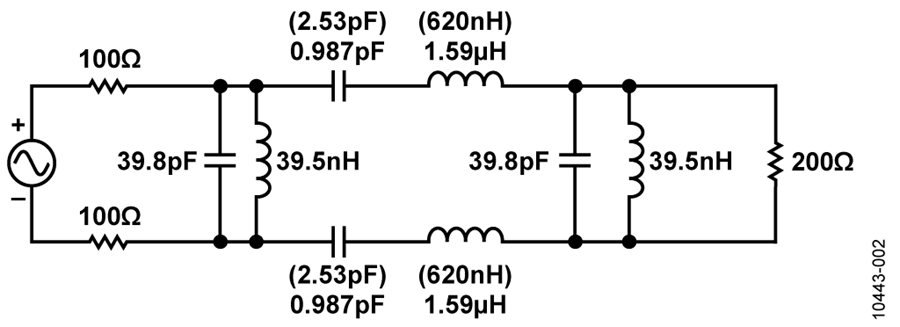

The third-order Butterworth filter is designed with a source impedance (differential) of 200Ω, a load impedance (differential) of 200Ω, a center frequency of 127MHz, and a 3dB bandwidth of 20 MHz. The values ​​calculated by a standard filter design program are shown in Figure 1. Since a larger series inductance is required, the 1.59 μH inductor is reduced to 620nH, and the 0.987pF capacitance is scaled up to 2.53 pF, thus leaving the 127 MHz resonant frequency unchanged and making the component values ​​more realistic.
Figure 2. Beginning third-order differential Butterworth filter design, ZS = 200 Ω, ZL = 200 Ω, FC = 127 MHz, BW = 20 MHz
The value of the second parallel capacitor is subtracted from the ADC's 2.5 pF internal capacitance, resulting in a value of 37.3 pF. In this circuit, the capacitor is placed near the ADC to reduce/absorb charge kickback.
The values ​​chosen for the final filter passive components (after adjusting for actual circuit parasitics) are shown in Figure 1. Table 1 summarizes the measured performance of the system with a 3 dB bandwidth of 18 MHz centered at 127 MHz. The total insertion loss of the network is approximately 5.8 dB. Figure 3 shows the frequency response; Figure 4 shows the SNR and SFDR performance.

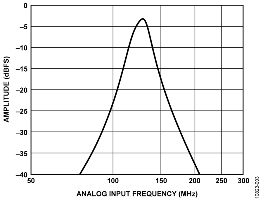

  Passband Flatness (118 MHz to 136 MHz)  3dB

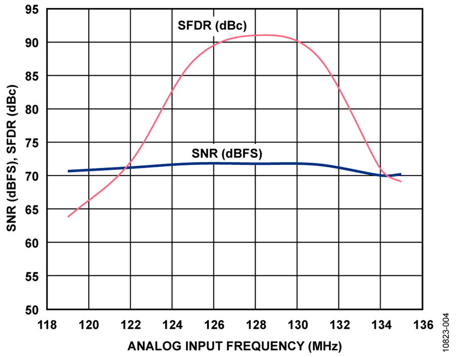

  SNRFS at 127 MHz  71.7dBFS
  SFDR at 127 MHz  92 dBc
  H2/H3 at 127 MHz  93dBc/92dBc

Figure 3. Passband Flatness Performance vs. Frequency
Figure 4. SNR/SFDR performance versus frequency, sample rate = 205 MSPS
