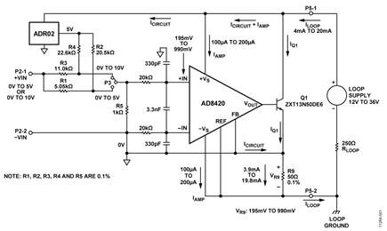

The circuit shown in Figure 1 is a configurable 4 mA to 20 mA loop-powered transmitter based on an industry-leading micropower instrumentation amplifier. The total error without adjustment is less than 1%. A switch can be used to configure either a transmitter that converts a differential input voltage to a current output (Figure 1) or a receiver that converts a 4 mA to 20 mA current input to a voltage output (Figure 5).
The design is optimized for precision, low noise and low power industrial process control applications. When operating as a transmitter, the circuit can accept input voltages from 0 V to 5V or 0 V to 10 V. When used as a receiver, it can provide an output voltage of 0.2 V to 2.3 V or 0.2 V to 4.8 V, compatible with ADCs using 2.5 V or 5 V reference sources. The supply voltage range is 12 V to 36 V when operating as a transmitter and 7 V to 36 V when operating as a receiver.
Because the circuit is configurable, a single hardware design can serve as both a backup transmitter and a backup receiver, reducing customer inventory requirements.
Circuit description
The circuit is equipped with the AD8420 , an instrumentation amplifier based on an indirect current feedback architecture. Thanks to this architecture, the AD8420 has excellent input and output characteristics. Unlike traditional instrumentation amplifiers, the AD8420 can easily amplify signals at or just below ground without requiring dual power supplies. The AD8420 has a rail-to-rail output voltage swing that is completely independent of the input common-mode voltage. This frees the AD8420 from the limitations caused by the interaction between the common-mode input and output voltages found in most traditional instrumentation amplifier architectures. Flexible input and output features, coupled with micropower consumption (80 μA maximum at 0 V input) and wide supply range, make the AD8420 ideal for flexible, low-power industrial applications.
Transmitter configuration
Figure 1 shows a simplified circuit diagram of a 4mA to 20mA transmitter configuration. The circuit consumes only about 1 mA, making it ideal for loop-powered applications. The input range of the transmitter is 0 V to 5 V and 0 V to 10 V, selectable via jumper P3. Then, adjust the input voltage range to 0.195 V to 0.990 V because the differential input voltage of the AD8420 is limited to ±1 V.
The input of the AD8420 has a differential mode noise filter (40 kΩ/3.3 nF) with a bandwidth of 1.2 kHz and a common mode noise filter (20 kΩ/330 pF) with a bandwidth of 24 kHz.
The AD8420's indirect current feedback architecture forces the amplifier's differential input voltage to appear between its FB and REF pins. Transistor Q1 then converts the voltage range of 0.195 V to 0.990 V into a current of 3.9 mA to 19.8 mA flowing through the R9 50 Ω sense resistor.
The current through the R9 sense resistor includes the circuit current and the Q1 current, but does not include the AD8420 current I AMP .
The AD8420's unique architecture makes its supply current predictable, ranging from 100 μA to 200 μA when an input voltage of 0.195 V to 0.990 V is applied between +IN and −IN. This supply current increases the current through R9, increasing the total output loop current to 4 mA to 20 mA. Therefore, the total current in the loop is given by:

The loop supply voltage is also limited to 36 V (maximum). An advantage of the AD8420 is its high-impedance reference pin, which does not require an additional op amp to be driven, thereby reducing power, cost, and space requirements in the transmitter circuit. For the loop to function properly, board ground and loop ground must not be connected unless R9 (50 Ω sense resistor) is required.

The differential input voltage range of the AD8420 is limited to ±1V (max). Therefore, in order to accept the higher industrial input voltage range, the circuit uses a trim resistor network to convert the 0 V to 5 V or 0 V to 10 V input to 0.195 V to 0.990 V. The following equations use nodal analysis to find the values ​​of R1, R2, R3, and R4 in the circuit:

The resistors provided with the EVAL-CN0314-EB1Z board are as follows: In the actual circuit, the 0.1% resistor closest to the EIA standard must be selected, so a fixed offset error can be obtained.

For a 0 V to 5 V input, VREF = 5 V, R1 = 5.05 kΩ, R2 = 20.5 kΩ, and R5 = 1 kΩ.
