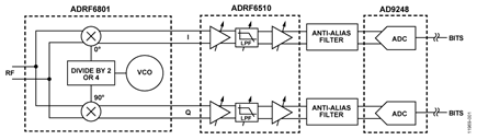

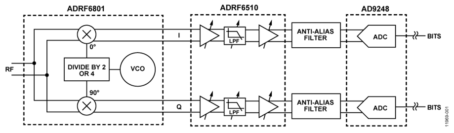

Figure 1. Direct conversion receiver schematic (all connections and decoupling not shown)

Figure 1 shows the basic schematic of the system, which consists of an integrated quadrature demodulator consisting of a fractional-N PLL and a VCO, followed by a programmable low-pass filter with variable baseband gain. The final part of the signal chain is an anti-aliasing filter and a dual-channel ADC.
Ideally, the input of the first stage and the output of the last stage should set the dynamic range (signal-to-noise ratio) of the system. In reality, this may not be the case.
IQ demodulator, fractional-N PLL and VCO
The input signal is applied to the ADRF6801 quadrature demodulator, which converts the frequency to zero IF. ADRF6801 integrates an on-chip frequency synthesizer to provide the required LO signal. The frequency synthesizer consists of a fractional-N PLL and VCO, providing an LO frequency range of 750 MHz to 1150 MHz in standard closed-loop mode.
The ADRF6801 uses two double-balanced mixers, one for the I channel and one for the Q channel. The LO provided to the mixer is generated using a divide-by-2 quadrature phase splitter. This provides the 0° and 90° signals for the I and Q channels respectively. The ADRF6801 provides approximately 5 dB of conversion gain from the RF input to the baseband I and Q outputs.

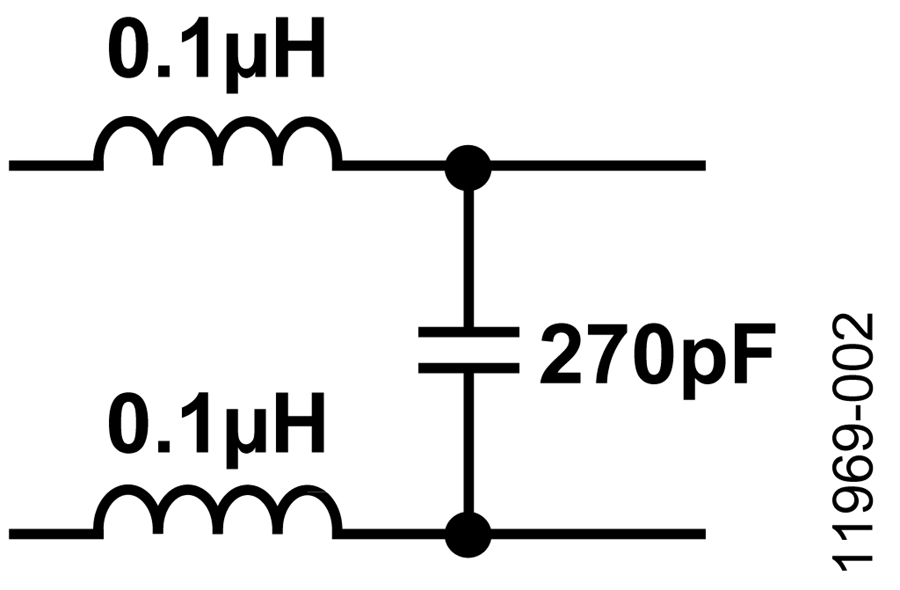

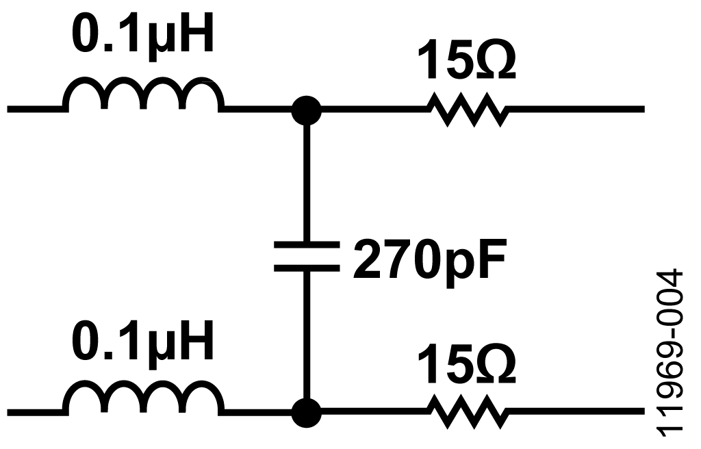

The anti-aliasing filter is a low-pass filter designed to have a corner frequency range of approximately 30 MHz to 120 MHz. If the spectral content of the signal is known to be below 30 MHz, then a lower corner frequency can be selected.

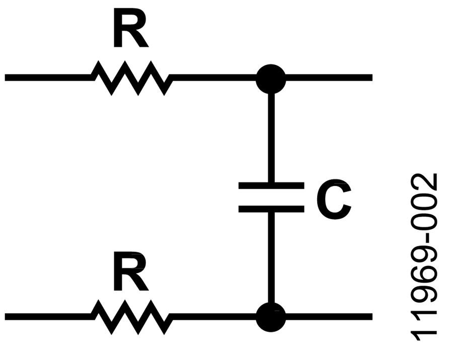

A total of 5 anti-aliasing filters were tested in the system. The anti-aliasing filters tested in the first three tests were differential RC types, as shown in Figure 2. Filter 1 has R = 33, C = 18 pF. This results in a low-pass corner frequency of approximately 134 MHz.
Figure 2. Antialiasing filters (Filters 1, 2, and 3)
Filter 2 has R = 33 Ω and C = 39 pF, so the low-pass corner frequency is 62 MHz. Finally, filter 3 has R = 33 Ω and C = 68 pF, so the corner frequency is 35.5 MHz. Filter 4 in Figure 3 is an LC filter with a corner frequency of 33 MHz; Filter 5 in Figure 4 is an RLC filter with a corner frequency of 33 MHz.
Figure 3. Anti-aliasing filter 4
Figure 4. Anti-aliasing filter 5

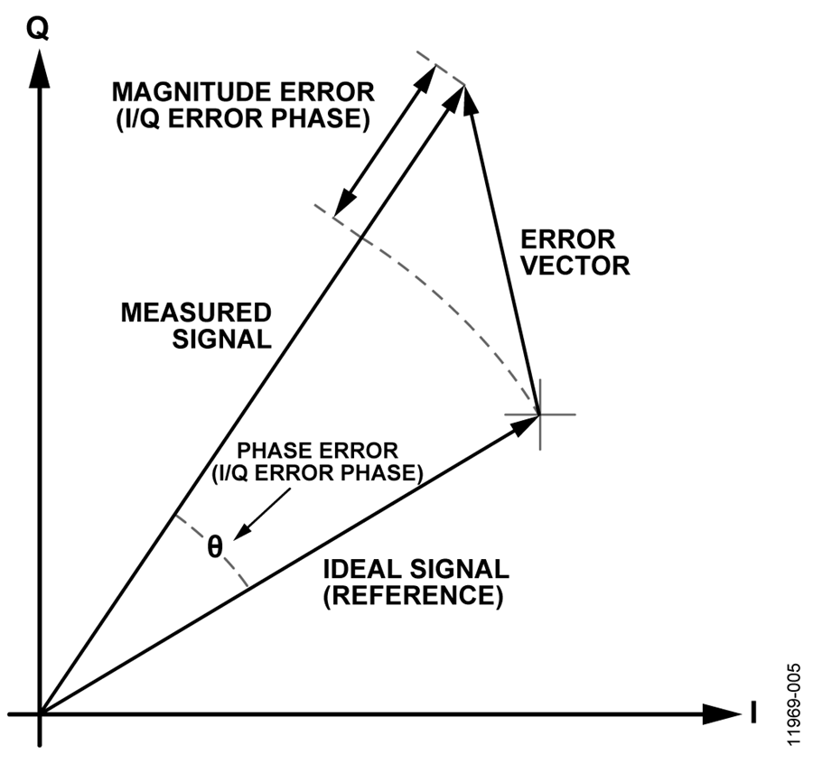

A 5 MSPS modulated signal is applied to the input of the ADRF6801 quadrature demodulator, and the error vector magnitude (EVM) is measured. Use two AD8130-EBZ evaluation boards to convert the differential output signals of the ADRF6801 and ADRF6510 to single-ended signals. For more information on test setup, see the "Circuit Evaluation and Testing" section.
EVM is a measure of the performance quality of a digital transmitter or receiver, reflecting the deviation of actual constellation points from their ideal positions caused by amplitude and phase errors, as shown in Figure 5.
Figure 5. EVM diagram

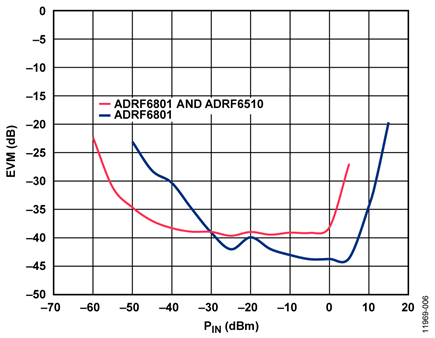

Figure 6 shows EVM versus ADRF6801 input power using only the ADRF6801 and the ADRF6801 followed by the ADRF6510. For the ADRF6801 and ADRF6510 curves, the sweep is the ADRF6510 gain change required to maintain a 1.5 V pp output voltage as the ADRF6801 input power. The preamplifier gain applied to the ADRF6510 is set to 6 dB.
Figure 6. EVM versus combined ADRF6801 and ADRF6801/ADRF6510 input power.
When testing the ADRF6801 alone, note that for high input signal levels, EVM does not decrease until approximately +5 dBm input power is reached. But when the ADRF6801 drives the ADRF6510, the EVM will start to decrease at about 0 dBm input power. This is because the low-pass filter on the ADRF6510 can only handle 2 V pp when the preamp gain is set to 6 dB and the analog gain is at minimum, which is 1 V pp at the ADRF6510 input pin. Exceeding this signal level will cause distortion, causing EVM to drop.
For low input signal levels, the SNR becomes even lower and the EVM measurements start to degrade. When testing the ADRF6801 alone, EVM will begin to decrease at approximately −25 dBm. However, when the ADRF6801 drives the ADRF6510, EVM does not begin to decrease until −40 dBm. There is a decrease in EVM when measuring both devices at lower signal levels, primarily caused by noise generated by the ADRF6510. However, the noise floor of the bathtub plot is flatter and more consistent, and because of the baseband variable gain, the ability to resolve smaller signals is much better than when the ADRF6801 drives the ADRF6510.

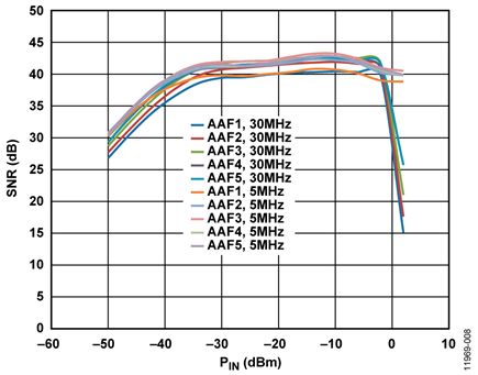

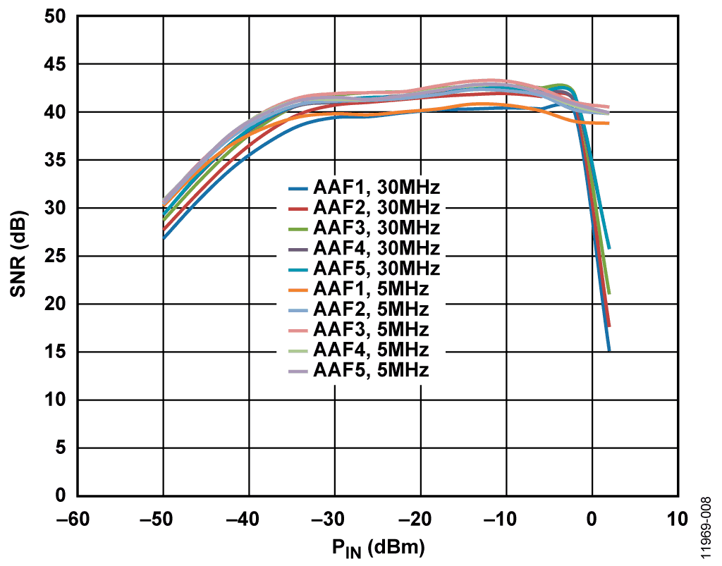

Figures 7 and 8 show the SNR of the entire signal chain, including the ADC. At low power levels, the SNR drops almost dB by dB. The ADRF6510 has maximum gain and cannot continue to provide −3 dBFS at lower input power levels. The signal amplitude decreases while the noise remains relatively constant; therefore, the SNR decreases. The SNR reaches a constant level when the signal and gain are sufficient to reach −3 dBFS. The best SNR is obtained using anti-aliasing filter 3, although the spread is only about 1 dB across all filters except anti-aliasing filter 1, which makes the SNR worse compared to the rest.
When the ADRF6510 filter is set to 30 MHz, the SNR drops significantly at the highest input power, as shown in Figure 8. This is because the compression of the ADRF6510 filter causes a sudden drop in HD2 and HD3, while the overall noise floor increases dramatically.
Figure 7. System SNR for 5 anti-aliasing filters (ADRF6510 filter corner frequencies 30 MHz and 5 MHz, 5 MHz IF tone, GNSW = low level, front-end gain = 6 dB)
Figure 8. System SNR for 5 anti-aliasing filters (ADRF6510 filter corner frequencies 30 MHz and 5 MHz, 5 MHz IF tone, GNSW = high level, front-end gain = 12 dB)

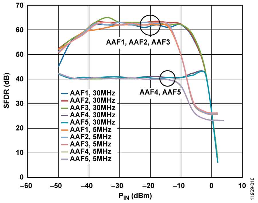

Figures 9 and 10 show the SFDR of the entire system when using different anti-aliasing filters. Filter 4 and Filter 5 perform very poorly, with an SFDR of 40 dB over most of the input power range. This is because HD3 tone limits SFDR. For other anti-aliasing filters, SFDR exceeds 60 dB over most ranges. Since the main signal tone is not −3 dBFS, the SFDR decreases slightly when the input power is low.
At higher input power levels, the SFDR is limited by the harmonics generated by the compression of the ADRF6510 filter.
Figure 9. System SFDR for 5 anti-aliasing filters (ADRF6510 filter corner frequency 30 MHz and 5 MHz IF tone, GNSW = low level, front-end gain = 6 dB)
Figure 10. System SFDR for 5 anti-aliasing filters (ADRF6510 filter corner frequencies 30 MHz and 5 MHz, 5 MHz IF tone, GNSW = high level, front-end gain = 12 dB)

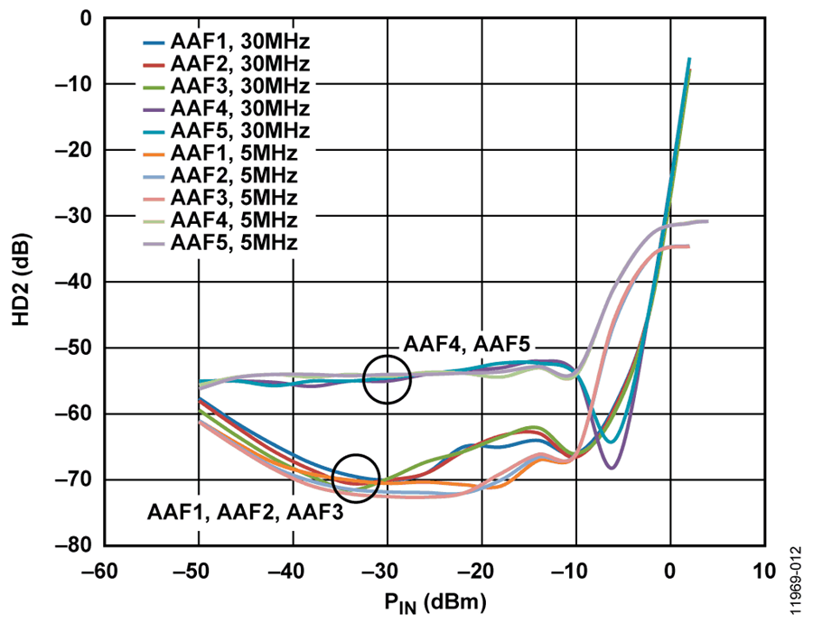

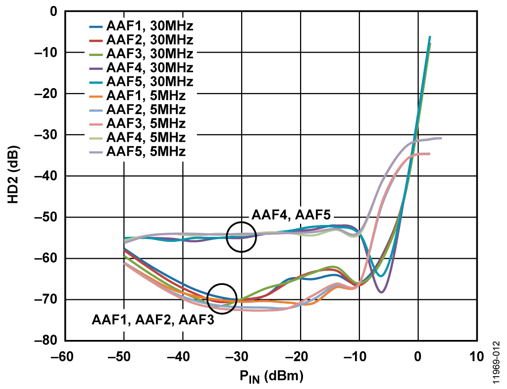

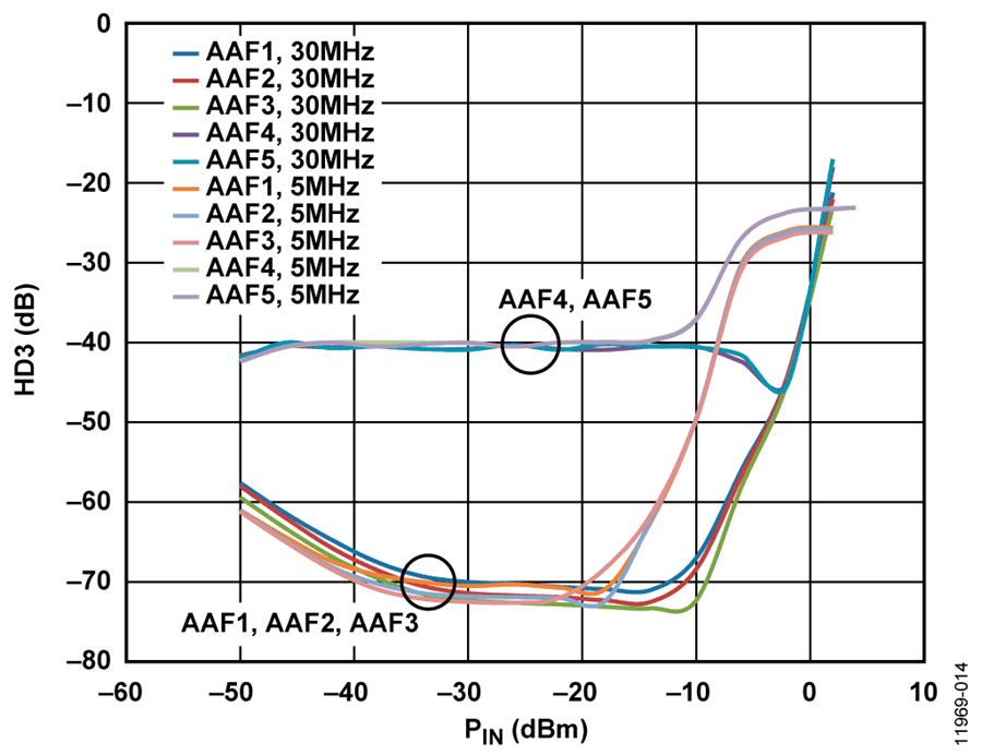

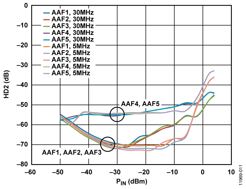

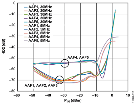

Figure 11, Figure 12, Figure 13 and Figure 14 show HD2 and HD3 of the system. Anti-aliasing filters 4 and 5 again show poorer performance, with HD2 performance around −55 dBc and HD3 only −40 dBc. Filters 1, 2, and 3 perform much better, with HD2 and HD3 better than −70 dBc.
At the low end of the input power range, the HD2 and HD3 components are smaller than the noise floor, and what is actually recorded is noise. After the gain of the ADRF6510 is reduced low enough, the output noise decreases and exhibits an HD signal tone, allowing appropriate measurements.
At the high end of the input power range, HD2 and HD3 drop off significantly. This is caused by the compression of the ADRF6510 filter.
Figure 11. System HD2 with 5 anti-aliasing filters (ADRF6510 filter corner frequencies 30 MHz and 5 MHz, 5 MHz IF tone, GNSW = low level, front-end gain = 6 dB)
Figure 12. System HD2 with 5 anti-aliasing filters (ADRF6510 with filter corner frequencies of 30 MHz and 5 MHz, 5 MHz IF tone
Figure 13. System HD3 with 5 anti-aliasing filters (ADRF6510 filter corner frequencies 30 MHz and 5 MHz, 5 MHz IF tone, GNSW = low level, front-end gain = 6 dB)
Figure 14. System HD3 with 5 anti-aliasing filters (ADRF6510 with filter corner frequencies of 30 MHz and 5 MHz, 5 MHz IF tone, GNSW =

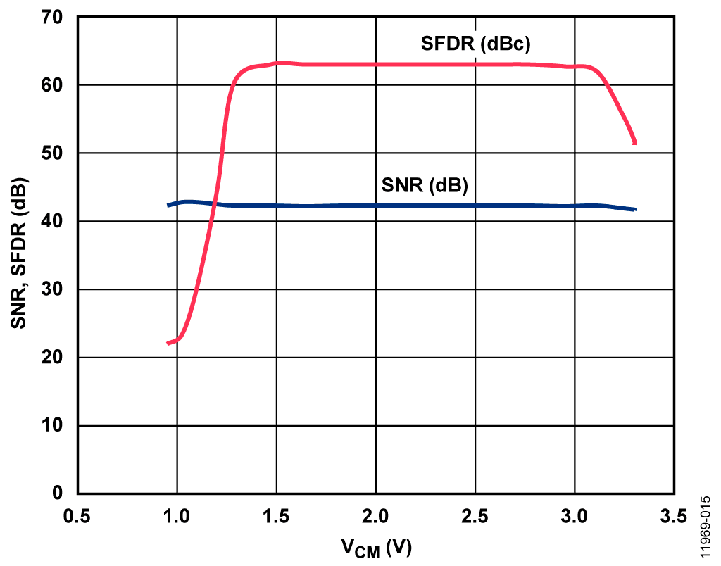

common mode scan

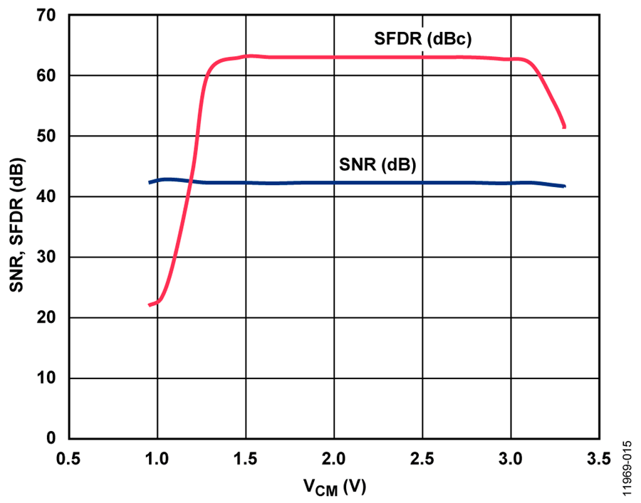

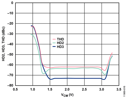

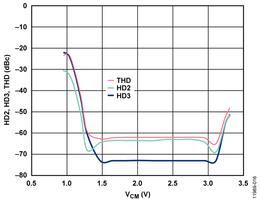

It is possible to use common-mode voltages other than 2 V between the output of the ADRF6510 and the input of the AD9248 while maintaining good performance.
Figures 15 and 16 show all standard specifications for common mode scanning. The system has good performance with common-mode voltages ranging from 1.5 V to 3 V. The performance degradation at low common-mode voltages is primarily caused by the ADRF6510, while the performance degradation at high common-mode voltages is caused by the combination of the ADRF6510 and AD9248. For the ADRF6510/AD9248, best performance is obtained by setting the common-mode voltage to 2.25 V.
Figure 15. System SNR and SFDR versus ADRF6510 output common-mode voltage (ADRF6510 filter corner frequency 30 MHz, 5 MHz IF tone, GNSW = high level, front-end gain = 6 dB)
Figure 16. Relationship between system HD2, HD3 and THD and ADRF6510 output common mode voltage (ADRF6510 filter corner frequency is 30 MHz, 5 MHz IF signal tone
