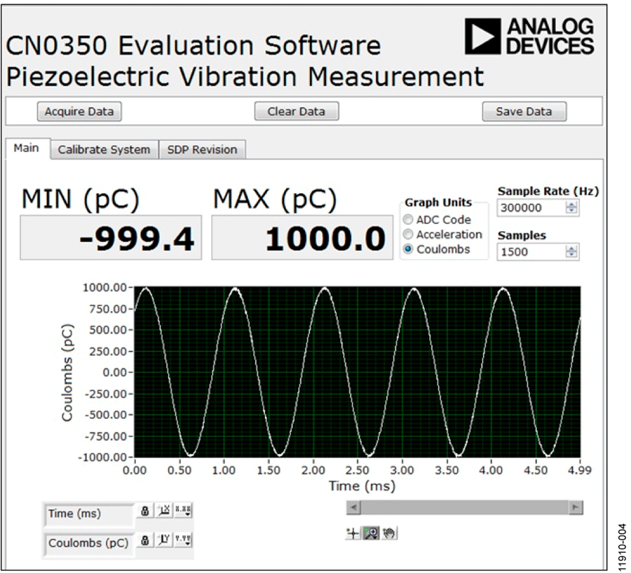

Figure 4 shows the ADC output measured with a 1V 1 kHz sine wave input and CSIM = 1 nF. Therefore, the charge input is ±1000 pC.
Figure 4. ADC output at ±1000 pC input charge, 1 kHz sine wave
