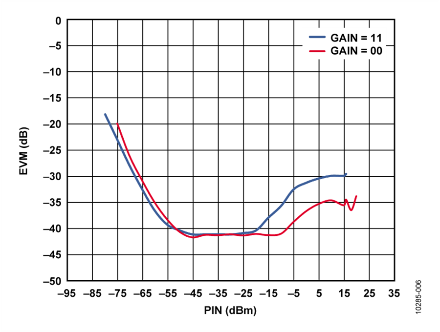

EVM is a measure of the performance quality of a digital transmitter or receiver, reflecting the deviation of actual constellation points from their ideal positions due to amplitude and phase errors. as shown in picture 2.

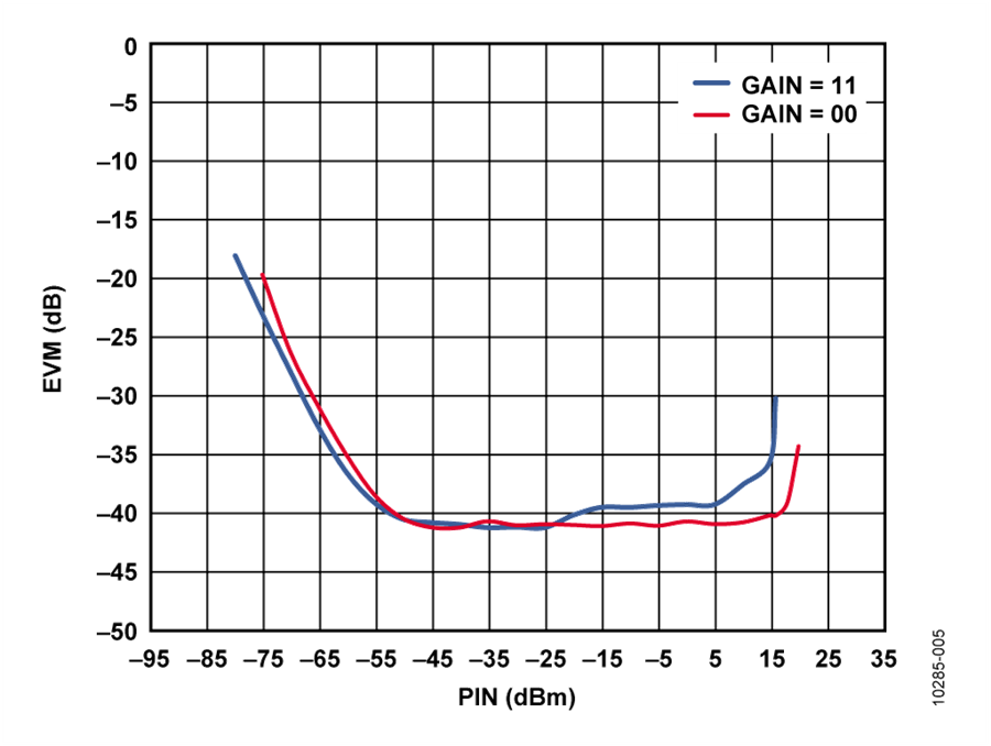

Figure 3 shows system EVM versus ADL5336 input power with the maximum gain on VGA set to 15.2dB for VGA1 and 19.5dB for VGA2.

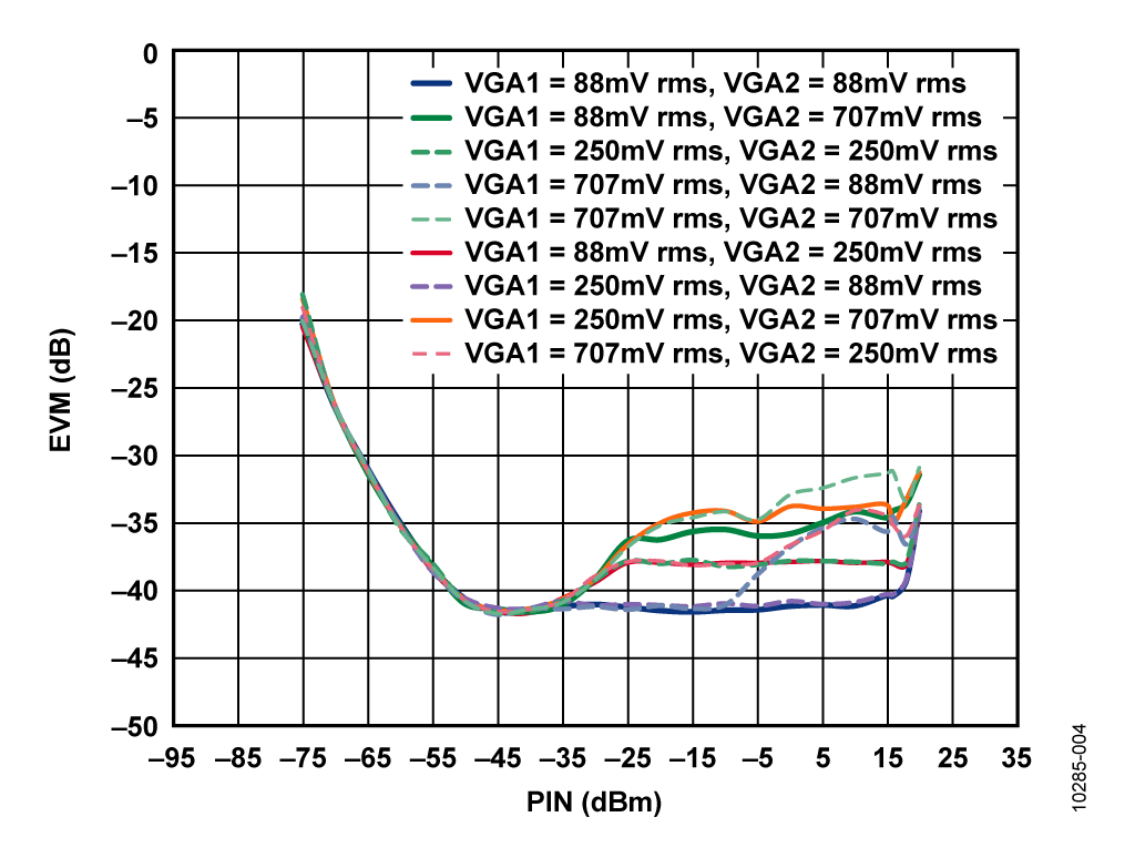

Several AGC set point combinations were tested. Figure 4 is also the relationship between system EVM and ADL5336 input power; however, the VGA gains are set to 9.7dB and 13.4dB respectively. The same AGC set point combinations were tested.

Figures 3 and 4 illustrate that the signal level applied to the ADRF6510 must be kept low enough to avoid compressing the input stage and/or filter. At the highest AGC set points (500mVrms and 707mVrms), the input to the ADL5387IQ demodulator begins to compress and cause additional drops in EVM. Optimum EVM is achieved when the AGC set point is at its lowest point (88mVrms). When the set point is 250mVrms, EVM has started to decrease.

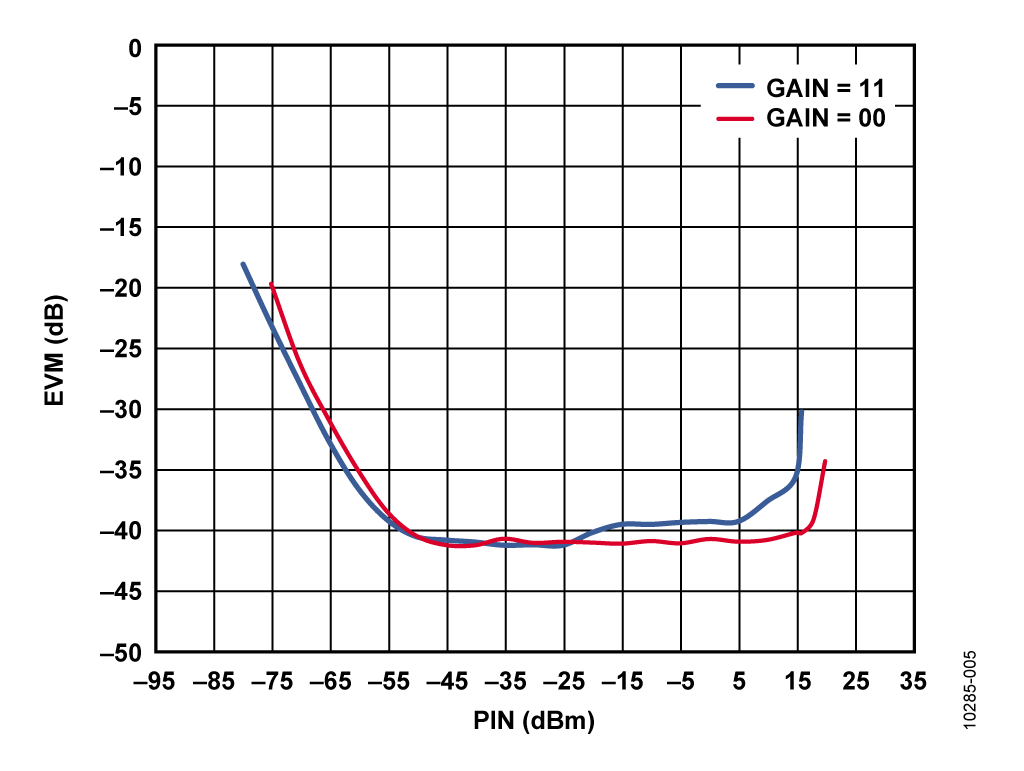

Figure 5 compares EVM between the minimum and maximum digital gain settings on the ADL5336VGA (VGA both set to gain code 11 or gain code 00), where the VGA1 and VGA2 set points are 250 mVrms and 88 mVrms, respectively.
Figure 5. System EVM, VGA1 set point = 250MVRMS, VGA2 set point = 88MVRMS
For a given AGC setpoint, when the maximum gain code is 11, the switch from VGA2 to VGA1 occurs after VGA2 has exceeded the gain range; therefore, the signal level applied to the ADRF6510 continues to increase (while the EVM decreases) until VGA1 reaches set point. Once VGA1 reaches the set point, the EVM flattens out again; therefore the signal level applied to the ADRF6510 does not change at an input power of approximately 5 dBm unless VGA1 goes out of the gain range. When the maximum gain code is set to 00, both VGAs provide more attenuation, thus allowing the VGA2 to shift the dynamic range so as not to hit the set point with input power as low as when the maximum gain code is 11. This allows VGA2 to remain at set point at higher input power, allowing VGA2 to VGA1 switching to occur before VGA2 goes out of gain range. This ensures that the signal level applied to the ADRF6510 remains at a constant value until the highest point of the input power range is reached.

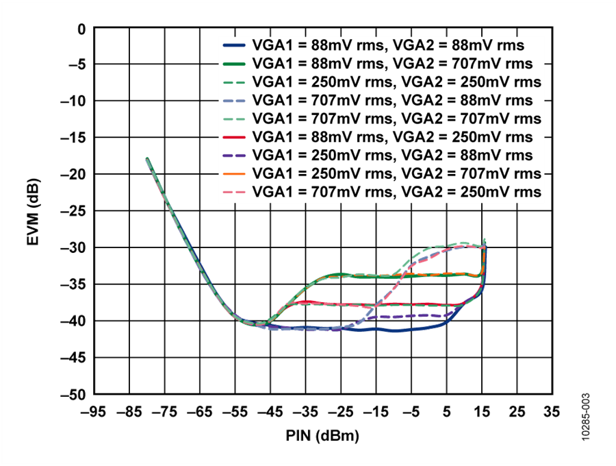

Figure 6 compares EVM between the minimum and maximum digital gain settings on the ADL5336 VGA (both VGAs set to gain code 11 or gain code 00); however, the VGA1 and VGA2 set points are 707mVrms and 88mVrms respectively.
Figure 6. System EVM, VGA1 setpoint = 707MVRMS, VGA2 setpoint = 88MVRMS
The dynamics in Figure 6 are the same as Figure 5, but more exaggerated. When the maximum gain code is 00, VGA2 reaches the set point at approximately -40dBm input power. It maintains the set point to about -10dBm, at which point VGA1 has not yet reached the set point of 707mVrms. VGA1 will not reach set point unless the input power is about 0dBm and the EVM starts to flatten slightly. The same thing happens again when the maximum gain is set to 11; however, VGA2 only maintains the set point to about -20dBm because no more gain is available to obtain the specified set point.
