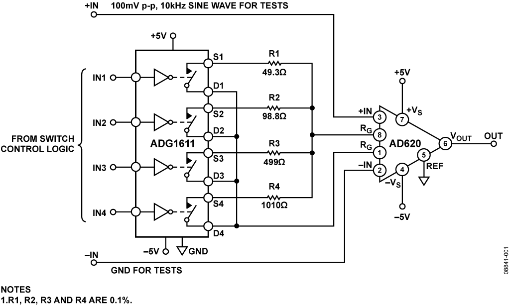

Figure 1. Programmable Gain Instrumentation Amplifier Circuit (Schematic Schematic: All connections and decoupling not shown)

Figure 1 shows the programmable gain instrumentation amplifier circuit, which consists of a ±5 V four-channel SPDT switch with ultra-low on-resistance R ON , the industry standard AD620 instrumentation amplifier, and four 0.1% standard resistors.
The ADG1611's ultra-low on-resistance makes it an ideal solution for gain switching applications where low on-resistance and low distortion performance are critical. The AD620 is a low-cost, high-precision instrumentation amplifier that requires only an external resistor RG on pins 1 and 8 to set the gain from 1 to 10,000.
Using the ADG1611 and AD620 combination, designers can control the gain of the AD620 by switching different gain setting resistors in R G. This circuit provides a low-power, low-cost programmable gain instrumentation amplifier solution.
The gain can be changed by selecting different combinations of switches S1, S2, S3 and S4 to change R G . Sixteen possible gain settings can be controlled through the ADG1611 parallel interface. The gain of the AD620 is programmed with a resistor between Pin 1 and Pin 8. The AD620 is designed to provide accurate gain using 0.1% to 1% tolerance resistors.
Its gain is easily calculated using the following equation:
CN0146_equation1

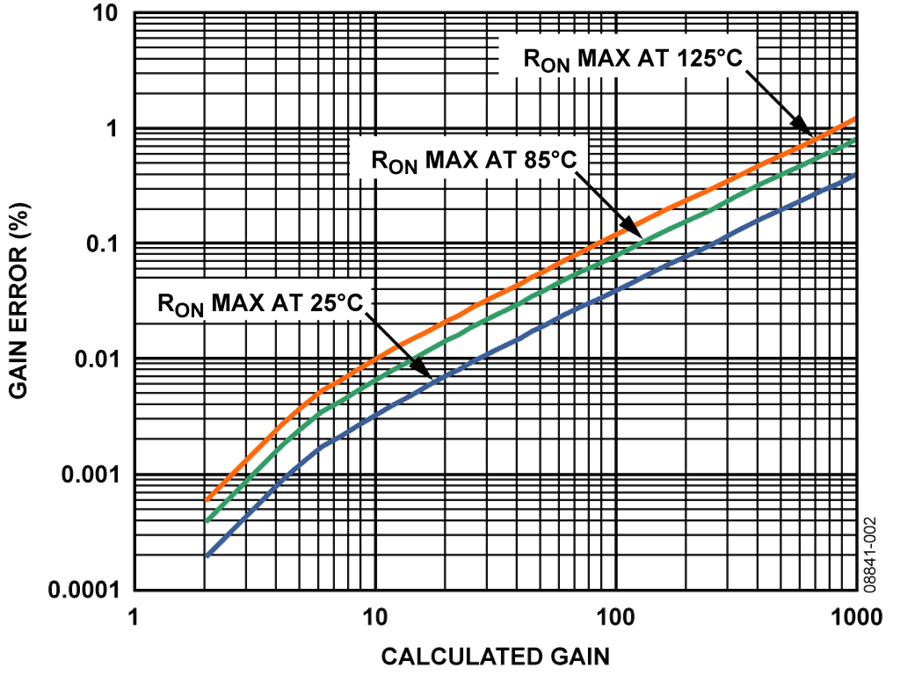

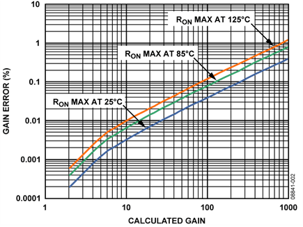

Figure 1 shows a circuit setup requiring gains of 1, 50, 100, 500, and 1000. Table 1 shows the control pins IN1 through IN4 of the ADG1611, which control the resistance between Pin 1 and Pin 8 of the ADG620. This circuit utilizes standard 0.1% resistors to achieve the gain settings below. The table also shows the gain obtained by adding the on-resistance of the ADG1611 to the signal chain and how temperature affects the gain. The ADG1611 switch has ultra-low on-resistance, which is ideal because R ON is much smaller than R ON and R ON changes very little with temperature. Figure 2 shows the gain error due to temperature changes in the ADG1611 R ON .
Figure 2. Gain error due to temperature changes in switch RON

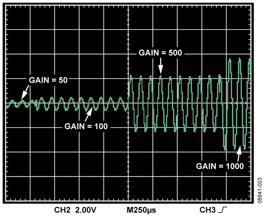

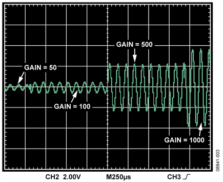

The test circuit in the lab includes an automatic switching mode that automatically switches the gain from 1 to 50, 100, 500, 1000 and back to 1.
Figure 3 shows the circuit waveforms when the gain is sequentially switched from 50 to 1000.
Figure 3. AD620 output showing gain switching sequentially from 50 to 1000
