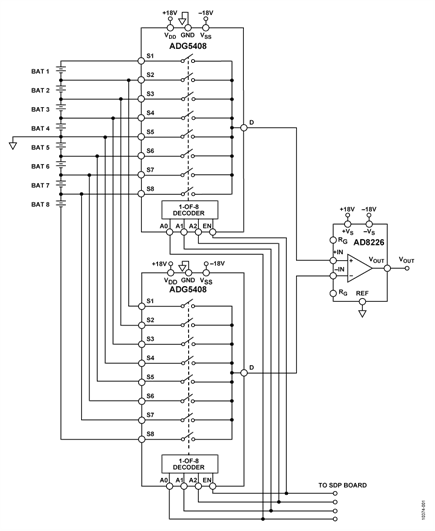

The circuit shown in Figure 1 is a robust battery monitoring front end designed for environments where transients may occur, such as industrial or process automation environments. This circuit uses an ADG5408 4-channel CMOS multiplexer followed by an AD8226 instrumentation amplifier to accurately monitor the voltage of each battery with low power consumption and low cost, without the need for additional external transient protection circuits.

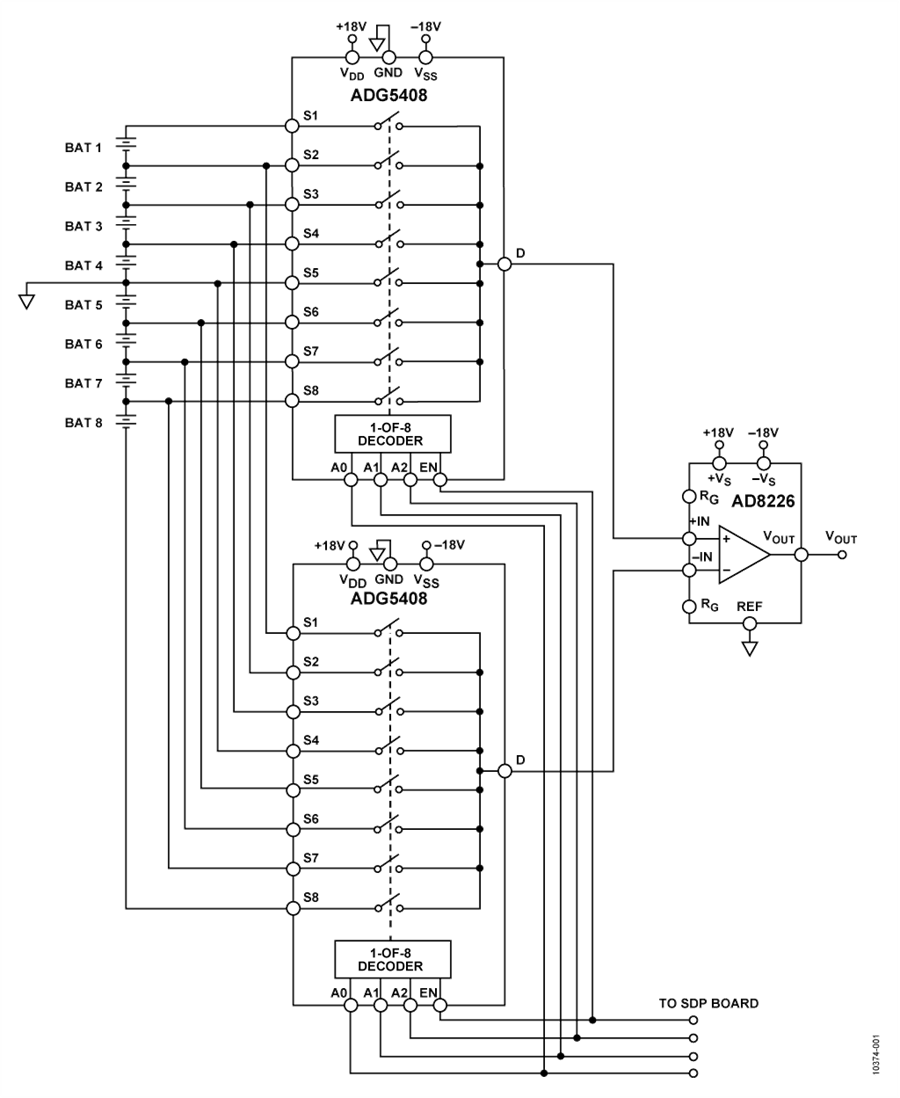

A battery monitoring system (BMS) requires applying individual voltages across each cell within the battery pack to evaluate the battery's state of charge (SOC) and state of operation (SOH). Multiplexing the battery pack pins via two multiplexers, as shown in Figure 1, allows the voltage across each cell to be evaluated.
One multiplexer for the positive pin and another for the negative pin. This differential multiplexing allows a single instrumentation amplifier to be used for up to eight channels. This way the amplifier does not require the common mode voltage of each cell for the BMS to use.
The ADG5408 has low on-resistance per channel, typically 13.5 Ω and 22 Ω maximum over temperature. With a maximum input offset current of 2 nA, the maximum error voltage across the channel resistor is 44 nV.
Figure 1. Robust battery monitoring circuit schematic (all connections and decoupling not shown)

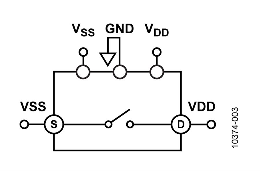

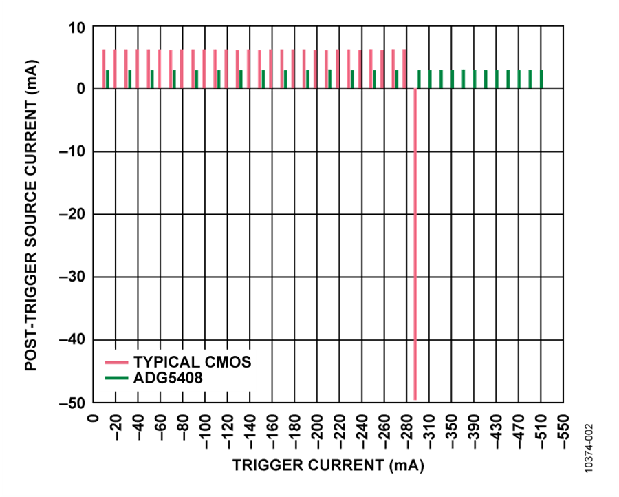

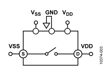

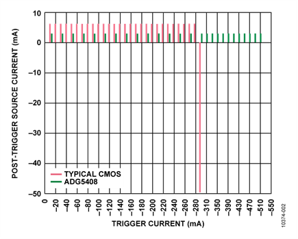

Figure 2 shows the results of a typical CMOS switch (using epitaxial layers) compared to the ADG5408 when subjected to latch-up testing. During the test, the stress current is applied to the pin for 1 ms. This operation is called triggering, and the current on the pin is measured after triggering. This particular test is performed with the switch open, drain (D) set to VDD and source (S) set to VSS, as shown in Figure 3. The source voltage is then driven beyond VSS until the desired trigger current is reached. If latch-up does not occur, the pin current returns to the pre-trigger value. After latch-up occurs, the pin continues to draw current without being driven by the trigger voltage. It can only be stopped by turning off the device.
As can be seen in Figure 2, this typical CMOS switch reaches latch-up current at −290 mA, whereas the ADG5408 does not latch-up unless the test ends at −510 mA.
Figure 2. Comparison of trigger current after latch-up
Figure 3. Latch-up test configuration (pre-trigger)
