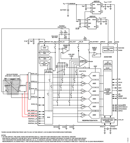

Figure 1 shows a top-level block diagram of the physical connections of a typical 5-lead (4 limb leads and 1 anterior chest lead) ECG measurement system that integrates respiratory and pacing detection functions. This configuration is typically used for portable telemetry ECG measurements or minimal lead setup for line-powered bedside instruments.
When measured at the skin surface, the ECG signal amplitude is small, typically 1 mV. Important information about the patient's health and other parameters is contained in that small signal, so the device is required to have μV-level measurement sensitivity. For systems, many medical standards require maximum noise to be no more than 30µV pp; however, designers often set this number lower. Therefore, all sources of noise must be considered when designing a solution that meets system-level requirements.
The ADAS1000 's noise performance is rated for a variety of different operating environments. The power supply must be designed so that it does not degrade overall performance. The ADP151 linear regulator was chosen due to its ultra-low noise performance (9 μV rms typical, 10 Hz to 100 kHz), which, combined with the power supply rejection performance of the ADAS1000, ensures that the noise generated by the ADP151 does not affect the overall noise performance.
Figure 1. ADAS1000 simplified functional block diagram for typical 4-electrode + RLD or 5-lead configuration (all connections and decoupling not shown)

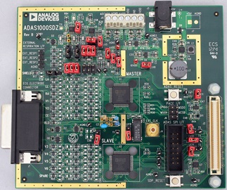

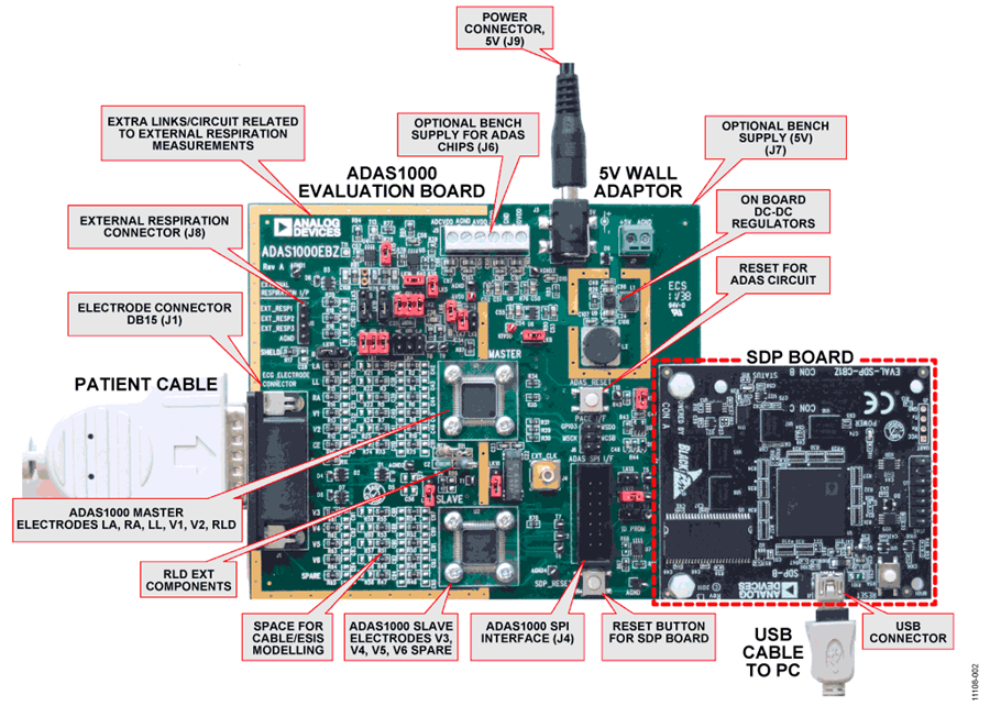

The photo of the ADAS1000 evaluation board connected to the SDP board is shown in Figure 2.
The evaluation board is designed to provide 1-lead to 12-lead ECG measurements.
Figure 2. ADAS1000 evaluation board/SDP board (EVAL-SDP-CB1Z)

The battery voltage range depends on the power supply range of the components in the system. ADAS1000 requires 3.3 V AVDD. Therefore, if the ADP151 voltage regulator is used, the battery must supply at least 3.7 V, which requires a margin of 400 mV. The nominal voltage of a lithium-ion or lithium-polymer battery is 3.7 V; however, the discharge voltage is approximately 3.2 V. Therefore, two stacks are required to ensure that the ADP151 reaches the minimum voltage of 3.7 V.

AVDD and IOVDD are powered from the 3.3 V supply on the evaluation board. Select 3.3 V for the IOVDD supply rail to maintain compatibility with the SPORT interface on the EVAL-SDP-CB1Z . If it is necessary to interface with a microcontroller operating at a lower supply voltage, the IOVDD supply voltage can be as low as 1.65 V.
Alternatively, if a more power efficient solution is required, the ADCVDD and DVDD internal supply rails can be disabled via a hardware pin (VREG_EN) on the ADAS1000 so that the ADCVDD and DVDD supply rails can be driven from an external supply. Since the ADCVDD supply rail powers the ADC on-chip, it must be kept as clean as possible and must not be used with noisy digital supplies.
Depending on the specific operating mode, the AVDD rail supply current powering a single ADAS1000 is typically between 8 mA and 15 mA, with all 5 channels enabled; inactive channels can be disabled to reduce power consumption.
A dedicated ADP151 operates both the AVDD and IOVDD supplies on the evaluation board. Note that each ADP151 can drive 200 mA and therefore can power other components in the system. The input to the ADP151 regulator comes from a 5 V rail that is used elsewhere on the board.
With appropriate filtering, a single ADP151 can provide power to both the AVDD and IOVDD rails, ensuring that the AVDD rail is not affected by any digital noise on the IOVDD rail.
The EVAL-ADAS1000SDZ evaluation board is designed to provide the required 5 V supply to the EVAL-SDP-CB1Z board at approximately 250 mA. The ADP2503 buck/boost DC-DC converter generates a 5 V supply rail from a 4.5 V to 5.5 V input supply connected to the board.
If this hardware is connected to the SDP board and powered by a battery, the total power consumption will quickly drain the battery.
