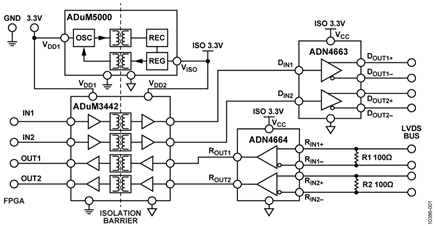

The circuit shown in Figure 1 isolates a dual-channel LVDS line driver and a dual-channel LVDS receiver. It enables two complete transmit and receive paths on a single circuit board.

Figure 2 shows an isolated LVDS interface circuit that isolates two transmit communication channels (CMOS/TTL to LVDS) and two receive channels (LVDS to CMOS/TTL). The isolated signal is capable of data rates up to 150Mbps while maintaining  the ADuM3442 's maximum pulse width distortion specification.
Figure 2. Isolated LVDS interface circuit
Logic levels can be applied to IN1 and IN2 and are isolated by the ADuM3442. The corresponding outputs of the ADuM3442 (DIN1 and DIN2 test pins) are connected to the ADN4663 LVDS driver to establish LVDS signals on DOUT1+, DOUT1− and DOUT2+, DOUT2−.
The ADN4664  LVDS receiver can receive LVDS signals on RIN1+, RIN1− and RIN2+, RIN2−. The receiver outputs (ROUT1, ROUT2 test pins) are connected to the ADuM3442 for signal isolation. The corresponding logic outputs of ADuM3442 are OUT1 and OUT2.
The circuit is powered from the logic side by connecting VDD1. The power supply can be 3.3 V or 5 V, powering the logic side of the ADuM3442 (circuit signal isolation) or powering the ADuM5000, which provides isolated power to the bus side of the circuit.
The ADuM5000's output V ISO provides 3.3 V power to the LVDS driver (ADN4663) and LVDS receiver (ADN4664), as well as the bus side of the ADuM3442.

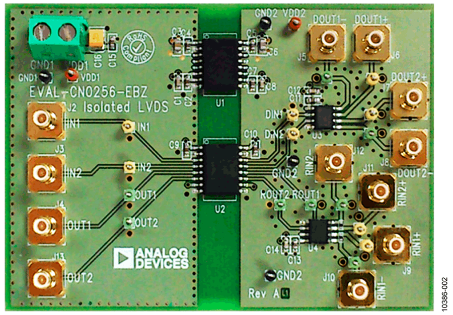

The circuit layout was performed as described in the AN-0971 application note "Recommendations for Radiation Control of IsoPower Devices" guide. Additionally, the layout is optimized for high-speed differential signaling. LVDS input/output trace lengths are matched and have an impedance of 50Ω to ground (100Ω between differential pairs). Each pair of test points is equally distanced from the driver/receiver. Multiple ground vias line the traces to increase signal integrity during high-speed operation.
The LVDS inputs RIN1+, RIN1− and RIN2+, RIN2− are connected to 100Ω terminal resistors (R1, R2). Terminate any bus sink connected to DOUT1+, DOUT1− and DOUT2+, DOUT1−.
Power and ground are connected to each other via spiral cable connectors (VDD1 and GND1). Logic inputs (IN1, IN2)/outputs (OUT1, OUT2) are connected to each other via 4 SMB connectors. Bus signals are connected in a similar manner via 8 SMB connectors. They are connected via traces to the LVDS driver (ADN4663) and receiver (ADN4664) with an impedance of 50Ω to ground.
