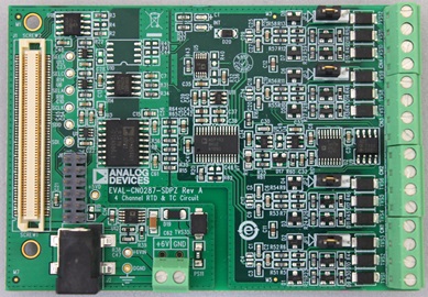

Circuit functions and advantages
The circuit shown in Figure 1 is a complete isolated 4-channel temperature measurement circuit optimized for performance, input flexibility, stability, and low cost. It supports all types of thermocouples (with cold junction compensation) and any type of RTD (resistance temperature detector, two-, three- or four-wire connection configuration) with resistance up to 4 kΩ.
RTD excitation current can be programmed for optimal noise and linearity performance.
RTD measurement accuracy is 0.1°C (typ) and Class K thermocouple measurement accuracy is 0.05°C (typ) because the 16-bit digital temperature sensor ADT7310 is used for cold junction compensation. This circuit uses a 4-channel, 24-bit, Σ-Δ ADC AD7193 . This device integrates a PGA on-chip and has high precision and low noise characteristics.
Input transient and overvoltage protection is provided by low-leakage transient voltage suppressors (TVS) and Schottky diodes. The SPI-compatible digital inputs and outputs are isolated (2500 V rms), and the circuit operates from a fully isolated power supply.

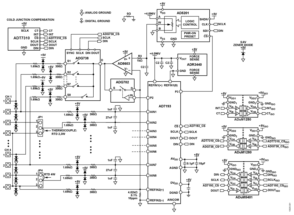

The circuit shown in Figure 1 is designed for precision temperature measurement applications in industrial field environments and is optimized for flexibility, performance, stability, and cost. This circuit uses the low-noise, 24-bit Σ-Δ ADC AD7193 to ensure that the entire circuit has high resolution and linearity.
The AD5201 33-bit digital potentiometer , AD8603 operational amplifier , and single-channel switch ADG702 form a simple programmable current source and bias voltage buffer for RTD and thermocouple measurements. The ADG738 routes current sources to active RTD channels, allowing wire resistance compensation for three-wire RTD configurations.
The ADT7310 digital SPI temperature sensor has ±0.8°C maximum accuracy over the −40°C to +105°C temperature range (with a +5 V supply) and is used for cold junction compensation in thermocouple measurements. The ADR3440 is a low noise, high accuracy, 4.096 V reference connected to REFIN1(+)/REFIN1(−) of the AD7193 for thermocouple measurements.

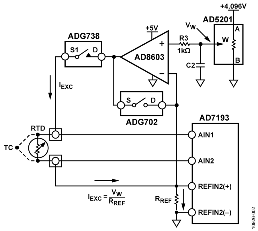

Programmable current sources for RTDs and bias voltage generation circuits for thermocouples
RTD measurements require a low-noise current source to drive the RTD and reference resistor. Thermocouples, on the other hand, require a common-mode bias voltage to convert the smaller thermocouple voltage into the input range of the AD7193. The circuit shown in Figure 2 meets both requirements and uses the AD8603 low-noise CMOS rail-to-rail input/output op amp, which has a maximum input bias current of only 1 pA and a maximum offset voltage of 50 μ V; at the same time, It also uses a single-channel CMOS low-voltage 2Ω single-pole single-throw (SPST) switch ADG702, and an 8-channel matrix switch ADG738.
Figure 2. External programmable current source and bias voltage generator
With the ADG738 turned on and the ADG702 turned off, the AD8603 can be used as a low-noise, low output impedance unity-gain buffer in thermocouple applications. The voltage from the AD5201 digital potentiometer is buffered and then applied to the thermocouple common mode voltage, which is typically half the supply voltage, which is 2.5 V. The AD5201 33-bit digital potentiometer is driven by the ADR3440 low-drift (5 ppm/°C) 4.096 V reference to obtain the required accuracy.
When ADG738 is turned on and ADG702 is turned off, AD8603 generates RTD excitation current, that is, I EXC = V W /R REF .
Temperature measurement is a high-precision, low-speed application, so there is sufficient settling time to switch a single current source among all 4 channels, providing excellent channel-to-channel matching, low cost, and small PCB size.

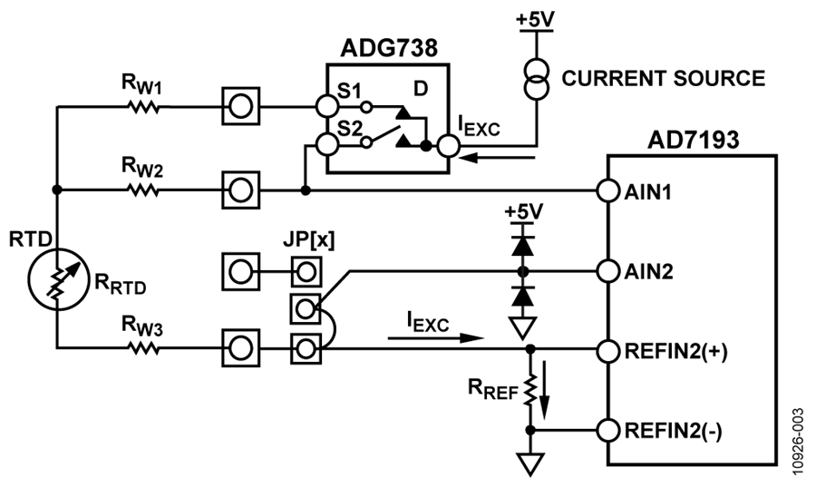

The ADG738 is an 8:1 multiplexer that switches current sources between channels. To support two-wire, three-wire, and four-wire RTD configurations, two switches are required for each of the four channels.
In many applications, the RTD may be placed remotely from the measurement circuitry. Long lead resistors can produce large errors, especially when used with low resistance RTDs. To minimize lead resistance effects, a three-wire RTD configuration is supported, as shown in Figure 3.
Figure 3. Connector and jumper configuration for three-wire RTD sensor
关断ADG738的S1,同时打开S2,则AD7193输入端的电压为 V1。打开S1,同时关断S2,则AD7193输入端电压为 V2。RTD传感器两端的电压为VRTD,而电流源的激励电流为IEXC。V1 和 V2包括引线电阻产生的误差,如下所示:
CN0287_image1
假定 RW1 = RW2 = RW3,然后结合等式1、等式2和等式3,可得:
CN0287_image2
等式5表示三线式配置需要分别进行两次测量 (V1 和V2) 才能计算RRTD,因此输出数据速率有所下降。在很多应用中,这并不是个问题。

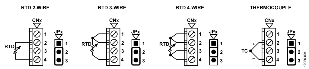

四线式RTD连接要求具有两个额外的检测线路,但对导线电阻不敏感,且仅需进行一次测量。
图4总结了双线式、三线式和四线式RTD和热电偶应用的连接器配置和跳线位置。

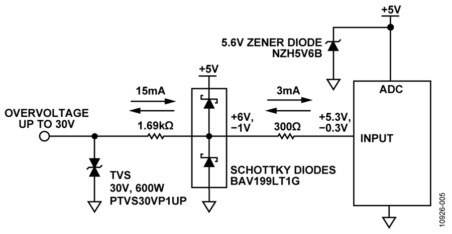

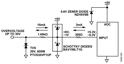

保护电路
在制造过程中和现场使用时,都有可能产生瞬变和过压条件。为了获得较高的保护水平,有必要使用外部保护电路,补充IC的内部集成保护电路。外部保护功能会增加额外的电容、电阻和漏电流。这些效应应当仔细考虑,以获得高精度水平。额外保护电路如图5所示。
图5. 瞬变和过压保护电路
漏电流会对RTD测量造成巨大影响,应仔细考虑。当较长的热电偶引线具有极高电阻时,漏电流也会对热电偶测量产生一些误差。
本电路中,PTVS30VP1UP瞬变电压抑制器(TVS)可快速箝位任何瞬变电压至30 V(25°C时典型漏电流仅1 nA)。选择30 V TVS,以便支持30 V直流过压。使用1.69 kΩ电阻,后接低泄露BAV199LT1G肖特基二极管,用于在瞬变和直流过压事件发生时将电压箝位至5 V供电轨。在30 V直流过压条件下,1.69 kΩ电阻将流过外部二极管的电流限制为15 mA。为了确保供电轨能够吸取该电流,可使用齐纳二极管将供电轨进行箝位处理,以保证它不超过连接电源的任意IC的绝对最大额定值。选择5.6 V齐纳二极管(NZH5V6B)实现这一目的。300Ω电阻可进一步限制有可能进入AD7193或ADG738的电流。

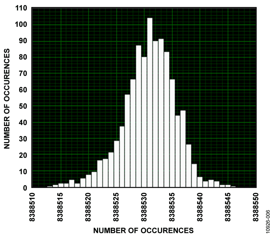

电路的性能高度依赖于传感器和AD7193的配置。K类热电偶输出变化范围为−10 mV至+60 mV,对应温度范围为−200°C至+1350°C。AD7193 PGA配置为G = 32。PGA电压摆幅范围为−320 mV至+1.92 V,即2.24 V p-p。斩波使能时,50 Hz/60Hz噪声抑制使能,滤波器字FS[9:0] = 96,1024个样本的噪声分布直方图如图6所示。
图6. CN-0287噪声分布直方图(VDD = 5 V,VREF = 4.096 V,差分输入,双极性,输入缓冲器使能,输出数据速率 = 50 Hz,增益 = 32,斩波使能,60 Hz抑制使能,Sinc4)
AD7193分辨率为24位,即224 = 16,777,216个代码。AD7193的全动态范围为2 ×VREF = 2 × 4.096 V = 8.192 V。位于PGA之后的热电偶输出电压仅为2.24 V p-p,并且不会完全占据AD7193的所有动态范围。因此,系统范围以2.24 V/8.192V系数降低。
噪声分布约为40个代码峰峰值。2.24 Vp-p测量范围内的无噪声代码分辨率为:
CN0287
K类热电偶的满量程温度范围为−200°C至+1350°C,即1550°C p-p。因此16.8位无噪声代码分辨率相当于0.013°C无噪声温度分辨率。热电偶配置测试结果电路的性能高度依赖于传感器和AD7193的配置。K类热电偶输出变化范围为−10 mV至+60 mV,对应温度范围为−200°C至+1350°C。AD7193 PGA配置为G = 32。PGA电压摆幅范围为−320 mV至+1.92 V,即2.24 V p-p。斩波使能时,50 Hz/60Hz噪声抑制使能,滤波器字FS[9:0] = 96,1024个样本的噪声分布直方图如图6所示。

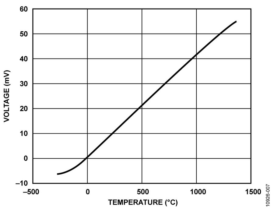

热电偶测量线性度
热电偶测量线性度图7显示K类热电偶系统的近似线性度。该曲线中,“冷结”温度为0°C。
图7. K类热电偶温度与0°C冷结输出电压的关系

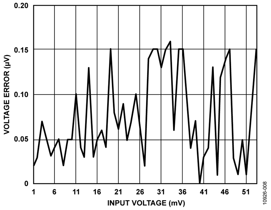

Fluke 5700A校准仪提供分辨率为10 nV的高精度直流电压源,用于校准以及测试。图8中的电压误差位于0.2μV理想范围内,相当于大约0.004°C。该结果是系统在25°C时校准后的短期精度,此时没有温度漂移效应。本电路的主要误差来源于冷结补偿测量。在本电路中,ADT7310用于冷结补偿,典型误差为−0.05°C,采用5 V电源时,在−40°C至+105°C温度范围内的最差情况误差为±0.8°C。若使用3 V电源,则器件在该温度范围内具有±0.4°C的最大误差。

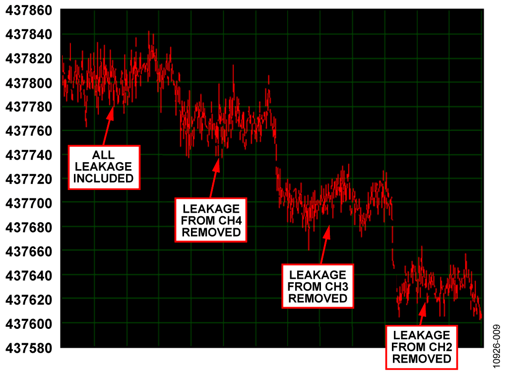

Experimentally show leakage current effects. Each channel is first configured as a four-wire RTD. The 100Ω fixed resistor is connected to channel 1 at the RTD location. The 0Ω resistors are connected to the inputs of the other 3 channels.
The gain is set to G = 1 and the excitation current is 380 μA (Pt1000 configuration).
Collect data, then remove the jumpers connecting channel 4, channel 3, and channel 2 to collect data for each condition. The results are shown in Figure 9.
Figure 9. Error due to leakage current in channel 1 of a 4-channel Pt100 RTD (G = 1)
The ADC code changes from approximately 437,800 to 437,600 and the corresponding measurement changes from 104.9015Ω to 104.8627 or 0.0388Ω. This represents a measurement error of approximately 0.1°C; however, the error can be eliminated by calibrating at room temperature with a fixed input configuration.
