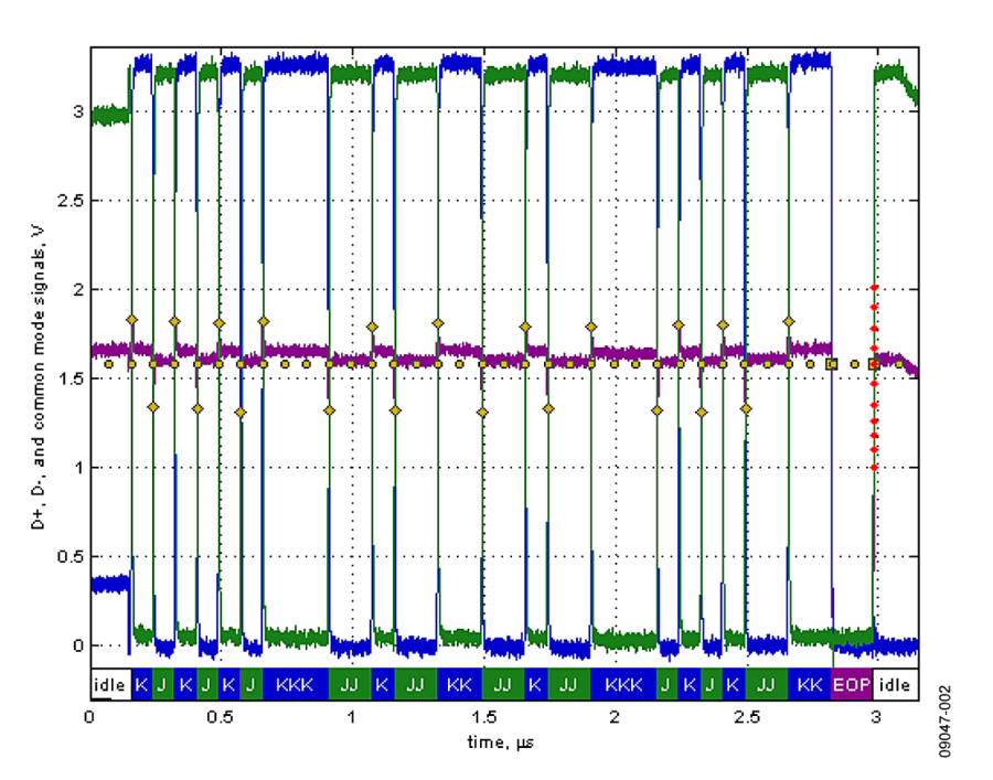

When the circuit is working, packet detection occurs and data is transferred from one side of the isolation to the other. The data shown in Figures 2 and 3 illustrate typical full-speed processing in the form of time domain data and eye diagrams respectively. In real-time data, characteristics to note are that the packet starts in the passive idle state, which transitions to the driven J state, and that the end of the packet at the end of processing shows a single-ended 0 state, followed by the idle J state. It is this automatic control flow and handling of these special logic states that enables the ADuM4160 chip and is unique on the market.
Figure 2. Full-speed test packet traffic driven by ADuM4160 upstream port

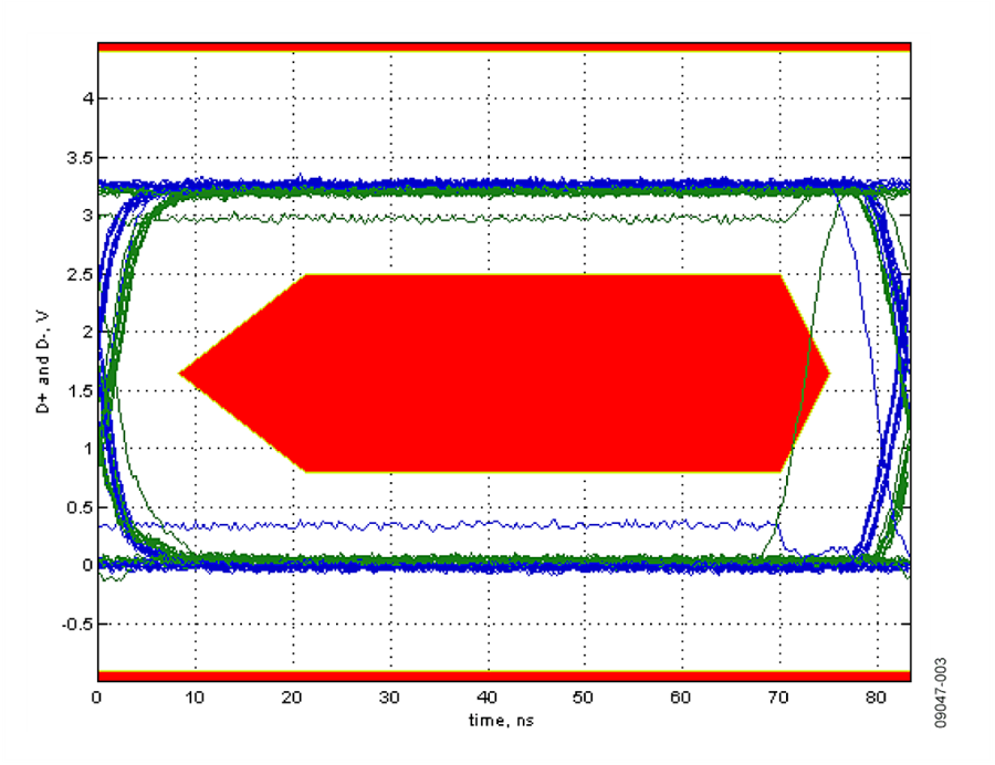

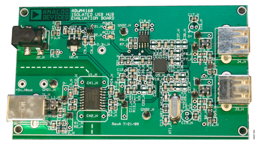

Figure 3 is a full-speed eye diagram showing that the ADuM4160 is able to provide a fully open eye and stay away from the no-go zone. The exception is one transition, which invades a no-go zone. This is acceptable for this type of test certification. Similar data were obtained for the low-speed evaluation. A photo of the evaluation board is shown in Figure 4. For layout files, please visit: http://www.analog.com/CN0158-DesignSupport.
Figure 3. Full-speed eye diagram showing the keep-out region
Figure 4. ADuM4160 Isolated USB Hub Evaluation Board
