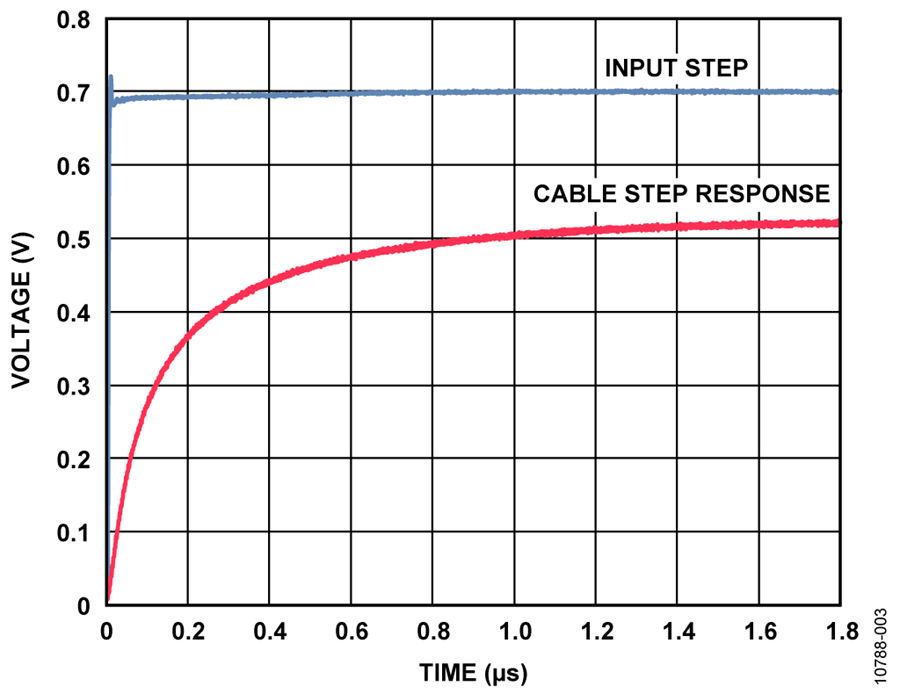

The skin effect of UTP cables produces transmission losses that increase with frequency, causing the received signal to appear rounded and spread out, and simple cable resistance causes flat resistive losses in the cable. Figure 3 illustrates these effects by comparing the step response of a 300-meter-long UTP full-swing video to the step signal of the input cable.
Figure 3. Step response of 300 meters of Cat-5e unbalanced cable

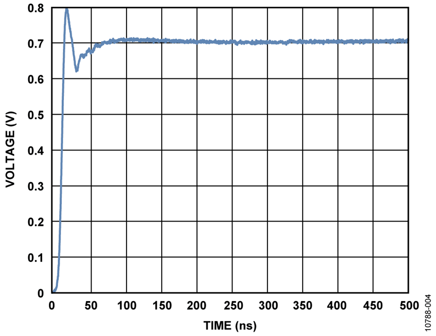

The AD8122 three-channel equalizer performs differential to single-ended mode conversion, providing high common-mode rejection and compensation for these signal impairments. Figure 4 shows the corrected step signal at the equalizer output, settling to 1% error in less than 70 ns. Note that the time scale in Figure 4 is in nanoseconds.
Figure 4. Equilibrium step response of 300 meters of Cat-5e cable (note that the time unit is ns)

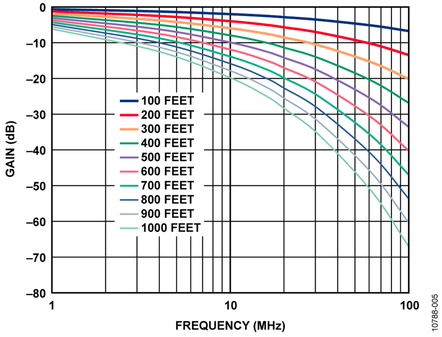

For the frequency domain, Figure 5 shows the frequency response of Cat-5e cable lengths from 100 feet to 1000 feet, in 100-foot increments, where band limiting effects and flattening losses are evident.
Figure 5. Unbalanced Cat-5e cable frequency response at different cable lengths

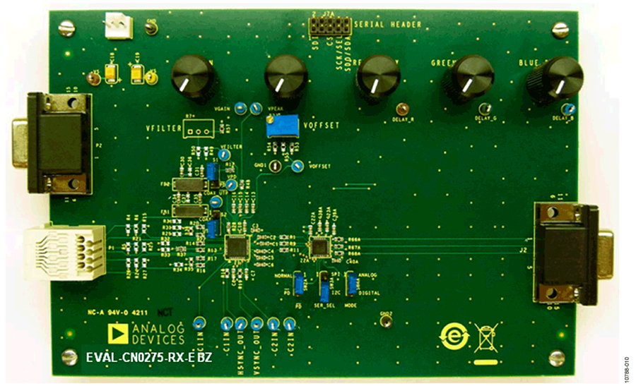

The receiver evaluation board includes the AD8122 and AD8120 and all supporting circuitry required, including 5 potentiometers to manually adjust high frequency boost, flat gain, and 3 delay lines. In addition, a serial interface for optional serial control of the AD8120 is provided.

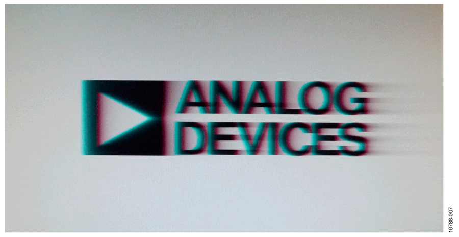

Image quality at the far end of a video distribution system is important. Image quality is determined by the time it takes for the step response to build up to a difference of 3.5 mV from the final value. When this value exceeds a certain fraction of the pixel time, image quality begins to suffer. Figure 7 shows an extreme example of an image received over 300 meters (1000 feet) of Cat-5e cable without equalization or deskew. The black smearing in Figure 7 is extremely severe, the step response is sluggish, and the time skew causes color imbalance. The fully corrected image is shown in Figure 8.
Figure 7. Without equalization and deskew applied to images transmitted over 300 meters of Cat-5e cable

Actual photos of the transmitter and receiver evaluation boards are shown in Figures 9 and 10 respectively. For a complete design support package for the EVAL-CN0275-RX-EBZ Transmitter Evaluation Board and EVAL-CN0275-TX-EBZ Receiver Evaluation Board, including schematics, layout files, and bill of materials, please visit www.analog.com/ CN0275-DesignSupport .
Figure 9. EVAL-CN0275-TX-EBZ Transmitter Evaluation Board
Figure 10. EVAL-CN0275-RX-EBZ Receiver Evaluation Board
