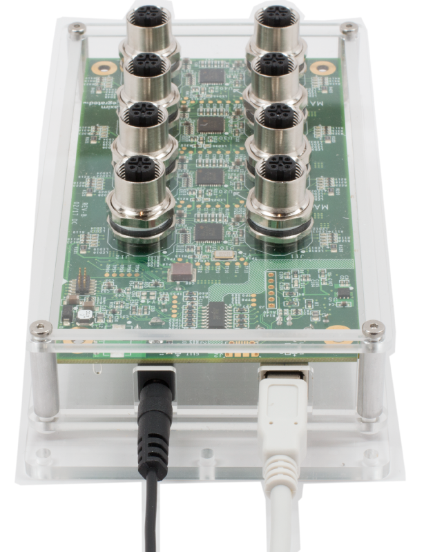

MAXREFDES145# is the world’s first 8-port IO-Link host reference design that is fully compatible with IO- Link® . The design uses TEConcept's IO-Link host stack, which is both an IO-Link host reference design and an IO-Link sensor/actuator development and test system. Eight IO-Link ports support testing of up to eight different sensors (or actuators) simultaneously. The reference design features eight reliable female M12 connectors, the most commonly used for IO-Link, and two IO-Link cables are supplied with the host for quick connection to IO-Link compatible sensors and actuators. The DC to AC (24VDC/1A) power adapter can provide at least 125mA to each port simultaneously; more current can be provided if there are unused ports. USB 2.0 Type B connector allows quick connection to Windows® PC .
The easy-to-use TEConcept Control Tool (CT) GUI software features IODD file import capabilities, making the MAXREFDES145# a must-have tool for any company or engineer working on developing IO-Link products.
