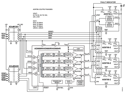

The circuit shown in Figure 1 is a multi-channel, flexible analog output solution using only two analog devices. It meets the needs of multi-channel I/O cards, programmable logic controllers (PLCs) and distributed control systems (DCS). most requirements of the application. Quad-channel, 16-bit nanoDAC+ AD5686R with rail-to-rail buffered outputs, used with four industrial current/voltage output drivers AD5750-2 , provides outputs in all typical current and voltage ranges with 16-bit resolution and no missing codes , 0.05% linearity and less than 0.1% output error.
The AD5686R integrates a 2.5 V reference voltage source with high drive capability (up to ±5 mA) and ultra-low drift (2 ppm/°C, typical). It can provide the reference voltage for both the AD5686R and the AD5750-2 to ensure the circuit's reliability. Low noise, high precision, low temperature drift.
The ADuM1301 and ADuM5400 provide 2500 V rms isolation of all necessary signals between the power and analog signal chains and the host controller.
For multi-channel I/O card applications requiring more than 4 channels, multiple AD5686Rs can be connected in a daisy chain without requiring additional external digital I/O circuitry. This keeps costs to a minimum, especially for high channel count isolation applications.
The circuit also has some key features for industrial applications such as on-chip output fault detection, packet error checking (PEC) via CRC, flexible power-up options, and ESD protection (4 kV for AD5686R, Human Body Model, AD5750-2 3 kV, human body model), ideal for building robust industrial control systems. It maintains consistent performance in high-volume production without the need for external precision resistors or calibration procedures, making it ideal for PLC or DCS modules.

The AD5686R is a quad-channel, 16-bit, rail-to-rail voltage buffered output nanoDAC+ with an integrated 2.5 V reference of 2 ppm/°C typical (5 ppm/°C maximum). The on-chip voltage reference drives all four AD5750-2 reference inputs, has a low output impedance of 0.05 Ω, and can source and sink currents up to 5 mA. The AD5686R has a built-in power-on reset circuit that ensures that the DAC output powers up to 0 V and remains there until a valid write operation is performed.
The simple interface between the AD5686R DAC and the AD5750-2 driver requires no external reference or precision resistors. The output voltage range of the AD5686R is 0 V to 2.5 V, matching the input range of the AD5750-2. In addition, the AD5686R's reference output voltage is 2.5 V, which exactly matches the reference input requirements of the AD5750-2.
The ADuM1301 is a three-channel digital isolator. The ADuM5400 is a four-channel digital isolator that integrates an isolated DC/DC converter. They are based on iCoupler® technology and are used to provide isolation between the signal chain and the system microcontroller, with an isolation rating of 2.5 kV rms. The ADuM5400 provides 5 V isolated power for the 5 V circuitry on the secondary side.

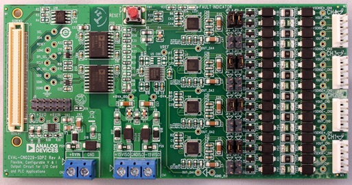

Use an external 54 V, 600 W transient voltage suppressor (TVS) as the first stage of enhanced ESD protection. Place a Schottky power diode in series with a 1 kΩ, 0.5 W resistor on the VSENSE+ and VSENSE− pins of the AD5750-2, and place a 50 mA, 30 V resettable fuse on the VOUT and IOUT pins. These protection circuits are placed in the EVAL-CN0229-SDPZ circuit board to provide 50 V overvoltage protection and 50 mA overcurrent protection. The optional external protection circuit is not shown in the schematic of Figure 1, but can be found in the detailed schematic of the CN0229 Design Support Package ( EVAL-CN0229-SDPZ-PADSSchematic pdf file): http://www.analog.com/CN0229 -DesignSupport
This circuit must be built on a multilayer circuit board (PCB) with a large ground plane. For optimal system performance and low EMI, use proper layout, grounding, and decoupling techniques (refer to Tutorial MT-031—Grounding Data Converters and Solving the Mysteries of AGND and DGND— and Tutorial MT-101— —decoupling technology ).

The test results shown in Table 1 were obtained using the first channel of the EVAL-CN0229-SDPZ circuit board at 25°C, powered by an Agilent E3631A DC power supply, and measured using an Agilent 34401A digital multimeter.
