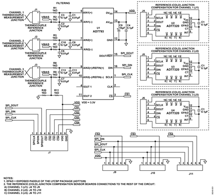

Figure 1. Multi-channel thermocouple measurement system (schematic diagram: all connections and decoupling not shown)
Circuit description
The circuit in Figure 1 is designed for simultaneous measurement of three K-type thermocouples using the ADT7320 , a ±0.25°C accurate, 16-bit digital SPI temperature sensor.
Thermocouple voltage measurement
A thermocouple connector and filter are used as the interface between the thermocouple and the AD7793 ADC. Each connector (J1, J2, and J3) connects directly to a set of differential ADC inputs. Filters at the inputs of the AD7793 reduce any noise superimposed on the thermocouple pins before the signal reaches the AIN(+) and AIN(−) inputs of the ADC. The AD7793 integrates on-chip multiplexers, buffers, and instrumentation amplifiers to amplify small voltage signals from the thermocouple measurement junction.
Cold junction measurement
The ADT7320 precision 16-bit digital temperature sensor measures reference junction (cold junction) temperature with an accuracy of ±0.25°C over the −20°C to +105°C temperature range. The ADT7320 is fully factory calibrated and does not require user calibration. It has a built-in bandgap temperature reference source, a temperature sensor and a 16-bit Σ-Δ ADC to measure temperature and perform digital conversion with a resolution of 0.0078°C.
Both the AD7793 and ADT7320 are controlled by the SPI interface using the system demonstration platform ( EVAL-SDP-CB1Z ). Additionally, both devices can also be controlled by a microcontroller.

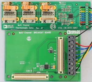

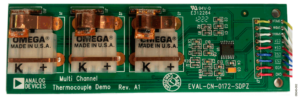

Figure 2. EVAL-CN0172-SDPZ circuit evaluation board
Figure 2 shows the EVAL-CN0172-SDPZ circuit evaluation board with three K-type thermocouple connectors , the AD7793 ADC, and the ADT7320 temperature sensor mounted between two copper contacts on a separate flexible printed circuit board (PCB), using Measured at reference temperature.

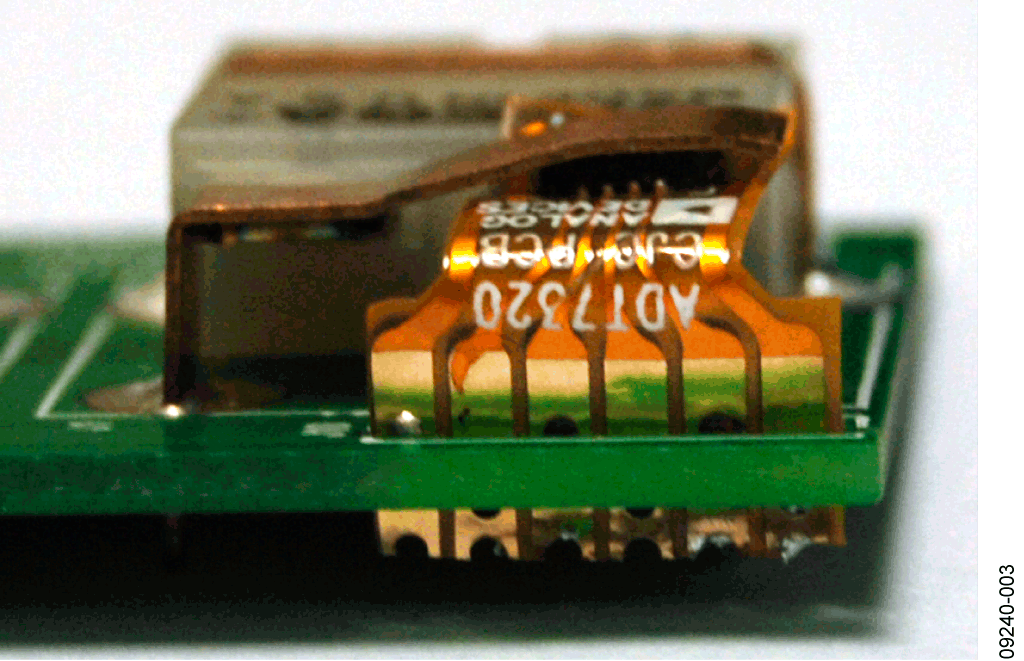

Figure 3 is a side view of the ADT7320 mounted on a separate flex PCB, with the device inserted between the two copper contacts of the thermocouple connector. The flexible PCB in Figure 3 is thinner and more flexible, which has advantages over small FR4 type PCBs. It allows the ADT7320 to be strategically mounted between the copper contacts of the thermocouple connector to minimize the temperature gradient between the reference junction and the ADT7320.
Figure 3. Side view of ADT7320 mounted on flexible PCB

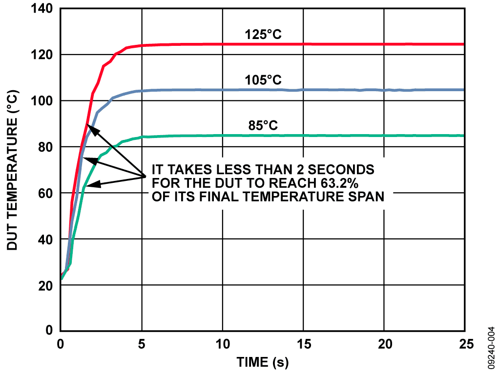

The small, thin flexible PCB also allows the ADT7320 to respond quickly to temperature changes at the reference junction. Figure 4 shows the typical thermal response time of the ADT7320.
Figure 4. ADT7320 typical thermal response time

Decoupling : The AD7793 must have decoupling capacitors installed as close as possible to AV DD and DV DD to ensure voltage measurement accuracy. Decouple AVDD to GND with a 0.1 μF ceramic capacitor in parallel with a 10 μF tantalum capacitor. Additionally, DVDD should be decoupled to GND with a 0.1 μF ceramic capacitor in parallel with a 10 μF tantalum capacitor. For more discussion of grounding, layout, and decoupling techniques, please refer to Tutorial MT-031 and Tutorial MT-101
Filtering : The differential inputs of the AD7793 are used to eliminate most of the common-mode noise on the thermocouple lines. For example, placing R1, R2, and C3, which form a differential low-pass filter, on the front end of the AD7793 can eliminate possible superimposed noise on the thermocouple pins. Capacitors C1 and C2 provide additional common-mode filtering. Since the AIN(+) and AIN(−) inputs to the ADC are analog differential inputs, most of the voltages in the analog modulator are common-mode voltages. The AD7793's excellent common-mode rejection (100dB minimum) further eliminates common-mode noise from these input signals.
