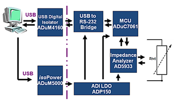

The complex impedance measuring instrument based on AD5933 launched by ADI can solve the above problems.
AD5933 is a high-precision impedance converter system solution:
• Internal DDS generates the excitation voltage signal
• Users can adjust the rate and amplitude of the excitation frequency signal
• Internal 12-bit ADC samples the response signal
• Internal integrated DSP at the corresponding frequency point Perform DFT

Blockdiagram
