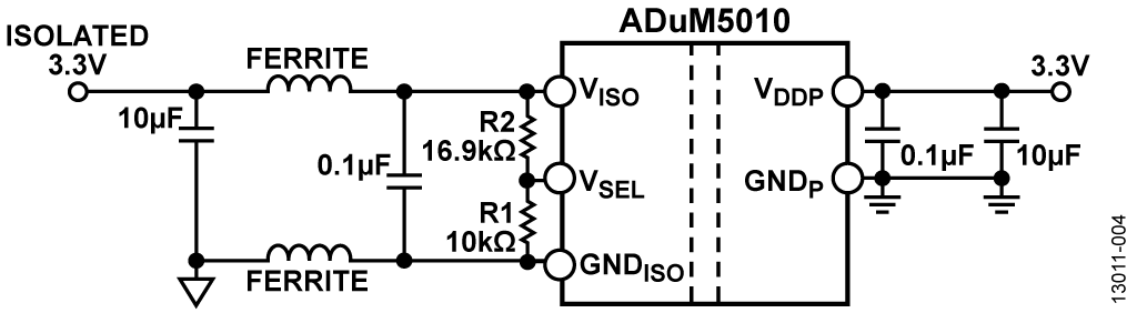

ADuM5010 isolated DC/DC converter provides 3.3 V isolated power through integrated isoPower® technology . The ADuM1441 is used to isolate the serial peripheral interface (SPI) of the AD7124-4. The AD7124-4 micropower isolator consumes only 4.8 A per channel when idle, making it very energy efficient. The ADP2441 is a 36 V step-down DC-DC regulator that operates from an industry-standard 24 V supply and has wide input voltage tolerance. The ADP2441 is used to reduce the input voltage to 3.3 V to power all controller-side circuitry. System Overview Channel-to-channel isolation is extremely advantageous in automation systems because the failure of a specific input channel does not affect other channels in the system. However, channel-to-channel isolated input modules present significant design challenges in terms of complexity, space constraints, and system cost. Thermocouple or RTD inputs are common inputs in industrial automation systems, so it is useful to design a temperature input module that can handle both. This flexibility minimizes the design effort for both input modules and provides flexibility to module users. The AD7124-4 significantly reduces design complexity, providing a system-on-chip capable of performing all measurement functions required for thermocouples and RTD sensors. The size of each channel of the circuit shown in Figure 1 is only 27 mm × 50 mm. If devices are placed on both sides of the printed circuit board (PCB), the above area can be further reduced. Such a small size is achieved because the AD7124-4 is available in a small 5 mm × 5 mm LFCSP package and integrates almost all required functions except isolation and additional front-end filtering and protection. The isolation circuit for data and power isolation occupies only 87 mm 2 with a minimum combined width of 12.5 mm. Terminal Connections Figure 2 shows the terminal connections for each of the two input channels. These pins correspond to P1 and P2 in hardware (see Figure 1). The thermocouple and 2/3/4 wire RTD connections are shown in the figure.

Isolation
The data channel is isolated using the ADuM1441 four-channel micropower isolator, which is very energy efficient. The ADuM1441 is available in a small 5 mm × 6.2 mm, 16-pin QSOP package (30 mm 2 ).
The ADuM5010 is a complete isolation development converter that utilizes isoPower technology to provide power isolation to the circuit. The ADuM5010 is available in a small 7.4 mm × 7.5 mm, 20-lead SSOP package (56.25 mm 2 ).
Figure 4 shows the ADuM5010 circuit details. Ferrite beads are used on the secondary side of the power supply to suppress potential electromagnetic interference (EMI) radiation. The ferrite beads (Murata BLM18HK102SN1) are specifically selected for high impedance from 100 MHz to 1 GHz. 10 ¬ µF and 0.1 ¬ µF decoupling capacitors are also used. Both the ferrite bead and capacitor are connected to the ADuM5010 pins with short traces to minimize parasitic inductance and resistance.
Figure 4. isoPower circuit with ferrite beads and decoupling capacitors
Stitching capacitors have been kept to a minimum area because the ferrite beads have significantly reduced radiation. The PCB area between the ADuM5010 power supply, GND pin, and ferrite bead should eliminate any ground plane or traces to minimize capacitive coupling of high-frequency noise into the ground plane. For more information on controlling radiation from isoPower devices, see the AN-0971 application note .
Select the R1 and R2 feedback resistors according to the ADuM5010 data sheet to select the 3.3 V output.
Power consumption per channel
The ADuM5010 is powered by the controller side power supply and has a typical power consumption of 3.3 mA. The ADuM5010 is only 27% efficient at full load, so minimizing field-side current consumption can have a significant impact on the channel's energy efficiency.
