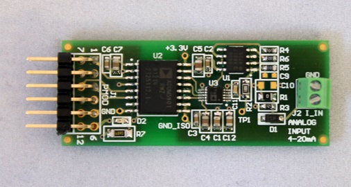

The circuit shown in Figure 1 is a fully isolated 12-bit, 300 kSPS data acquisition system using only three active devices.
The system operates from a single 3.3 V supply and can handle input signals from 4 mA to 20 mA. Room temperature calibration provides a total error of ±0.06% FSR over a temperature variation of ±10°C, making it ideal for a variety of industrial measurement applications.
The circuit's small size makes this combination an industry-leading solution for 4 mA to 20 mA data acquisition systems where accuracy, speed, cost and size are critical. Data and power are isolated, so the circuit has excellent high voltage tolerance and is immune to ground loop interference common in harsh industrial environments.

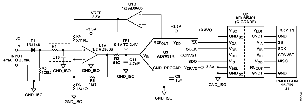

Figure 1. 4 mA to 20 mA isolated single-supply analog-to-digital conversion (all connections and decoupling not shown)
Circuit description
The circuit consists of an input current-to-voltage converter, a level shifting circuit, an ADC stage, and an output isolation stage. The 4 mA to 20 mA input signal is converted into a voltage by resistor R3. With R3 = 120 and an input current of 4 mA to 20 mA, the input voltage to the level shifting circuit is: 0.48 V to 2.4 V. Diode D1 is used to provide protection against accidental reverse connection of the input current source.
The voltage on R3 is level shifted and attenuated by the U1A op amp, which is half the size of the dual AD8606 . The output of the op amp is 0.1 V to 2.4 V, matching the input range of the ADC (0 V to 2.5 V) with a 100 mV headroom to maintain linearity. A buffered voltage reference (VREF = 2.5 V) from the AD7091R ADC is used to generate the required offset. The resistor values ​​can be modified to accommodate other common input ranges described later in this circuit note.
The circuit design supports single power supply. The AD8606 has a minimum rated output voltage of 50 mV (2.7 V supply) and 290 mV (5 V supply) at a load current of 10 mA and a temperature range of -40°C to +125°C. With a 3.3 V supply, load current less than 1 mA, and a narrower temperature range, a conservative estimate of the minimum output voltage is 45 mV to 60 mV.
The circuit design supports single power supply. The AD8606 has a minimum rated output voltage of 50 mV (2.7 V supply) and 290 mV (5 V supply) at a load current of 10 mA and a temperature range of -40°C to +125°C. With a 3.3 V supply, load current less than 1 mA, and a narrower temperature range, a conservative estimate of the minimum output voltage is 45 mV to 60 mV. Taking into account device tolerances, the minimum output voltage (lower end of range) is set to 100 mV to provide a safety margin. The upper limit of the output range is set to 2.4 V to provide 100 mV of headroom for positive swings at the ADC input. Therefore, the nominal output voltage range of the input op amp is 0.1 V to 2.4 V.
The other half of the AD8606(U1B) is used to buffer the internal 2.5 V reference of the AD7091R(U3) analog-to-digital converter.
The AD8606 was chosen for this application because of its low offset voltage (65 V maximum), low bias current (1 pA maximum), and low noise (12 nV/√Hz maximum). At 3.3V supply, power consumption is only 9.2 mW.
The output stage of the op amp is followed by a single-pole RC filter (R2/C11) to reduce out-of-band noise. The cutoff frequency of the RC filter is set to 664 kHz. An optional filter (R1/C10) can be added to further reduce the filter cutoff frequency in the presence of low-frequency industrial noise. In such cases, the sampling rate of the AD7091R can be reduced due to the smaller signal bandwidth.
The AD7091R 12-bit 1 MSPS SAR ADC was chosen because of its ultra-low power consumption of only 349 A at 3.3 V (1.2 mW), which is significantly lower than any competing ADC currently on the market. The AD7091R also has an internal 2.5 V reference with a typical drift of ±4.5 ppm/°C. The input bandwidth is 7.5 MHz, and the high-speed serial interface is SPI-compatible. The AD7091R is available in a small 10-pin MSOP package.
When powered from a 3.3 V supply, the total power dissipation of this circuit (excluding the ADuM5401 isolator) is approximately 10.4 mW. The ADuM5401 quad-channel 2.5 kV isolator integrates a DC/DC converter and is available in a small 16-pin SOIC package. The ADuM5401 consumes approximately 140 mW at a 7 MHz clock frequency. Galvanic isolation is provided by the ADuM5401 quad-channel digital isolator (Grade C). In addition to isolating the output data, the ADuM5401 provides an isolated +3.3 V power supply to this circuit. The ADuM5401 is not required for normal operation of the circuit unless isolation is required. However, the ADuM5401 (Grade C) isolator has a maximum data rate of 25 Mbps, which corresponds to a maximum serial clock frequency of 12.5 MHz. In addition, the SPI port requires that the trailing edge of SCLK drives the output data to the processor, so the total two-way propagation delay of the ADuM5401 (120 ns maximum) limits the upper clock limit to 1/120 ns = 8.3 MHz.
Although the AD7091R is a 12-bit ADC, the serial data is also formatted as 16-bit words to be compatible with the processor serial port requirements. Therefore, the sampling period TS includes the conversion time of the AD7091R650 ns plus 58 ns (additional time required by the data sheet, t1 delay + tQUIET delay), plus 16 clock cycles for the SPI interface data transfer.
T S = 650 ns + 58 ns + 16 × 120 ns = 2628 ns
f S = 1/T S = 1/2628 ns = 380 kSPS
To provide a safety margin, it is recommended to set the SCLK and sample rate to a maximum value of 7 MHz and 300 kSPS respectively. The digital SPI interface can be connected to the microprocessor evaluation board using a 12-pin Pmod compatible connector (Digilent Pmod specification).

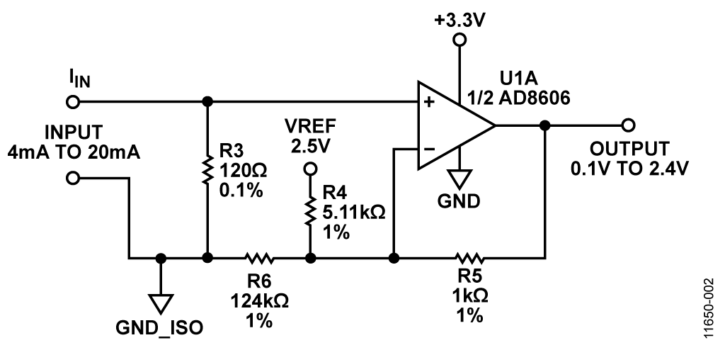

The circuit shown in Figure 2 provides appropriate gain and level translation to convert a 0.48 V to 2.4 V signal to the ADC input range, which is 0.1 V to 2.4 V.
Figure 2. Current-to-voltage converter and level shifting circuit
The transfer function is determined using the superposition principle.
CN0336_Image1
CN0336_Image2
Calculation of Gain and Resistor Values
The gain of the circuit is:
CN0336_Image3
When the input range is 0 mA to 20 mA, the circuit does not require level shifting and the op amp acts as a follower. At this time, the voltage drop on R3 must not exceed the upper limit of the output range (2.4 V). The calculation formula is as follows:
CN0336_Image4
CN0336_Image5
CN0336_Image6
CN0336_Image7
Now, if you are given the value of one of the three resistors R4, R5, and R6, you can calculate the value of the other two resistors according to Equation 7 and Equation 9. For example, if R5 = 1000 ¬, then R4 = 5,263 ¬ and R6 = 125,310 ¬.
In the actual circuit, resistor values ​​closest to existing standards were chosen for resistors R4 and R6. The selected values ​​are R4 = 5.11k¬ and R6 = 124 k¬.
If these values ​​are chosen carefully, the total error caused by using alternative standard value resistors can be reduced to less than a few percent. However, the output of the U1A op amp at 4 mA and 20 mA input current should be recalculated using Equation 1 to ensure that the required margin is maintained.
The absolute accuracy of such circuits depends primarily on the resistors, so gain and offset calibration is required to eliminate errors due to standard value substitution and resistor tolerances.

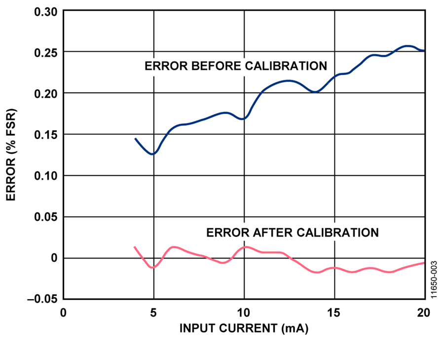

Test data before and after two-point calibration
To perform a two-point calibration, first apply 4 mA to the input and record the ADC output code as Code_1. Then, apply a current of 20 mA to the input terminal, and record the ADC output code as Code_2. The gain coefficient is calculated by:
CN0336_Image8
Now, the input current corresponding to any output code Code_x can be calculated by:
CN0336_Image9
The pre-calibration error is obtained by comparing the ideal transfer function calculated using the nominal values ​​of the components with the uncalibrated actual circuit transfer function. The tolerance of the resistors used in the actual measured circuit is ±1%. Test results do not include temperature changes.
Figure 3 shows the percent error (FSR) test results before and after calibration at ambient temperature. As shown in the figure, the maximum error before calibration is approximately 0.25% FSR. After calibration, the error is reduced to ±0.02% FSR, which is roughly equivalent to the 1 LSB error of the ADC.
Figure 3. Circuit test error before and after room temperature calibration
