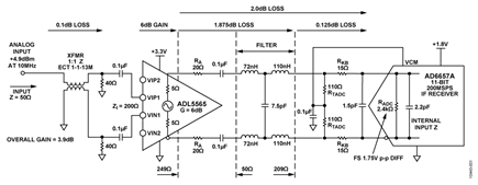

The circuit shown in Figure 1 is a 65 MHz bandwidth receiver front end based on the ADL5565 ultra-high dynamic range differential amplifier driver and the AD6657A 11-bit, 200 MSPS quad IF receiver .
Fourth-order Butterworth anti-aliasing filters are optimized based on the performance and interface requirements of the amplifier and IF receiver. The total insertion loss caused by the filter network and other resistive components is only 2.0 dB. The overall circuit bandwidth is 65 MHz, and the low-pass filter has a 1 dB bandwidth at 190 MHz and a 3 dB bandwidth at 210 MHz. Passband flatness is 1dB.
This circuit is optimized for processing 65 MHz bandwidth IF signals centered at 140 MHz and sampled at 184.32 MSPS. The measured SNR and SFDR using a 140 MHz analog input in the 65 MHz band were 70.1 dBFS and 80.9 dBc, respectively.
Figure 1: Gain, loss and signal level measured at 10 MHz for a single channel (schematic diagram: all connections and decoupling not shown) of a four-channel IF receiver front-end
Circuit description
The circuit shown in Figure 1 accepts a single-ended input and converts it to a differential signal using a wide-bandwidth (3 GHz) M/A-COM ECT1-1-13M 1:1 transformer. The ADL5565 6.0 GHz differential amplifier has a differential input impedance of 200 Ω when operating at 6 dB gain, 100 Ω when operating at 12 dB gain, and 67 Ω when operating at 15.5 dB gain.
The ADL5565 is an ideal driver for the AD6657A . A low-pass filter enables a fully differential architecture in the ADC, providing good high-frequency common-mode rejection while minimizing second-order distortion products. The ADL5565 provides 6 dB, 12 dB, and 15.5 dB gain depending on the input connection. In this circuit, a 6 dB gain is used to compensate for the insertion loss of the filter network and transformer (approximately 2.1 dB), providing a total signal gain of 4.0 dB. Gain also helps minimize the noise effects of the amplifier.

For optimal performance, the ADL5565 should be loaded with a net differential load of at least 200 Ω. The 20 Ω series resistor isolates the filter capacitor from the amplifier output, resulting in a net load impedance of 249 Ω when the downstream impedance is added.
A 15 Ω resistor in series with the ADC input isolates internal switching transients from the filter and amplifier. The 110 Ω resistor is placed in parallel with the ADC to lower the input impedance of the ADC, making performance more predictable.
The differential input impedance of the AD6657A is approximately 2.4 kΩ in parallel with 2.2 pF. For this type of switched capacitor input ADC, the real and imaginary parts are a function of the input frequency; see application note AN-742 for detailed analysis .

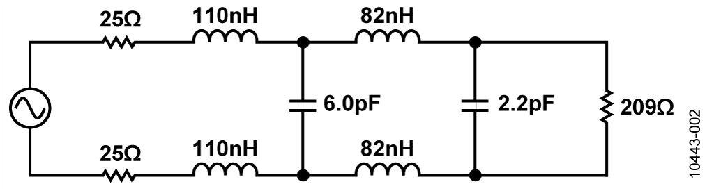

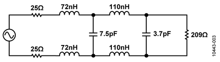

The fourth-order Butterworth filter is designed with a source impedance of 50 Ω, a load impedance of 209 Ω, and a 3 dB bandwidth of 190 MHz. The final circuit values ​​of the filter are shown in Figure 1. The values ​​generated from the filter program are shown in Figure 2. The values ​​chosen for the filter passive components are the closest standard values ​​to the program-generated values. The ADC's internal 2.2 pF capacitor serves as the final shunt capacitor for the filter design.

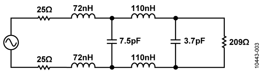

As can be seen from this design, achieving optimal performance can sometimes be an iterative process. The filter programmed values ​​are very close to the final values, but due to some board parasitic capacitance the final filter values ​​are slightly different. Figure 3 shows the final design values ​​of the filter.
Figure 2. Initial design of filter program for fourth-order differential Butterworth filter, ZS = 50 Ω, ZL = 209 Ω, FC = 190
Figure 3. Final design values ​​for fourth-order differential Butterworth filter, ZS = 50 Ω, ZL = 209 Ω, FC = 190 MHz

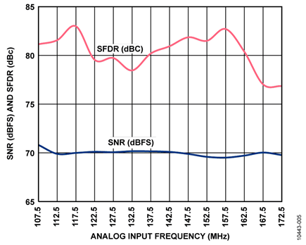

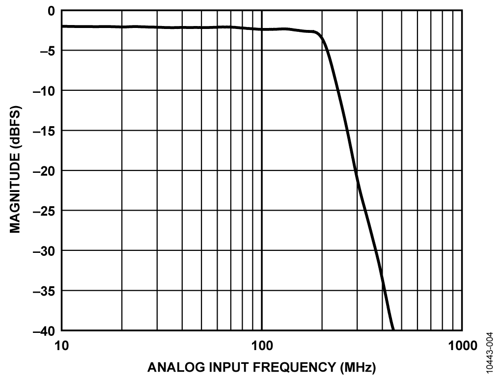

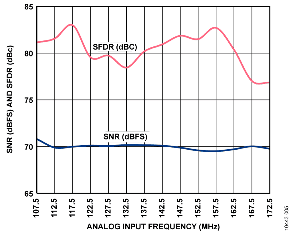

Table 1 summarizes the measured performance of the system with a 3 dB bandwidth of 210 MHz. The total insertion loss of the network is approximately 2 dB. Figure 4 shows the bandwidth response of the final filter circuit, and Figure 5 shows the SNR and SFDR performance.

 SNRFS@140MHz  70.1dBFS
 SFDR@140MHz  80.9 dBc
 H2/H3@140MHz  97.7/80.9 dBc

Figure 4. Passband Flatness Performance vs. Input Frequency

The SFDR performance in this design depends on two factors: amplifier and ADC interface component values, as shown in Figure 1. The final SFDR performance numbers shown in Table 1 and Figure 5 are obtained after optimizing the filter design, taking into account the board parasitic capacitance and non-ideal components used in the filter design.
Another factor that can be weighed in this particular design is the ADC full-scale setting. For the data obtained with this design, the full-scale ADC differential input voltage was set to 1.75 V pp, which optimizes SFDR. Changing the full-scale input range to 2.0 V pp slightly improves SNR, but the SFDR performance is slightly degraded. Changing the full-scale input range in the opposite direction to 1.5 V pp slightly improves SFDR, but SNR performance is slightly degraded.
