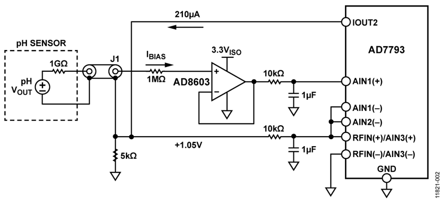

A typical pH probe electrode is made of glass, which creates an extremely high resistance, ranging from 1 MΩ to 1 GΩ, acting as a resistor in series with the pH voltage source, as shown in Figure 2.
Figure 2. pH sensor and buffer interface to ADC (Simplified schematic: all connections, RTDs, and decoupling not shown.)
The buffer amplifier bias current flowing through this series resistor introduces offset errors into the system. To isolate the circuit from this high source resistance, a high input impedance, ultra-low input bias current buffer amplifier is required in this application. The AD8603 is used as a buffer amplifier for this application, as shown in Figure 2. The low input current of the AD8603 minimizes voltage errors caused by bias current flowing through the electrode resistors.
For a pH probe with a series resistance of 1 GΩ at 25°C, the offset error is 0.2 mV (0.0037 pH) for a typical input bias current of 200 fA. Even at a maximum input bias current of 1 pA, the error is only 1 mV.
The cutoff frequency of the 10 kΩ/1 μF low-pass noise filter for the buffer amplifier output is f= 1/2πRC, which is 16 Hz.
Guarding, shielding, high insulation resistance pillars, and other such standard picoamp methods must be utilized to minimize leakage at the high impedance input of the AD8603 buffer.

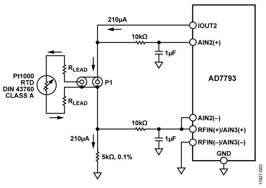

Although 100 Ω Pt RTDs are very common, other resistors (200 Ω, 500 Ω, 1000 Ω, etc.) and materials (nickel, copper, nickel-iron) can be specified. This application uses a 1 kΩ DIN 43760 Class A RTD for temperature compensation of the pH sensor. A 1000 Ω RTD is not as sensitive to line resistance errors as a 100 Ω RTD.
Use a 2-wire connection as shown in Figure 3. Apply a constant current to the RTD pin while measuring the voltage across the RTD itself. The measurement device is an AD7793, which exhibits high input resistance and low input bias current. The sources of error in this scheme are the pin resistance, the stability of the constant current source generated by the AD7793, and the input impedance and/or bias current and corresponding drift in the input amplifier.
Figure 3. 2-wire platinum RTD connections (simplified schematic: all connections and decoupling not shown)
Another possibility to eliminate line resistance errors is a 3-wire RTD configuration, see Current Note CN-0287 for details .

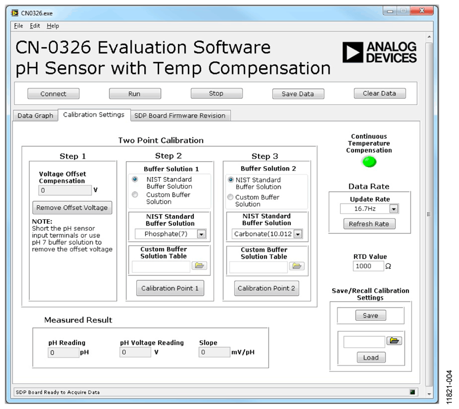

Calibrate the pH meter in the EVAL-CN0326-PMDZ evaluation software using the two-point calibration procedure shown in Figure 4 .
Figure 4. Evaluation software calibration settings window
Users need to use at least two buffer solutions, of which a neutral pH buffer solution with a value of pH-7 is used to eliminate imbalances caused by the pH probe and system. Neutral buffer solutions can be used to set the first calibration point. The pH of the first buffer solution depends on the pH of the solution that needs to be measured. When measuring alkaline base solutions, you can use pH-10 buffer solutions; when measuring acidic solutions, you can use pH-4 buffer solutions. To improve the accuracy of measurements, a three-point calibration can be implemented. The method is to use two different sets of buffer solutions in steps 2 and 3, as shown in Figure 4, where the pH-7 solution is used to eliminate the imbalance.
The software includes a list of NIST recommended buffer solutions. Each buffer solution described in the list has its own temperature coefficient, ranging from 0°C to 95°C, which can be found in the book "pH Theory and Practice" published by Radiometer Analytical. The software uses this table to correlate the mV input from the pH probe to the correct pH value that corresponds to the temperature reading from the RTD sensor, using linear interpolation to fill in the blanks in the table. The user can choose to enable/disable the continuous temperature compensation option by clicking the green button as shown in Figure 4.
Buffer solutions used for pH sensor calibration are common in the market. Other NIST certified pH reference solutions can also be used for calibration. Since there are a variety of buffer solutions on the market to choose from, the software also provides users with an option to calibrate using the required NIST certified pH reference solution, as shown in Figure 4.
The software also provides the user with an option to use other RTD resistor values, but the default value is set to 1000 Ω.

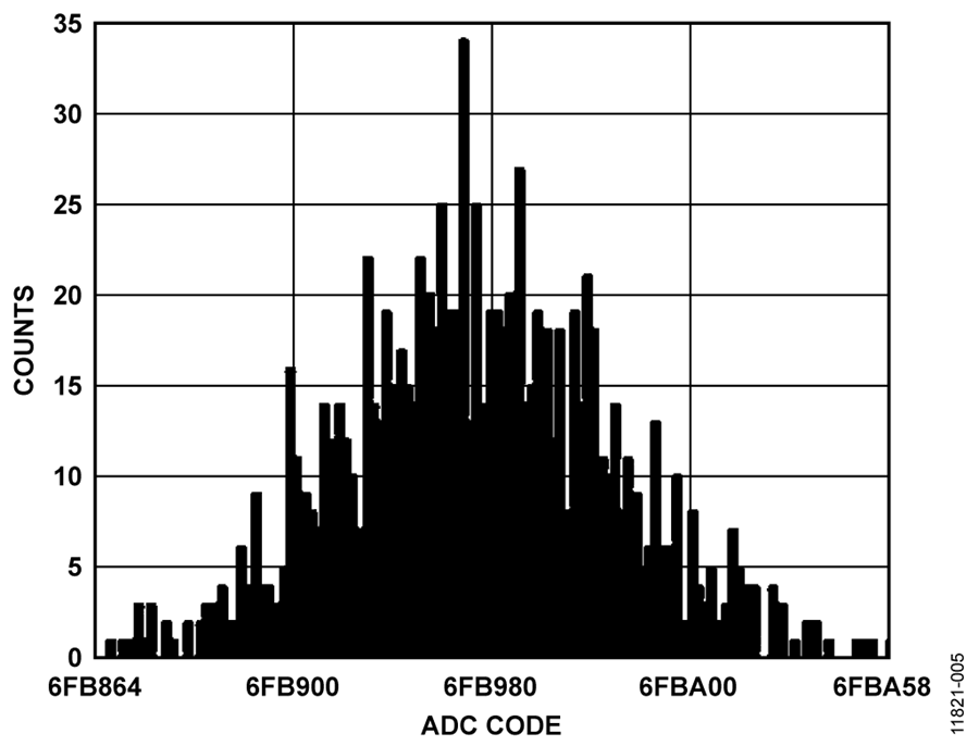

The peak-to-peak noise of the AD8603 buffer and AD7793 in a real system is determined by shorting the pH probe BNC connector and taking 1000 samples. As shown in the histogram in Figure 5, the code distribution is approximately 500 codes, which equates to a peak-to-peak noise of 31.3 μV and an equivalent pH reading distribution of 0.00053 pH peak-to-peak.
Figure 5. Output code distribution histogram (AD7793 input pins shorted together)

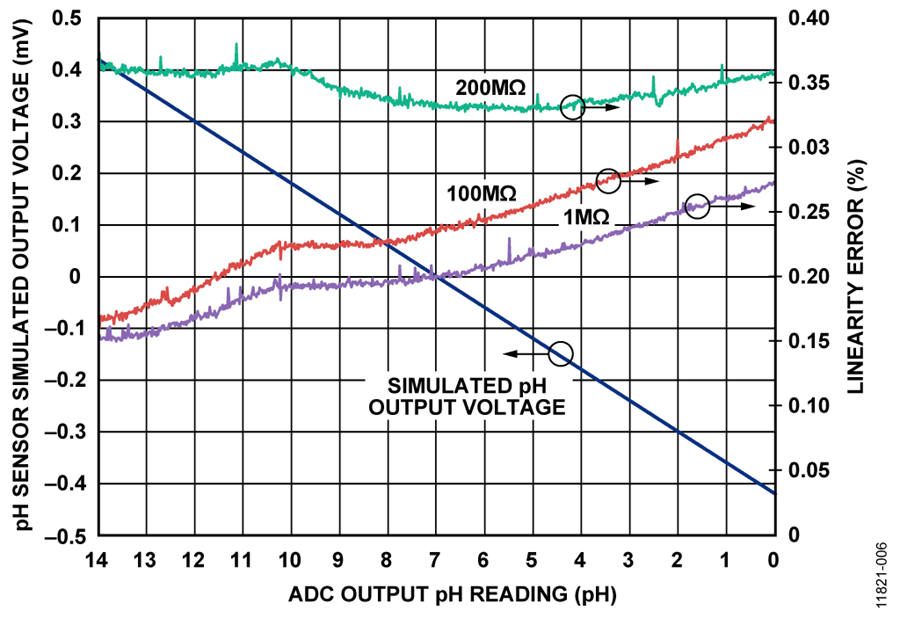

When testing the system, three different resistors were connected in series with the ADC input to simulate the different impedances of the high-impedance glass electrodes. The system was also calibrated and the result was 60 mV/pH. According to Figure 6, the linear error increases as the impedance of the simulated glass electrode increases. Figure 6 also shows that for a pH probe impedance of 200 MΩ, the linearity error is less than 0.5% over the entire simulated pH output voltage range.
Figure 6. pH sensor simulated output voltage (and associated linear error plot) versus ADC output pH reading (probe resistances shown are 1 MΩ, 100 MΩ, and 200 MΩ).

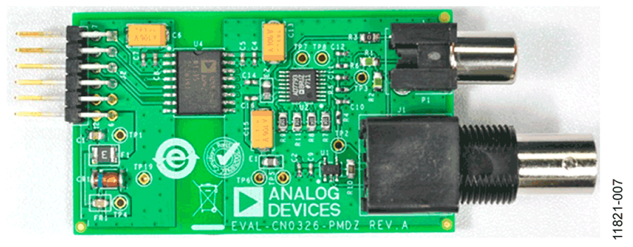

Test data was collected using the evaluation board shown in Figure 7. Complete documentation for this system can be found in the CN-0326 Design Support Package .
Figure 7. Photo of EVAL-CN0326-PMDZ board
