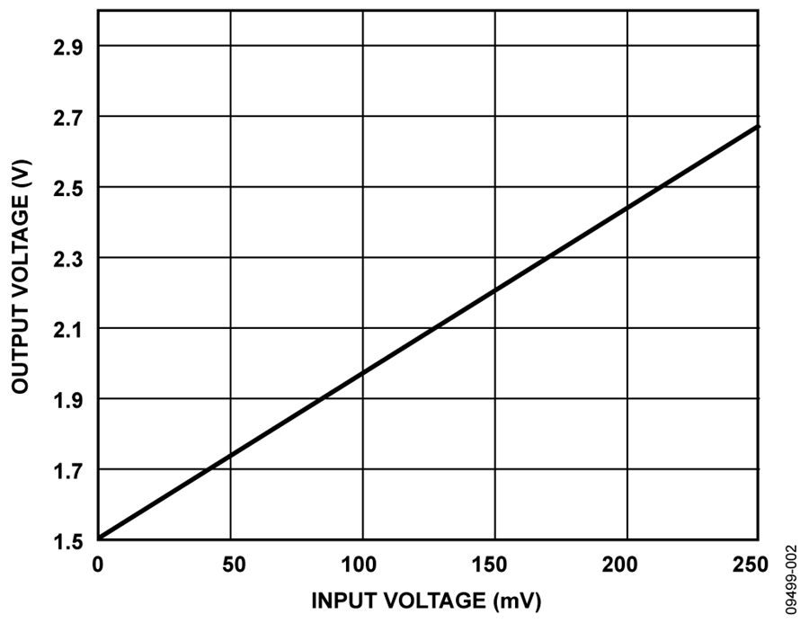

By measurement, the measured offset is 1.641497 V and the gain is 5.165. The DC transfer function of the system is shown in Figure 2. The measured linearity is 0.0465%.
Figure 2. System DC transfer function

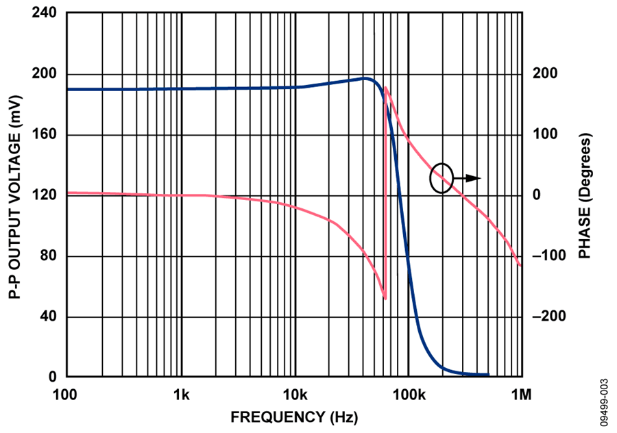

Figure 3 shows the output voltage versus input frequency without DC offset voltage. The input signal voltage is 40 mV pp, which produces an output signal of 40 × 5.165 = 207 mV pp. Note that there is about 10 mV peaking in the frequency response function, which is equivalent to about 0.42 dB.
The system has good noise performance, with noise densities of 2.50 μV/√Hz at 1 kHz and 1.52 μV/√Hz at 10 kHz.
