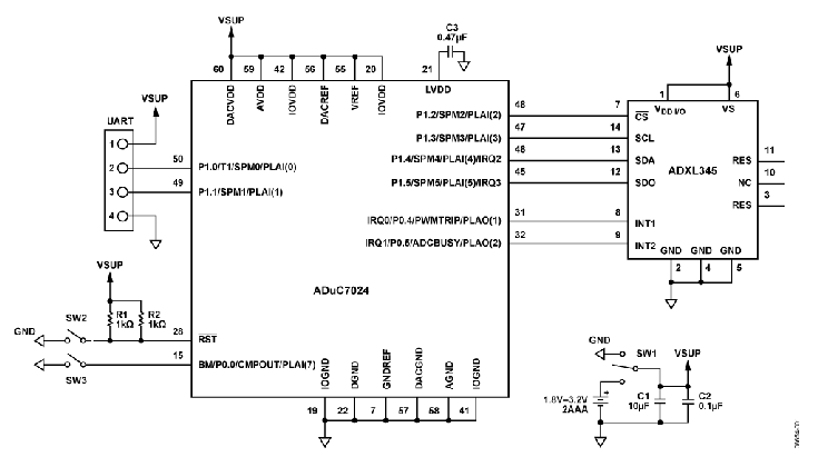

Figure 1. 4-wire SPI configuration for ADXL345 and ADuC7024 (schematic diagram, decoupling and all connections not shown)

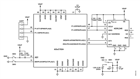

Figure 2. I 2 C configuration for ADXL345 and ADuC7024 (schematic diagram, decoupling and all connections not shown)

This circuit uses the ADuC7024 precision analog microcontroller with the ADXL345 digital accelerometer. Both devices support I 2 C and SPI interfaces. Figure 1 shows the SPI configuration of the ADXL345 and ADuC7024, and Figure 2 shows the I 2 C configuration of these devices. The CS pin (pin 7 of the ADXL345) is used to select the desired interface. If the CS pin is tied high (V DD I/O ), I 2 C mode is enabled. In SPI mode, the CS level switches at the beginning and end of each transfer. If CS is pulled high, it indicates that no SPI transfer is occurring, or that an I 2 C transfer may occur.
The schematics shown are schematic but show the necessary connections (power, ground, etc.). In these schematics, the ADuC7024 is programmed via the UART (connected to pin 49 and pin 50). SW2 and SW3 are reset and download buttons respectively, used for microcontroller programming. SW1 is the power switch.
For information on programming the ADuC7024, please refer to the ADuC7024 data sheet . For sample code for I2C configuration, please visit: http://www.analog.com/static/imported-files/circuit_notes/CN0133_Source_Code.zip.
