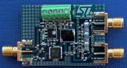

STEVAL-TDR003V1
The STEVAL-TDR003V1 is a 2-stage RF power amplifier including output low-pass filter (LPF) for harmonics rejection, specifically designed for portable two-way VHF radio communication.
Main features
  • BeO free amplifier
  • VAPC 5 V max
  • RoHS compliant
  • Harmonics level < -70 dBc
  • Input power < 10 dBm
  • Excellent thermal stability
  • Supply voltage: 7.2 V
  • Frequency: 135 - 175 MHz
  • Current < 1.5 A
  • Load mismatch 20:1
  • Output power: 5 W
