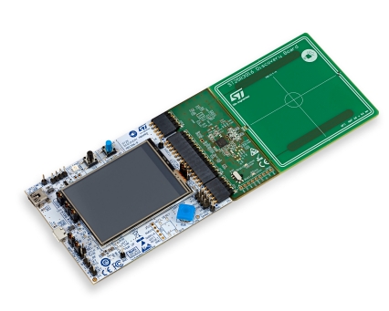

The ST25R3916-DISCO kit allows the user to evaluate the features and capabilities of the ST25R devices, a series of high performance HF readers.
The ST25R3916-DISCO kit comes with application notes, software applications, drivers, BOM (bill of materials), board schematics, Gerber files and firmware schematics. These documents are downloadable from www.st.com.
Main features
  • ISO 18092 (NFCIP-1) active and passive initiator and target modes
  • NFC Forum NFC-A, NFC-B, NFC-F and NFC-V reader
  • ISO 14443A, ISO 14443B and ISO15693 reader
  • FeliCa™ reader
  • Support of all five NFC Forum tag types in reader mode
  • NFC Forum Type 3 tag (NFC-F) host card emulation
  • NFC Forum Type 4A tag (NFC-A) host card emulation
  • Stream modes to implement other standard and custom protocols
  • Integrated capacitive sensing system for low power detection of tag presence
  • Integrated inductive sensing system for low power detection of tag presence using phase or amplitude measurement
  • High output power
  • User selectable and automatic gain control
  • Serial peripheral interface (SPI) up to 10 Mb/s
  • I2C with up to 400 kbit/s in Fast-mode, 1 Mb/s in Fast-mode Plus
  • Automatic antenna tuning (AAT) via variable capacitor
