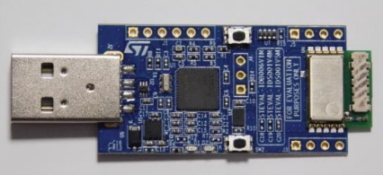

868 MHz RF USB dongle based on SPIRIT1 SPSGRF-868 module
STEVAL-IDS001V4M
The STEVAL-IDS001V4M evaluation board is based on the SPSGRF-868 CE certified RF module with the SPIRIT1 low-power Sub 1GHz transceiver and embeds the STM32L151CBU6A ultra low-power ARM Cortex-M3 MCU.
The SPSGRF-868 module integrates the BALF-SPI-01D3 match balun and a chip antenna, and operates in the 868 MHz ISM band.
The STEVAL-IDS001V4M evaluation board features a USB connector for PC-GUI interaction and firmware updates, and an SWD connector for specific firmware development.
Main features
  • Based on SPSGRF-868 module which features:
    • low data rate, low-power, sub-1GHz SPIRIT1 transceiver
    • integrated balun (BALF-SPI-01D3)
    • chip antenna
  • On-board STM32L151CBU6A ultra low power ARM® Cortex®-M3 microcontroller
  • Modulation schemes: 2-FSK, GFSK, MSK, GMSK, OOK and ASK
  • Air data rate: from 1 to 500 kbps
  • Fully compliant with the SPIRIT1 development kit firmware and GUI
  • Debug connector
  • USB interface
