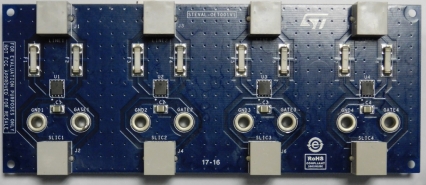

The STEVAL-OET001V1 board is designed to validate lightning protection for SLIC transceivers. The maximum peak pulse current for different waveform is given in the LCP154DJF datasheet.
The STEVAL-OET001V1 is able to protect 4 lines; several boards can be used if the number of lines is higher.
The STEVAL-OET001V1 board specifications comply with ITU-T K20/21/45 and GR1089-Core associated with Cooper Bussmann Telecom Circuit Protector fuse TCP 1.25 A.
Main features
  • 4 line protection for SLIC transceivers
  • Compliant with ITU-T K20/21/45 and GR1089-Core
  • Programmable transient suppressor
  • RoHS compliant
