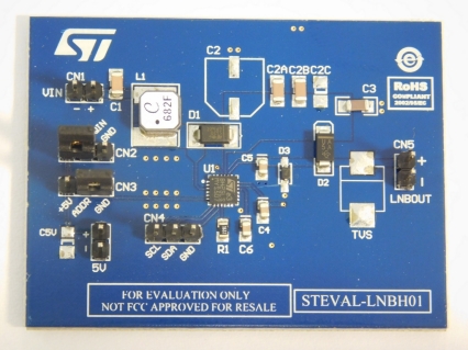

LNB power supply evaluation board based on LNBH25LS
STEVAL-LNBH01
This evaluation board implements a DC-DC converter based on the LNBH25LS device. It is used to power LNBs inside dish antennas to receive satellite TV signals.
The LNBH25LS is an integrated solution for supplying / interfacing satellite LNB modules in accordance with international standards. This simple solution offers a complete solution for dual tuner satellite receivers and offers high performance at low cost with a low external component count.
The LNBH25LS evaluation board includes an I²C bus interface and the internal 22 kHz tone generator which is factory trimmed and can be controlled by the DSQIN pin (TTL compatible), allowing immediate DiSEqC™ data encoding.
Thanks to a fully integrated step-up DC-DC converter, it functions with a single input voltage supply source ranging from 8 V to 16 V.
Main features
  • Complete interface between LNB and I²C bus
  • Built-in DC-DC converter for single 12 V supply operation and high efficiency (typ. 93% at 0.5 A)
  • Selectable output current limit by external resistor
  • Compliant with output voltage specifications for principal satellite receivers (15 programmable levels)
  • Accurate built-in 22 kHz tone generator suits widely accepted standards
  • 22 kHz tone waveform integrity guaranteed even at no load condition
  • Low drop post regulator and high efficiency step-up PWM with integrated power N-MOS for low power losses
  • LPM function (low power mode) to reduce dissipation
  • Overload and overtemperature internal protection with I²C diagnostic bits
  • LNB short-circuit dynamic protection
  • ±4 kV ESD tolerant on output power pins
  • RoHS compliant
