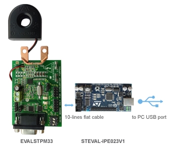

Single-phase anti-theft electricity detection and measurement demonstration board with CT and shunt based on STPM33
EVALSTPM33
The STPM33 energy metering evaluation board is a class 0.2, single-phase meter which includes tamper monitoring, CT and shunt current sensors for power line systems with Vnom= 140 to 300 V(RMS), Inom/ Imax= 5/100 A(RMS), flin= 50/60 Hz ± 10% and Tamb= -40 to +85 °C.
Measured active/reactive power can be output from two programmable LEDs on the board.
The board can be interfaced with a PC running evaluation software through an isolated RS232 port, or through the STEVAL-IPE023V1 USB isolated interface tool for configuration and data reading.
The board also has SPI/UART pins available to interface a microcontroller for application development.
Main features
  • 0.2% accuracy single-phase meter with tamper monitoring
  • V nom(RMS) = 140 to 300 V, I nom /I max(RMS) = 5/100 A, f lin = 50/60 Hz ± 10%
  • Tamper detection though neutral current monitoring
  • Connector for USB isolated hardware programmer tool STEVAL-IPE023V1 and PC GUI
  • RS232 and UART isolated connectors to PC GUI
  • SPI/UART switch for device peripheral selection
  • 2 programmable LEDs on board
  • Digital expansion to external system-on-chip or MCU
  • 3.3 V power supply: external or through STEVAL-IPE023V1 isolated USB board
  • IEC61000 standard compliant
  • RoHS compliant
