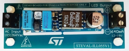

High efficiency isolated offline LED driver with 11 W fixed output and high PF based on HVLED815PF (EU input range)
STEVAL-ILL055V1
The STEVAL-ILL055V1 is an isolated SMPS designed in high power factor flyback topology. It generates a 640 mA nominal output current, delivering up to 11 W of output power and provides a cost-effective and space-saving solution. This product evaluation board is based on the HVLED815PF, a monolithic converter integrating both an 800 V avalanche-rugged MOSFET and PWM controller in a single package.
Main features
  • Input:
    • Voltage: 185 – 264 Vac
    • Frequency: 45 – 55 Hz
  • Output:
    • Current: 640 mA
    • Voltage: 6 LED module (blue or white)
  • Power factor
    • > 0.9
  • Efficiency
    • 84%
  • PCB type and size:
    • FR4
    • Double layer
    • Copper thickness: 35 µm
    • LED driver size: 17 x 55 mm
    • Board size: 34 x 88 mm
  • Isolation
    • Isolated 2 kV / 4 mm isolation gap
  • I
    • According to EN55022 Class B
