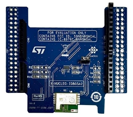

Bluetooth low energy expansion board based on BlueNRG-M0 module for STM32 Nucleo
X-NUCLEO-IDB05A2
The X-NUCLEO-IDB05A2 Bluetooth low energy expansion board is based on the BlueNRG-M0 BLE network processor module.
The BlueNRG-M0 is Bluetooth v4.2 compliant, FCC and IC certified (FCC ID: S9NBNRGM0AL; IC: 8976C-BNRGM0AL). It supports simultaneous master/slave roles and can behave as a Bluetooth low energy sensor and hub device at the same time.
The BlueNRG-M0 provides a complete RF platform in a tiny form factor, with integrated radio, antenna, high frequency and LPO oscillators.
The X-NUCLEO-IDB05A2 is compatible with the ST morpho (not mounted) and Arduino UNO R3 connector layout.
The X-NUCLEO-IDB05A2 interfaces with the STM32 microcontroller via the SPI pin and allows changing the default SPI clock, SPI chip select and SPI IRQ by replacing a resistor on the expansion board.
Main features
  • STM32 Nucleo expansion board based on the BlueNRG-M0 Bluetooth v4.2 compliant, FCC and IC certified module (FCC ID: S9NBNRGM0AL; IC: 8976C-BNRGM0AL)
  • BlueNRG-M0 main features:
    • Embedded Bluetooth low energy protocol stack (GAP, GATT, SM, L2CAP, LL, RFPHY)
    • Embedded BlueNRG-MS network processor
    • On-board chip antenna
  • Small form factor: 11.5 mmx13.5 mm
  • Equipped with Arduino UNO R3 connector
  • Scalable solution capable of cascading multiple boards for larger systems
  • Free comprehensive development firmware library and samples for BlueNRG-MS, compatible with STM32Cube firmware
  • RoHS compliant
