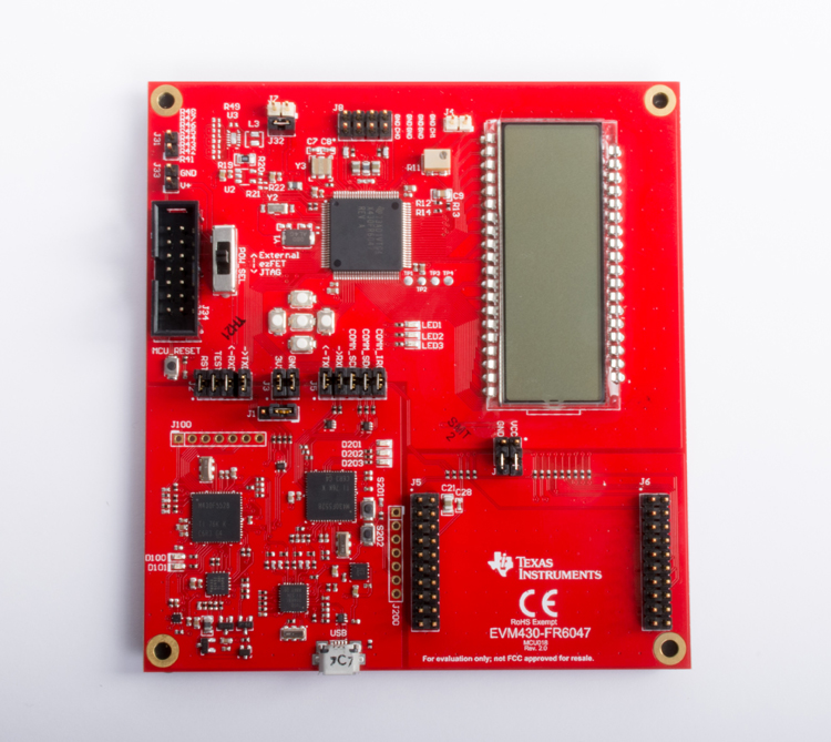

This reference design helps designers develop an ultrasonic water-metering subsystem using an integrated, ultrasonic sensing solution (USS) module, which provides superior metrology performance with low-power consumption and maximum integration. The design is based on the 256KB MSP430FR6047 microcontroller (MCU), with integrated high-speed, ADC-based, signal acquisition and an integrated low energy accelerator (LEA) to optimize digital signal processing.
characteristic
  • ● Best-in-class metrology performance: 25-ps zero-flow drift (ZFD) and 32-ps single-shot standard deviation
  • ● Low-power consumption: Approximately 2.5 μA with 1-MHz transducer at 1 measurement per second for metrology
  • ● Flexibility to test different pipes and transducers; direct interface to pair of transducers
  • ● Easy to test and customize using Ultrasonic Sensing Design Center graphical user interface (GUI)
  • ● Ultrasonic sensing software library includes time of flight (ToF) algorithms
  • ● Standalone demo using liquid-crystal display (LCD)
