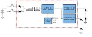

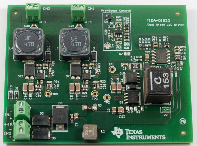

The TIDA-01520 two-stage reference design drives two LED strings in automotive headlight applications and automatically adjusts the pre-boost voltage without the need for a microcontroller (MCU), saving space and cost. In addition, the design's adaptive pre-boost control feature reduces switching losses and maximizes system efficiency for automotive headlights.
characteristic
  • ● Automatically adjust the pre-boost voltage according to light string length and temperature changes
  • ● Maximum LED string length per channel: 14 LEDs
  • ● Passed CISPR 25 test
  • ●Support dynamic input voltage
  • ●Support dynamic load (matrix/dimming)
